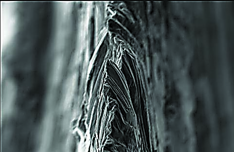

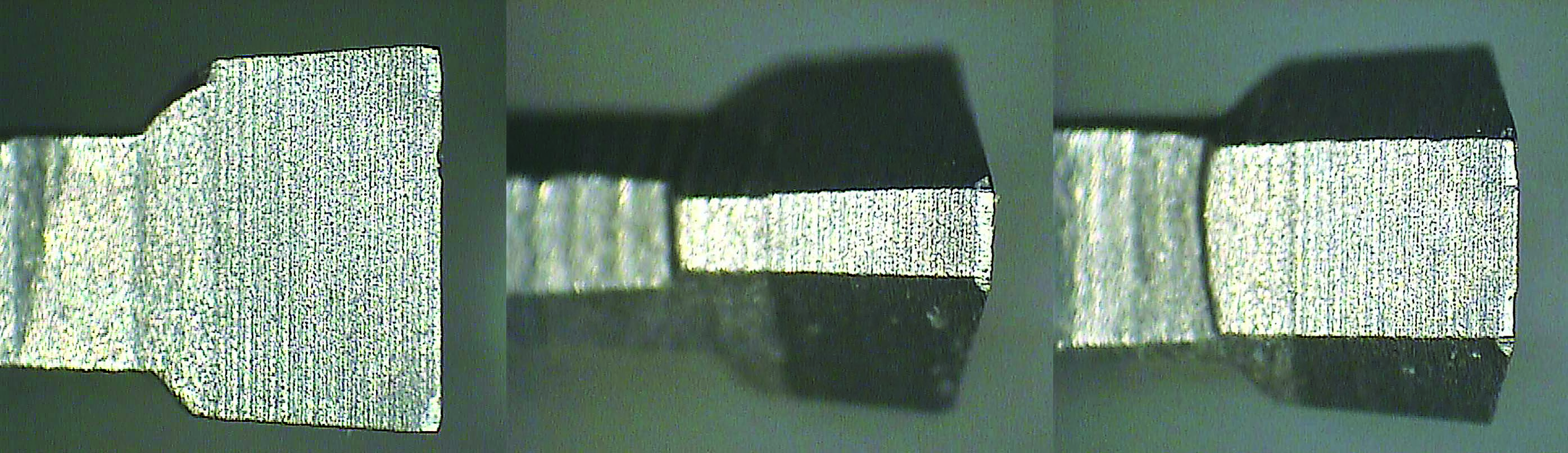

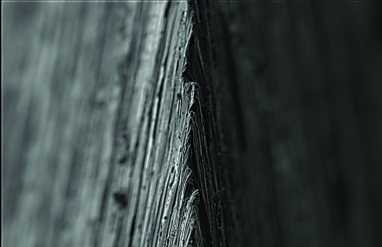

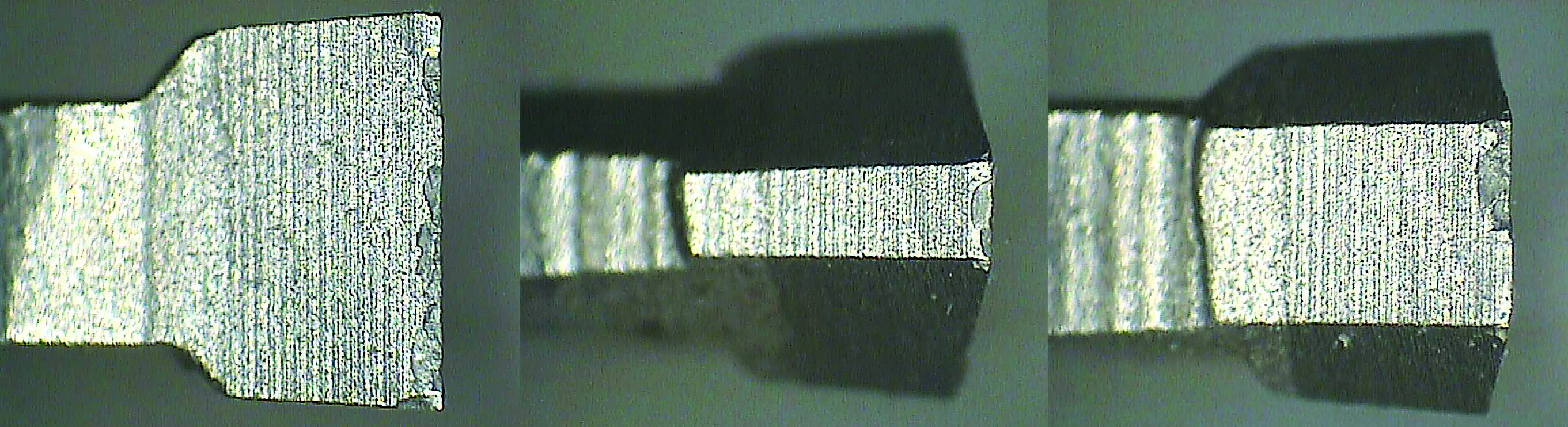

Saws themselves shouldn’t need to be broken in, but blades do. Breaking in a bandsaw blade essentially means honing each tooth to form a microfine radius. This smoothing removes microscopic rough edges, which could rip off and cause tiny imperfections at the tip of each tooth as a result.
Instead of breaking a saw blade, break it in
Teeth on new bandsaw blades have very sharp edges, which easily can be chipped unevenly or destroyed if run at full speed with full feed pressure on the initial cuts and not broken in properly. Image courtesy of L.S. Starrett
A new saw blade is comparable to a newly sharpened pencil point.
“When you first remove the pencil from the sharpener, it will take only the slightest amount of pressure to inadvertently break that point right off at the tip,” said Richard Klipp, president of Morgantown, Pennsylvania-based Behringer Saws Inc. “However, after a few minutes of writing, the point becomes less sharp and ultimately less susceptible to breakage.”
He said the same holds true for a saw blade. Right out of the box, a saw blade tip is very sharp and more susceptible to damage, such as a broken tooth, than after being used for a short period. Blade suppliers therefore often recommend running at a reduced down feed rate—usually 20% to 50% of the suggested rate—until tips are broken in. Afterward, the feed can be set at the recommended rate.
This process allows a blade to travel through the guides and become aligned correctly for cutting. Also, this increases the temperature of the blade, which permits imperfections in the material to bend instead of breaking blade teeth. The warming—followed by natural, inherent cooling—helps strengthen the blade substrate.
These images show a saw blade before and after the break-in process. The rough edges in the top image are realigned in the bottom image. Images courtesy of Kaast Machine Tools
