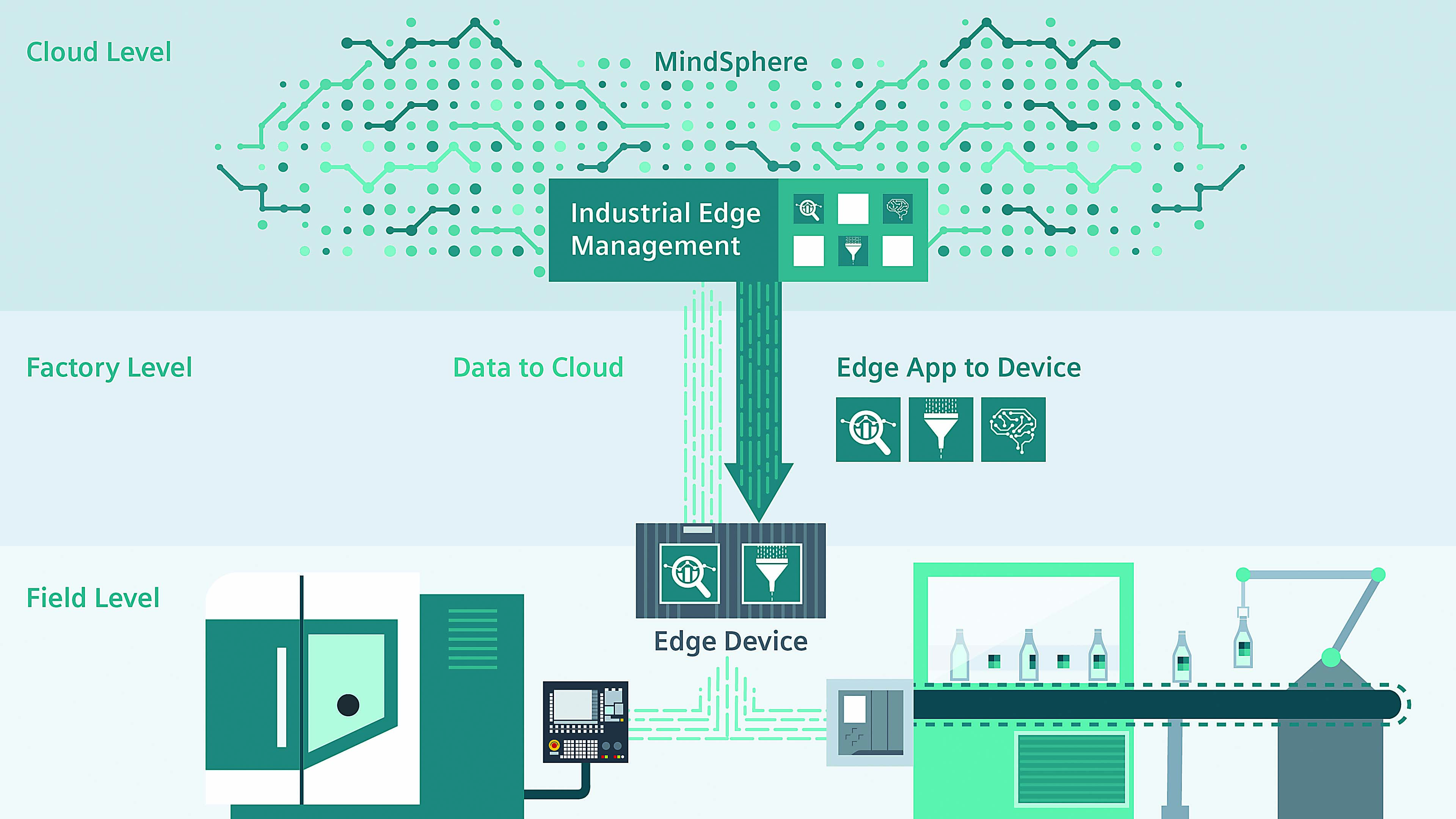

In edge computing systems, data processing is performed chiefly on the periphery rather than in the cloud, where Siemens’ MindSphere internet of things operating system functions. Image courtesy of Siemens

These factors support the move toward edge computing, in which plant equipment analyzes most of its own data in real time. In many cases, “it makes a lot more sense to do the processing and analytics locally than sending it all up to the cloud,” said John Crupi, vice president of edge analytics at Greenwave Systems Inc., Irvine, California, a provider of edge analytics technology.
According to Skubacz, some companies think edge computing simply involves connecting an industry PC to a machine, but there’s more to it than that. “I understand edge computing to be an integrated system allowing us to run different applications very close to production. At the same time, it’s connected to some sort of system normally in the cloud that enables management of applications, remote updates” and other functions initiated away from the plant floor.
The edge does what Crupi describes as the first stage of processing. “Say you had a pattern detector that triggers an alert if there’s a rapid rise in (equipment) temperature,” he said. “You can handle that locally by going into the control and changing some parameters or notifying some other system on the plant floor.”

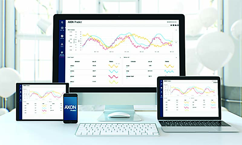

Axon Predict is an analytics platform that can be used in edge computing systems. Image courtesy of Greenwave Systems
The cloud, meanwhile, handles the second stage of processing, which Crupi calls aggregate analytics. For example, he said, “If you want to compare the average temperature of every red machine in a plant to red machines located everywhere in the world, each red machine at the edge computes its average temperature, sends that result to the cloud, and then the cloud sends down the average of all the machines to the edge” so the comparison can be made.
The cloud can also serve as a repository for historical data. For instance, Crupi said, the cloud can store several weeks of data that will allow calculations to determine whether machine speeds are within certain limits at a specified temperature.

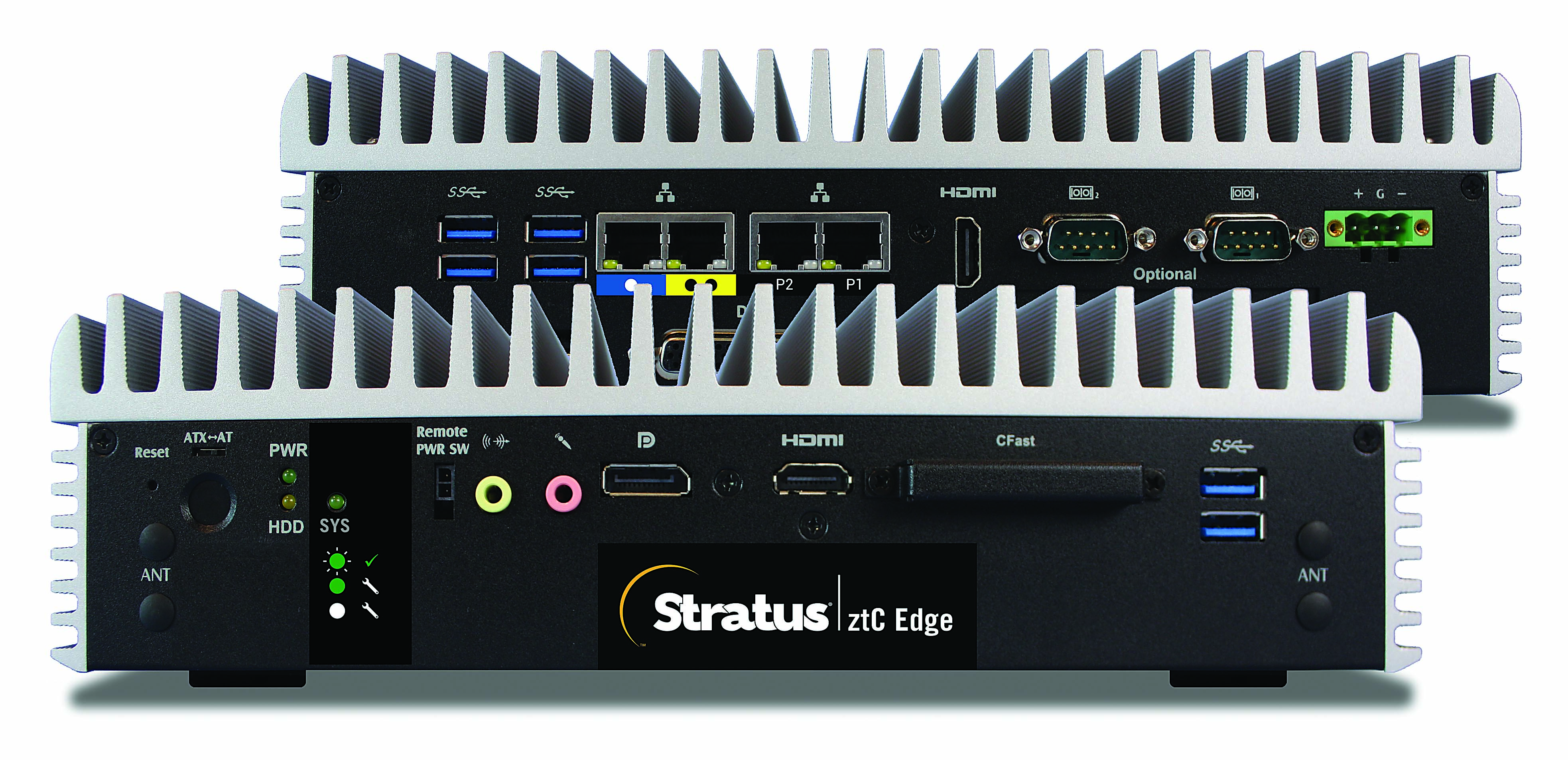

While edge computing can be done at the machine, it may not be cost-effective to put that capability into a relatively simple machine, said John Fryer, senior director of industry solutions at Maynard, Massachusetts-based Stratus Technologies Inc., which sells an industrial edge computing platform. “But if you’ve got 10 of those machines on a production line, you can put in an edge computing system that collects all the information from the machines and runs in a centralized location.” That location could be on the plant floor or in a control room connected to the production line.
In today’s edge computing setups, data from machines is typically sent to a gateway for analysis, according to Crupi. A gateway is a small industrialized computer that is located in the plant and connects to the machines on the plant floor (either wirelessly or via plug-in connections) and the cloud.
Unlike many older gateways that were just “pass-throughs” to the cloud, the latest gateways “are pretty powerful and can run software,” Crupi said. “So industrial customers started to see that they could do processing. And these gateways are becoming so (inexpensive) that it makes a lot more sense to use them to accumulate and analyze the data than it would be to put analytics on the machines.”

Stratus ztC Edge is a computing platform for industrial edge environments. Image courtesy of Stratus Technologies
