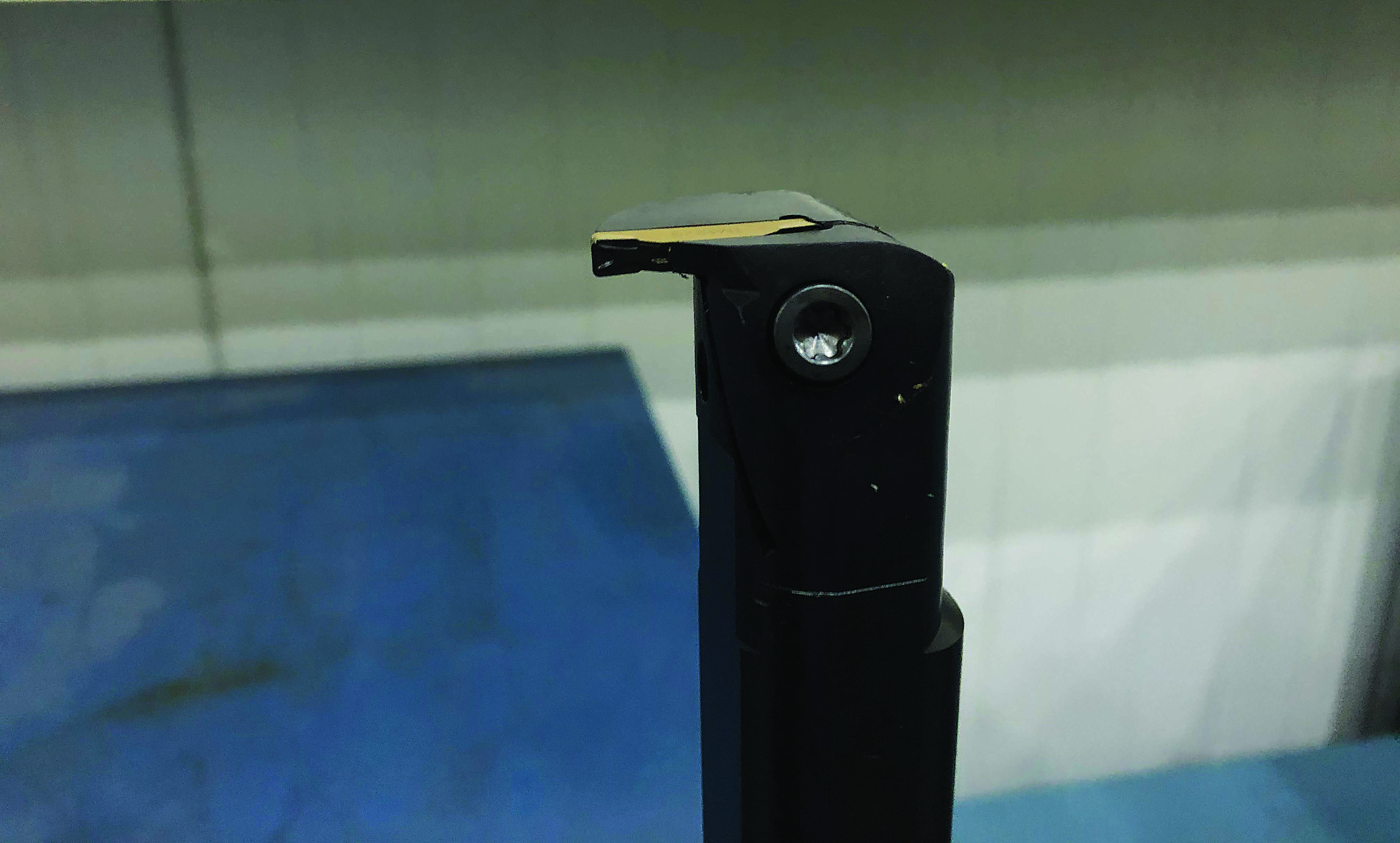

Used for internal grooves, this standard lathe grooving tool (right) is from a catalog. Mitsubishi Hitachi Power Systems Americas has used the tool in milling machines for hot jobs. Image courtesy of C. Tate
Lesson one. Buy a good grooving tool from a company that knows what it is doing. For manual machines, that frequently means purchasing a parting blade. Parting blades are made of high-speed steel and ground with proper clearances, so a tool does not rub the sides, which is the most common problem with hand-ground tools. Parting blades are available in many sizes and can be modified easily for special purposes.
Unfortunately, HSS tools do not always work well with hard or abrasive materials, which I discovered while machining cast-iron parts. Carbide grooving tools become a necessity with difficult-to-machine materials and bring their own challenges, especially on conventional machines. Carbide is significantly harder and more wear-resistant than HSS but very brittle and not as forgiving. Carbide tends to chip and break if not used properly. I learned this while feeding a carbide grooving tool by hand on cast-iron parts. That is lesson two.
