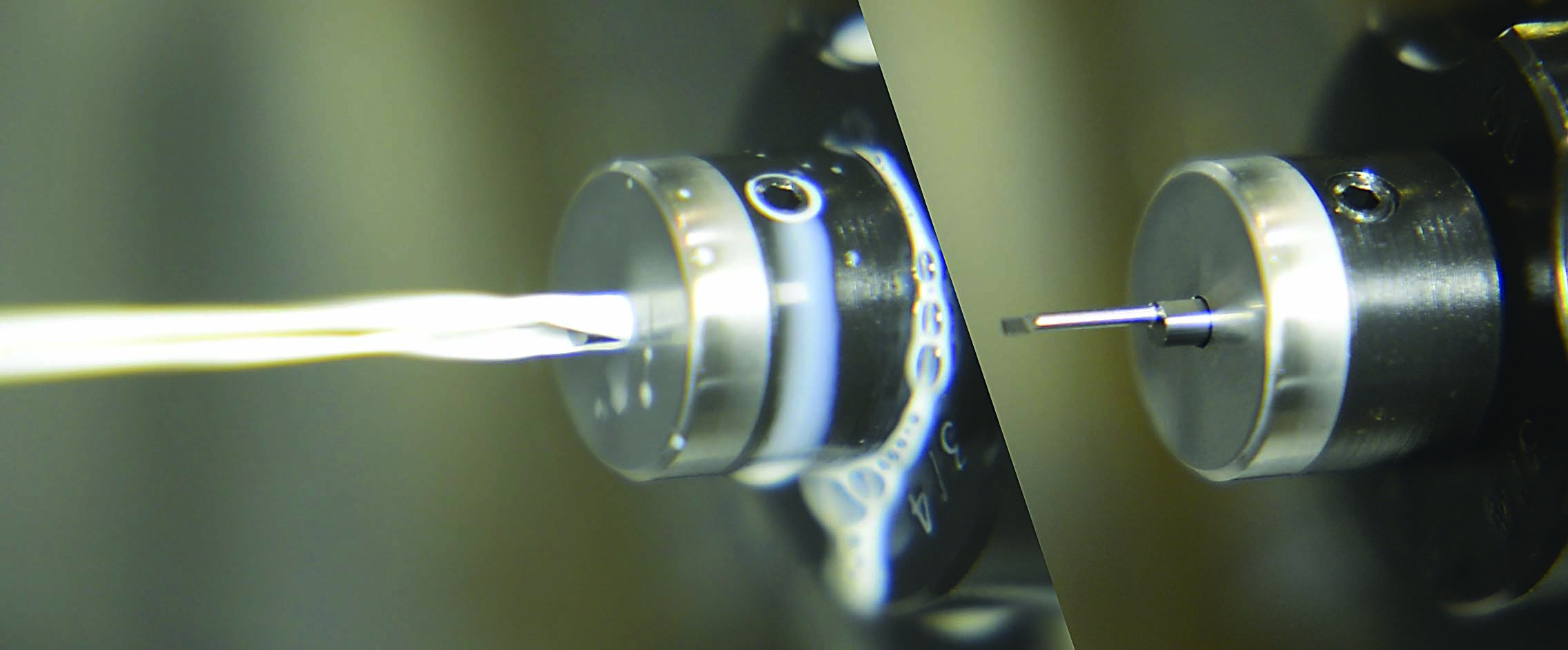

Effective chip removal is particularly important during internal grooving operations.
“If you can’t get the chips out of the bore,” White said, “usually you will re-cut them, and then they will scar the surface.”
Moreover, when a lot of chips accumulate, he said they can wrap around a tool and break it.
Chip problems like these can be prevented by improved coolant delivery, which is possible today thanks to several developments. One is the increased coolant pressures produced by current machines. White said these pressures typically range from 300 psi all the way up to 1,000 psi.
“That is a great advancement specifically for grooving,” he said.

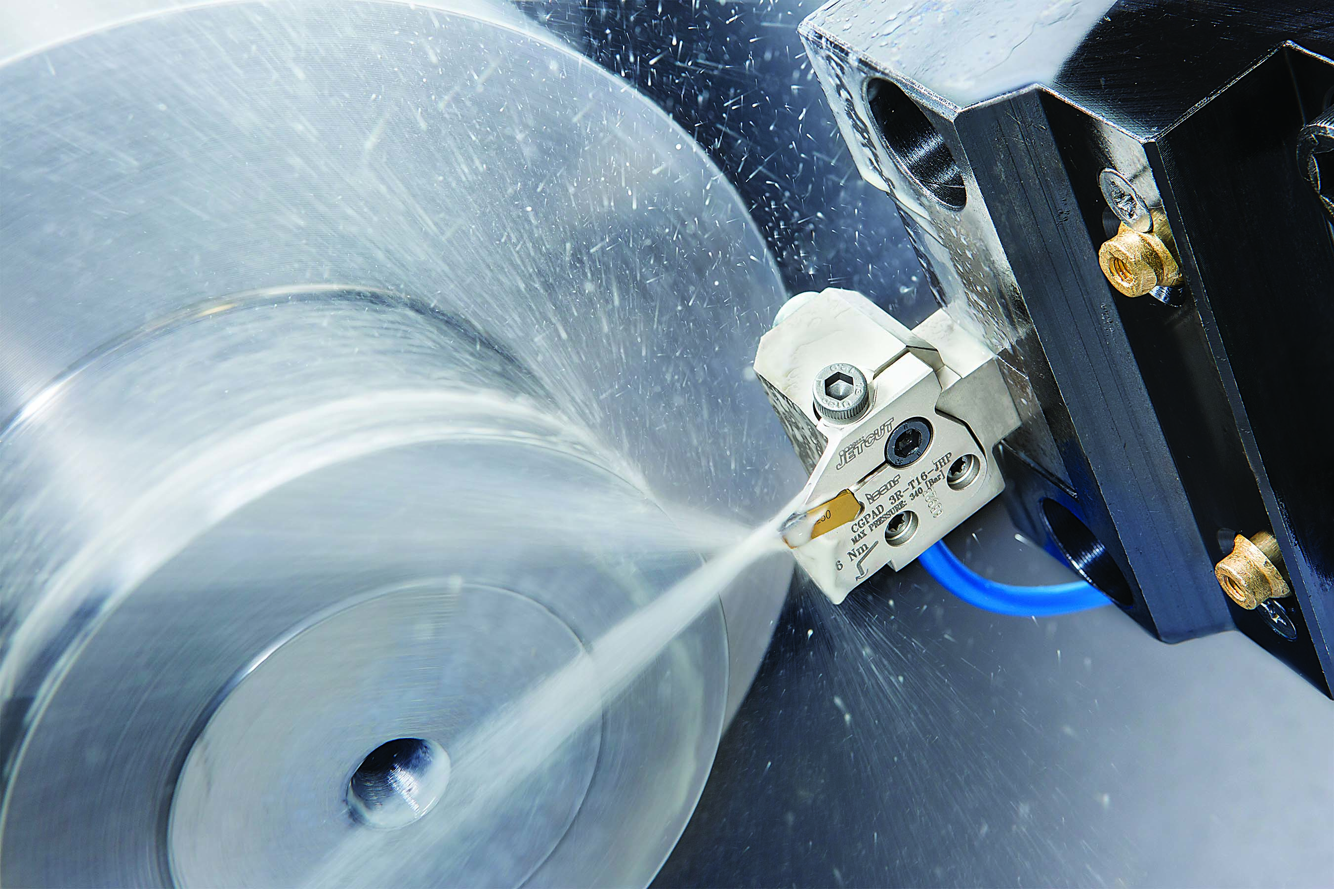

Another is the variety of coolant-through tooling options available. As the name suggests, this type of tooling features internal passages for coolant flow. White said many different toolholders feature coolant-through designs that get coolant right to the cutting edge to lessen thermal degradation of the substrate.
Lisker said coolant-through technology is especially helpful when cutting nickel-base alloys like Inconel that transfer heat back to the tooling. Besides maintaining thermal stability on the cutting edge, he said coolant-through systems disperse chips to help with chip control.
Mikron works with customers to produce the best solid-carbide grooving tools for applications. Image courtesy of Mikron
“If (the tool) is going on a lathe, our message is to use coolant-through tooling as a first choice,” said East, whose company offers tooling products of this type called Jet-Cut.
When customers ask why they should pay more for Jet-Cut holders, he points out that coolant pinpointed on the cutting edge increases tool life, which translates into more parts per edge. He notes as well that efficiently delivered coolant quenches chips and makes them brittle, so they break up more easily.
