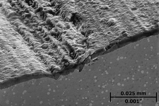

Figure 3: A coated HSS tool after sectioning. As coatings become more sophisticated, the requirements for the substrate’s surface finish below the coating are becoming more stringent. A state-of-the-art coating on a rough surface will quickly flake away. Therefore, companies looking to improve tool performance are investing in more sophisticated finishing techniques to decrease Ra values. The coating on the tool shown was deposited on a poor surface finish. Even if the coated surface was “cleaned up” with a post-coating finishing operation, stress concentrations would be present below the surface, increasing the risk of flaking.

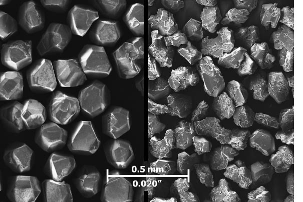

Figure 4: The diamond grits on the left are “blocky.” The diamond grits on the right are “angular.” Blocky grits tend to wear less, impart a finer surface finish and generate more heat. Angular grits attack the workpiece at a more aggressive angle. They tend to fracture more easily, causing more wheel wear but facilitate a more self-sharpening wheel. Angular grits also produce a rougher surface finish and generate less heat. Unfortunately, most superabrasive wheel manufacturers don’t indicate what type of grit is in the wheel.

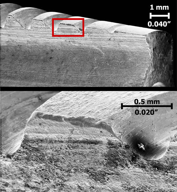

Figure 6: A worn tap (top) and a single tooth from that tap (bottom). The surface finish from thread grinding was poor, but the surface finish from flute grinding was good. There’s some abrasive wear at the corner, but no fracture wear, a consequence of the good surface when flute grinding. As a result, this tap enjoyed a long life.

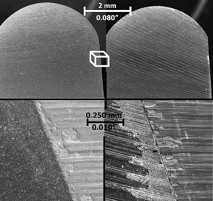

Figure 9: A HSS cutting tap after flute and gun-nose grinding. The gun-nose surface on the left was ground with a 280-mesh aluminum-oxide grinding wheel and the one on the right with a 120-mesh Al203 wheel. There are several other ways to improve surface finish: finer dressing, lower feed rates and faster wheel speeds. All have a negative side effect, such as greater heat generation (leading to longer cycle times) and greater risk of chatter. The best approach is to use a smaller grit, which usually has only one negative side effect: increased wheel wear.

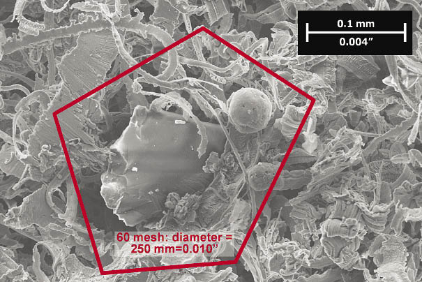

Figure 10: Grinding swarf generated from grinding hardened steel with a 60-grit Al203 wheel. Notice the chunk of Al203 grit contained in the swarf. A 60-grit has a diameter of around 0.250mm (0.010 "), shown in red. The chunk in the swarf is much smaller, meaning the grit fractured during grinding. This wheel contained white Al203, a friable grit that is more prone to fracture than tougher varieties of Al203, such as brown and pink Al203.

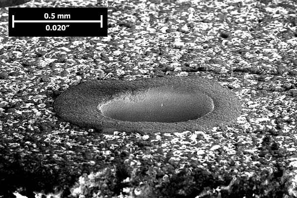

Figure 11: A pore in an induced-porosity diamond wheel for grinding tungsten carbide. The 0.5mm-dia. pore is much larger than the grits in the wheel. The idea is to improve coolant flow in an otherwise nonporous wheel. However, this porosity is noncontiguous, meaning coolant cannot flow from pore to pore. Noncontiguous porosity, especially when it comes in large pores with large spacing between pores, is not as effective as contiguous porosity.
