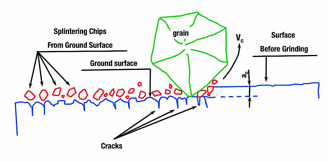

Grinding ceramics is unlike most other grinding operations, wherein a grinding wheel removes material by forming chips—albeit small ones. Grinding these superhard, brittle materials happens via a different mechanism.
“You crack ceramic to death at the surface, and then you clear away that cracked material,” said Jeffrey Badger, aka The Grinding Doc, who’s based in San Antonio. “That’s one unique aspect of grinding it.”
In other words, the mechanism of material removal is one of brittle fracture, not ductile flow. However, he added, the cracks must be very shallow to prevent premature part failure.

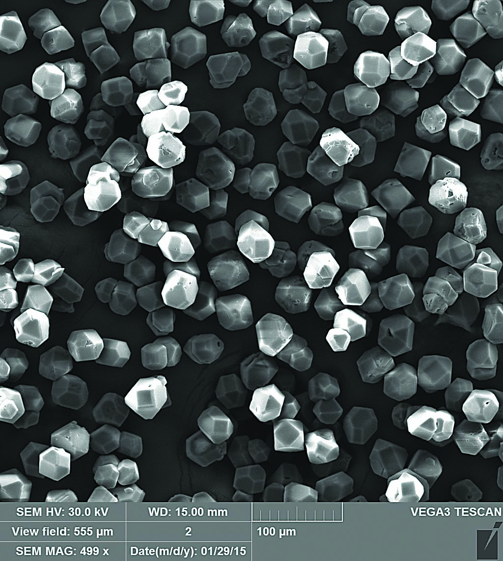

When grinding hard ceramics, the most appropriate diamond crystals have a high level of friability, said David Spelbrink, vice president of Lieber & Solow Co., New York, a supplier of natural industrial diamond stones and a producer and micronizer of diamond powders and grits through the LANDS Superabrasives division. More friable, or “softer,” diamonds have the ability to microfracture and self-sharpen to expose new, sharp cutting edges. “We tend to say that diamond that isn’t very tough is friable.”
Once diamond grits on a grinding wheel initially create small cracks in a ceramic material,
subsequent diamond grits the material. Image courtesy of Jeffrey Badger, aka The Grinding Doc
The more friable a diamond is, the more free cutting it is, enabling a wheel with those types of diamonds to remove material at a relatively quick rate, Spelbrink added.
“Since all grinding is essentially scratching, it’s important to recognize this when it comes to applications where surface finish is crucial,” he said. “A more friable crystal should have a sharper point of contact, which tends to lead to smaller scratches, and, since it’s generally considered softer, it should be move forgiving. There should also be less heat generation, which will be beneficial for surface finish as well.”
The drawback is seen in a grinding wheel with friable diamond crystals, which has a shorter life than a wheel with tougher crystals, according to Spelbrink.
Because chips are likelier to form when grinding silicon nitride than when grinding alumina- and zirconia-based ceramics, which are more powdery, Spelbrink said diamond crystals that are too tough will dig into silicon nitride and produce big chips. “A softer diamond is much more forgiving. A more forgiving crystal gives people a little leeway as to what the surface finish may look like.”
According to Spelbrink, the ideal crystal may very well be a true polycrystalline diamond with a microstructure that enables small pieces of the crystal to break off during grinding to expose new cutting edges. “Pricing on a true polycrystalline diamond could make it costprohibitive.”
Left: A scanning electronic microscope image of Lieber & Solow’s LS050 diamond crystal.
According to the company, it’s probably the most friable crystal on the market.
Right: A scanning electronic microscope image of Lieber & Solow’s LS4810+ diamond crystals,
which are cubo-octahedral and on the other end of the friability spectrum. Images courtesy of Lieber & Solow
In contrast, he said, a monocrystalline diamond starts with a sharp cutting edge on its side, becoming dull with use. “You would need to put a lot of pressure on that crystal to break it, to macrofracture it. If you have a macrofracture, you would expose a nice, new, sharp edge, but putting a lot of pressure on the wheel obviously has a lot of surface finish implications.”
