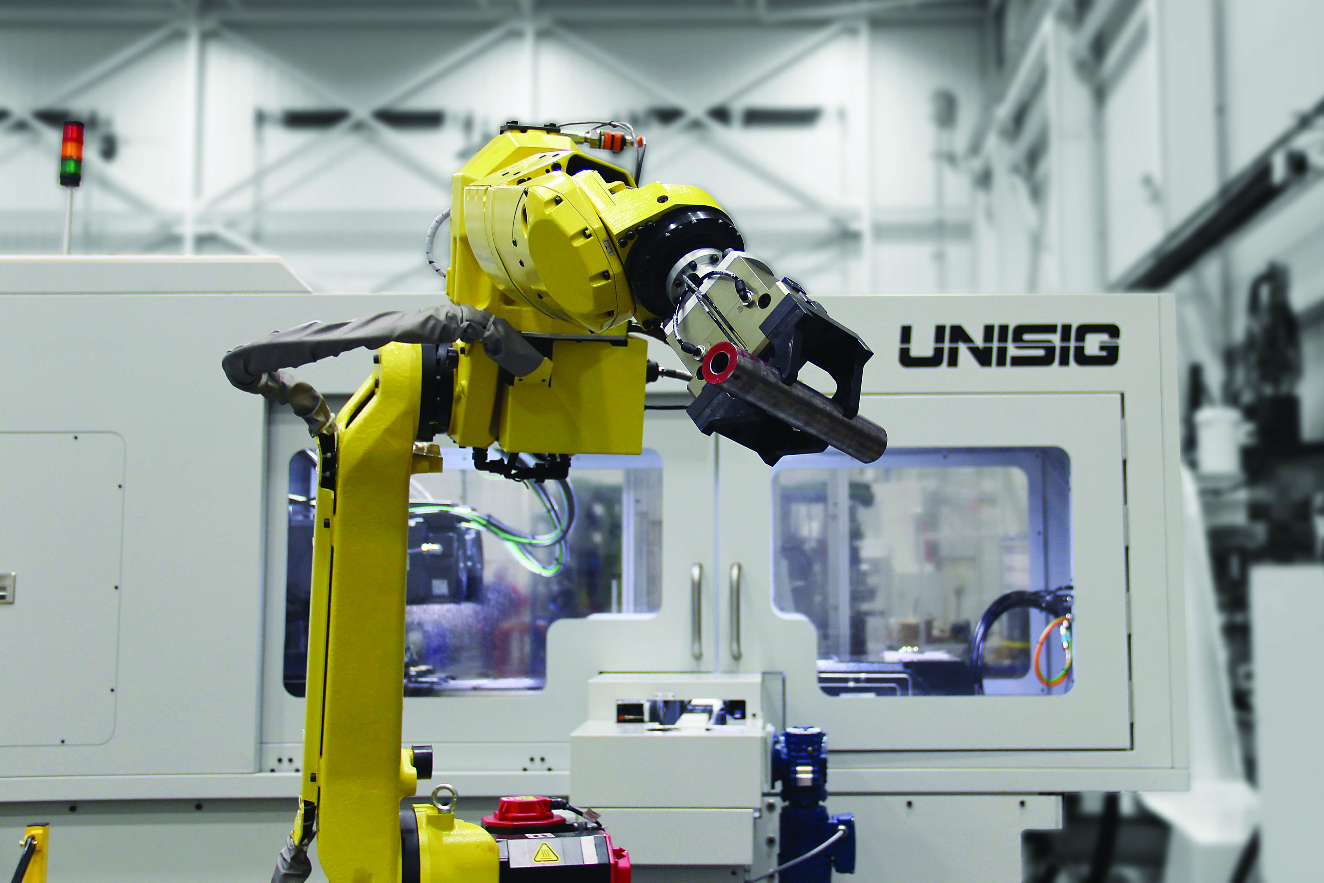

These shops increasingly opt for deep-hole drilling systems that also work with automation. In a typical deep-hole drilling work cell configuration, such as one for producing rifle receivers or automotive shafts, the equipment can use automation to time its cycle completion to mesh with other production processes. For straightforward automation, conveyors and pick-and-place robots move and position parts for deep-hole drilling with exacting repeatability and accuracy while automatic toolchangers, doors and inspection stations keep parts moving swiftly into, out of and around the cell.
Because deep-hole drilling tends to apply to long, cylindrically shaped parts, workpiece configuration eases or complicates some aspects of automating load-in and load-out cycles tied to drilling operations. Workholding axes, for example, can provide automatic part gripping with pneumatic or hydraulic chucks operated through advanced controls for deep-hole drilling systems. In this configuration, machines can pick up a part, drill it and set it back down on a conveyor or part collection area. In deep-hole drilling systems themselves, specialized designs also offer automatic chucking, and robot-tending systems can add further flexibility with end-of-arm tooling, workholding and measuring systems.
Pick-and-place robots move and position parts for deep-hole drilling with exacting repeatability and accuracy. Image courtesy of Unisig
