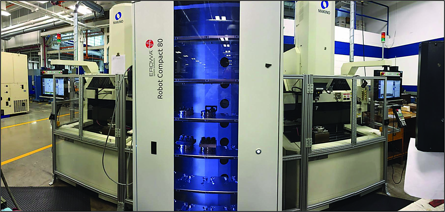

Makino offers a variety of cellular automation for sinker EDMs, such as the Erowa Robot Compact 80, which has a transfer weight capacity of 80 kg (176 lbs.) and can serve one or two machines. Image courtesy of Makino

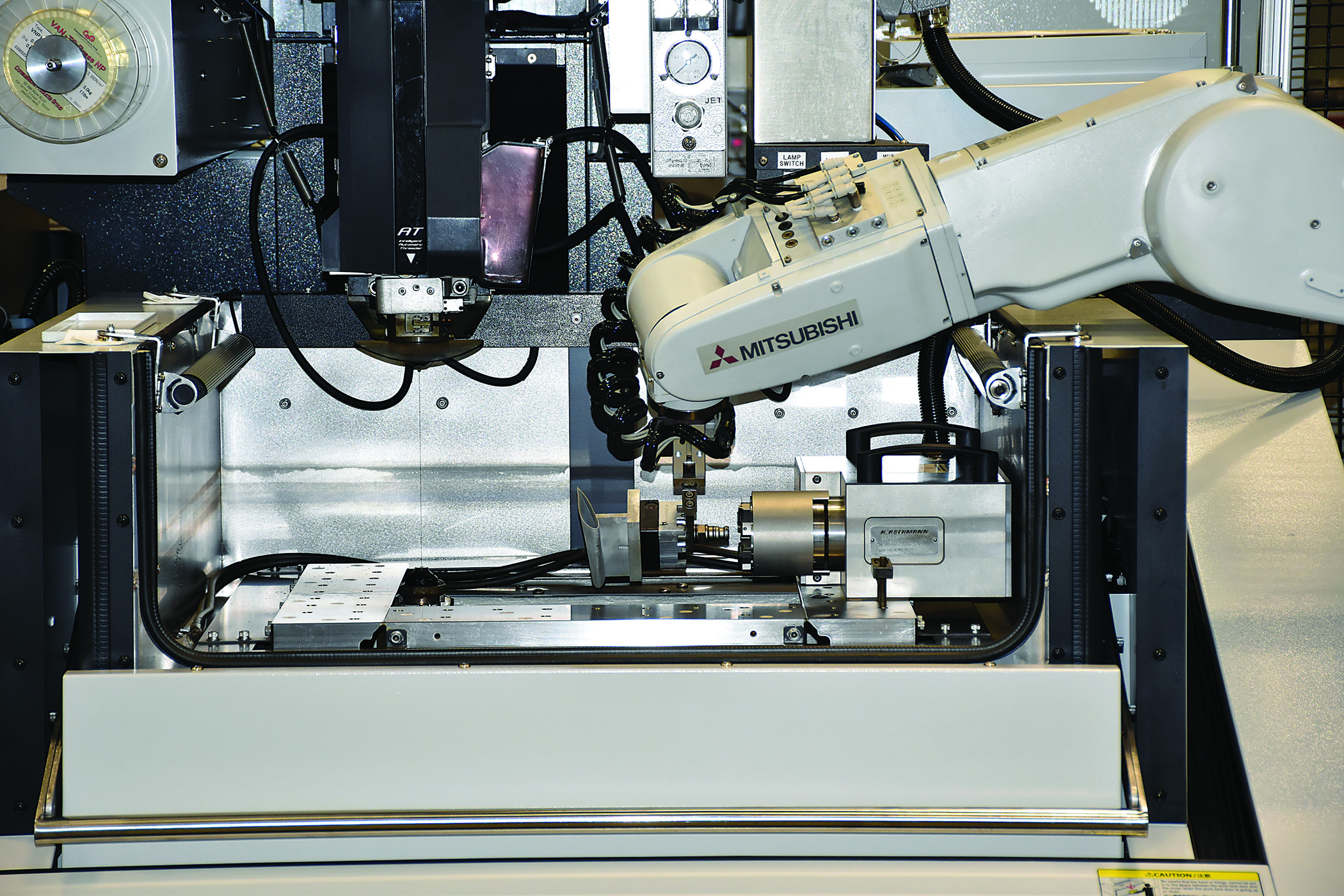

A Mitsubishi MELFA RV13F robot places a palletized production part into the tooling chuck of a rotary b-axis, which is mounted to the table of a Mitsubishi MV1200S wire EDM. Image courtesy of MC Machinery Systems
