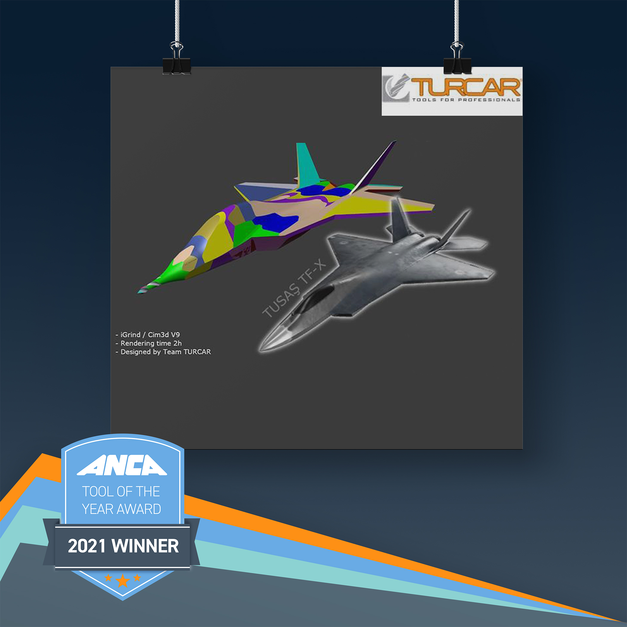

Led by their creativity and imagination in the Most Innovative Tool category, Turcar took first place with a fighter jet; Japanese tool maker Kojima won second prize with a colorful Tokyo Sky Tree and Turkish company Rtech placed third for their simulated image of Mustafa Kemal Atatürk, a former president of Turkey. All three managed impressive scalability of their tool without any drawings, instead letting their imagination create the works of art.

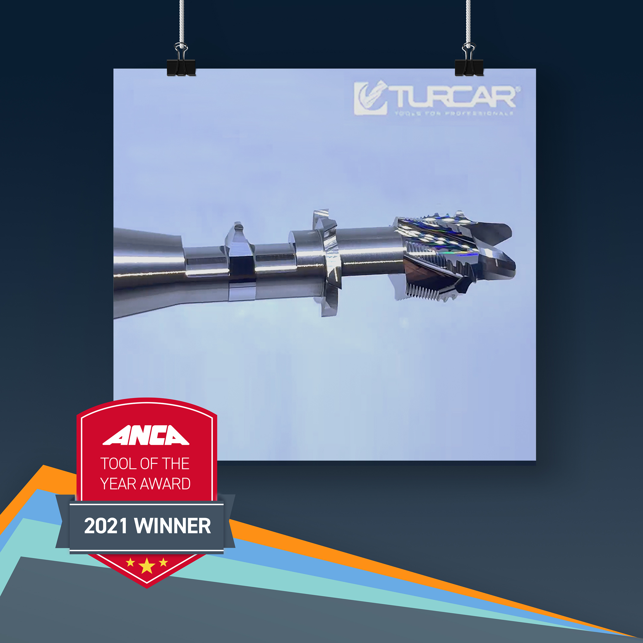

Thomson Mathew, an ANCA expert and judge shared his thoughts on the winners: “Turcar was recognized for its fully functional tool with axial and radial cutting features to machine five independent operations. An exceptional tool design that can produce its part in a single setup on the machine. The latest iGrind software and its flexibility is clearly on display with 27 different operations, advanced iGrind functions, Tool balance, Profile editor and Ripper form relief generously used to create this well-balanced tool. It was also impressive to see that the tool is completely ground in two hours with exceptional runout and surface finish.”

Thomson continued, “Turcar was first in this category for their brilliant display of creativity by manipulating ANCA's iGrind tool grinding software and CIM 3D tool verification software. A total of 61 operations were used to simulate a fighter jet model, effective use of advanced functions with latest version ANCA iGrind software with combining different TOM files.”
