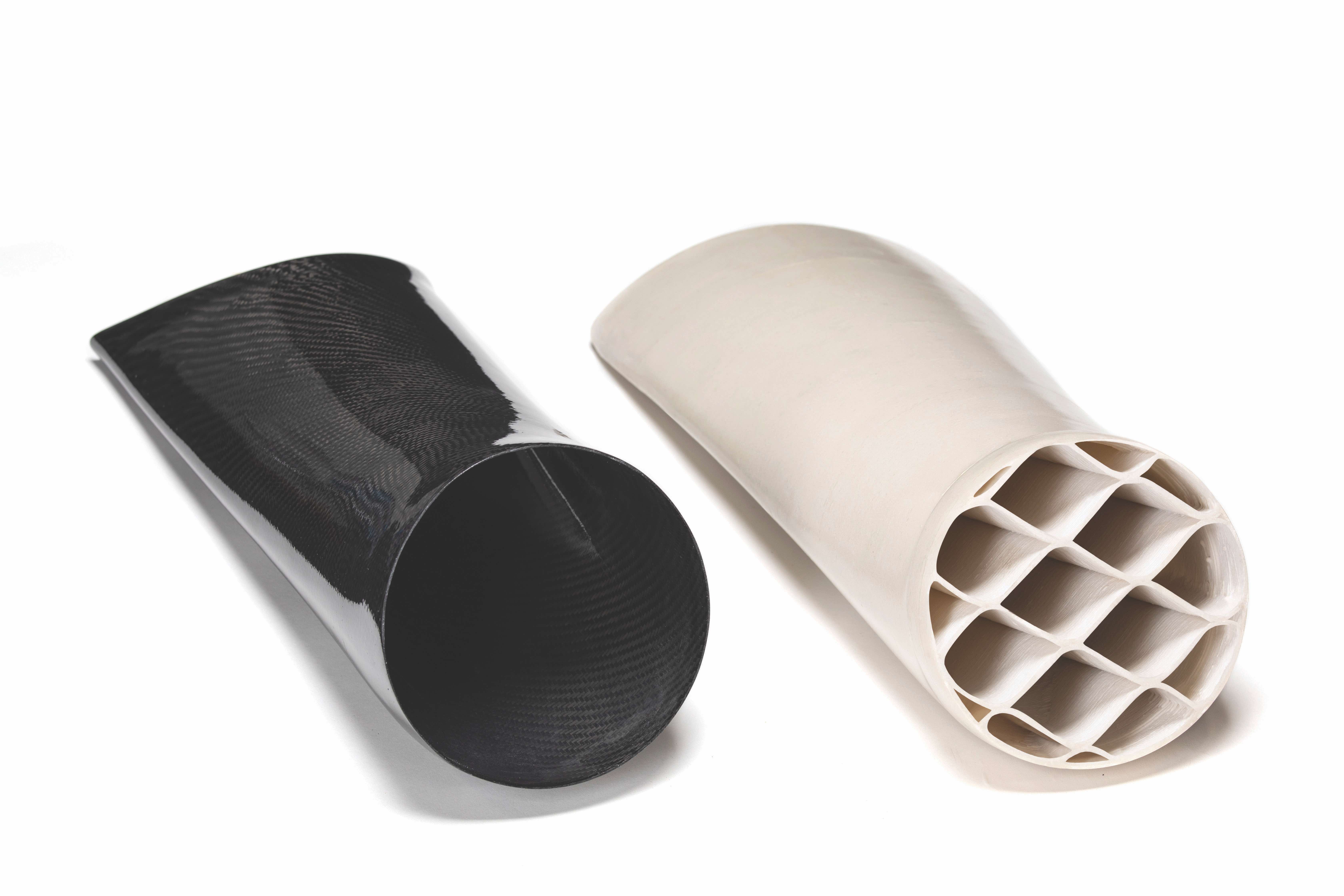

Top: 3D-printed sacrificial core for duct. Above:  Encapsulated 3D printed mandrel with skin in the bath.​​​​​

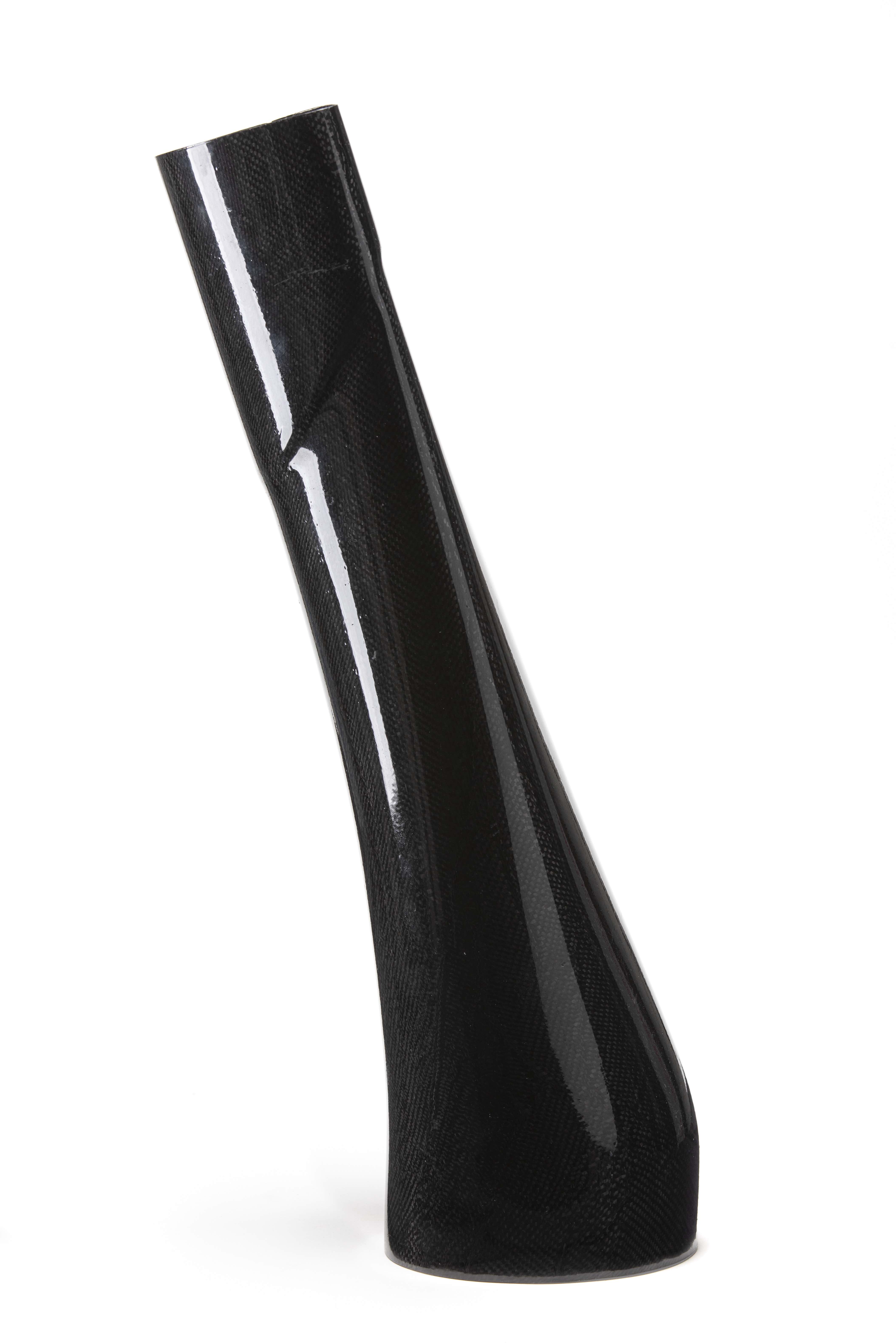

Carbon air duct skin produced from 3D printed mandrel
Carbon air duct skin produced from 3D printed mandrel.
Massivit 3D has developed a proprietary printing process for producing strong and durable mandrels. This represents a highly innovative solution for the production of composite parts, offering significant advantages over traditional manufacturing methods and enabling the production of high-quality composite parts with reduced lead times and lower costs.

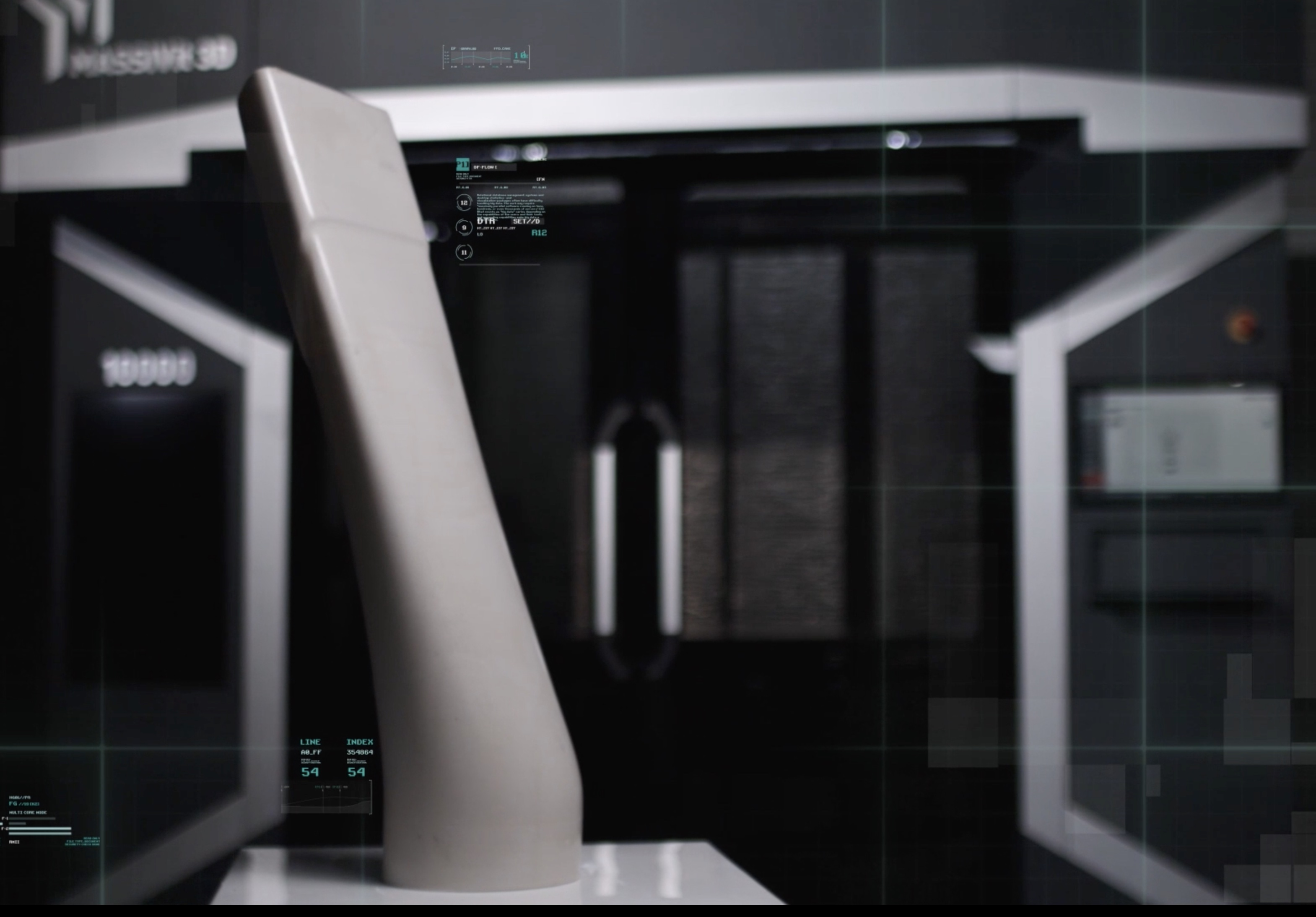

Duct mandrel being printed on the Massivit 10000 machine.

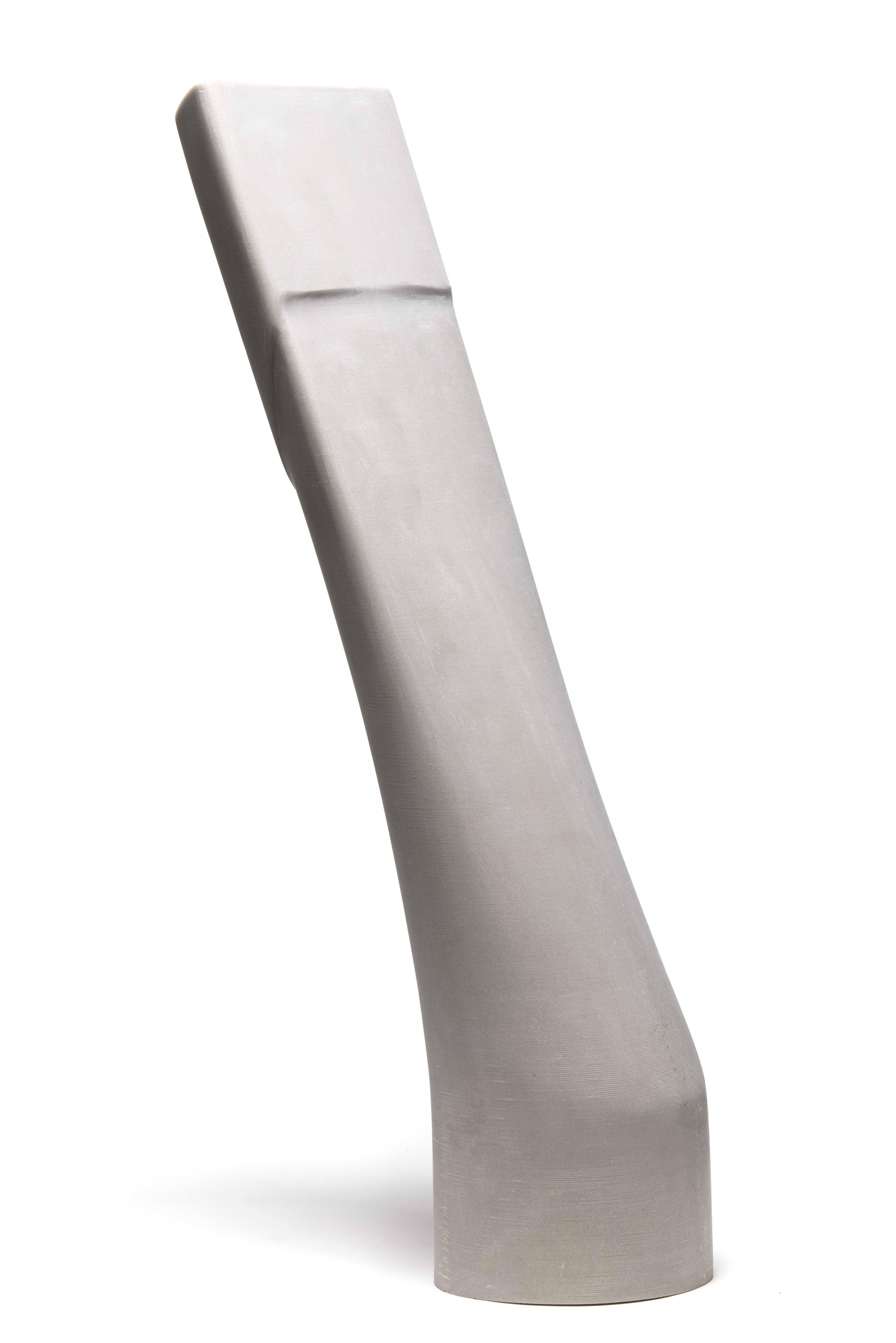

To illustrate the disruptive nature of the Massivit 3D approach to mandrel production, this case study looks at the process steps involved in the manufacture of a mandrel for the company Kanfit that serves the defense and aerospace sectors. The commissioned mandrel needed to be printed in Massivit’s water breakable material, and the outer surface of the printed mold needed to be very smooth.
First, a CAD model of the mandrel with dimensions X 381 mm, Y 191 mm, and Z 567 mm was created. To make it optimally aligned to Massivit’s 3D printing technology, the flange area of the model was extended digitally for better layup fabrication, and the wall of the mold was designed with three printing contours with a final width of 5.4mm to withstand the vacuum pressures at the fabrication stage. From the finished CAD file, the G-code of the mandrel was created on the Massivit Smart slicer software. The print was designed to use minimum time and material and took in total only 8 hours. The mandrel was produced using Massivit’s water-breakable DIM WB photopolymer material.
The part was then post-processed. The surface was sandpapered, and one coat of epoxy was applied to make the surface of the mandrel airtight.
For the layup stage, the mandrel was set up on a rotating jig, enabling the application of epoxy and carbon-fiber sheets (6 in total) around the tool. Once coated in carbon fiber, the mold entered the vacuum process, where it remained under vacuum pressure for 3 hours. It was then removed and allowed to rest for 24 hours before the final cure.
The finished mold was placed in plain water for 24 hours, and all remains of the water-breakable material were removed from the skin. The mandrel was then trimmed, and validated in the quality control department before release.
