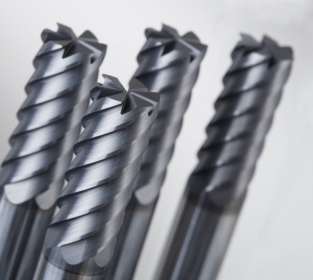

According to eifeler, the company takes a performance-focused approach to coating tools, ensuring the optimal synergy between the substrate, coating and application. voestalpine eifeler
Because a coating resists the heat a cutting tool faces at the tool/workpiece interface during machining while reducing friction and wear and potentially serving as a wear indicator, the majority of cutting tools are sold coated. The exact percentage is difficult to establish but probably at least 60% are coated, with physical vapor deposition being the dominant deposition process.
Determining the appropriate coating or combination of multilayered coatings for an application requires a tool coating company to consider an array of factors, including the workpiece material, the common failure mechanism, the machining parameters, edge preparations, and the tool material, type and size, said Jeff Barlow, president of CemeCon Inc. in Big Flats, New York, which offers services for coating inserts and round tools and sells PVD and diamond coating systems. “We don’t just slap a coating on somebody’s tool and say it should be good enough. We optimize it.”
The process starts with the material being cut, Barlow noted. “From there it’s determining how the tool is going to be used to determine the coating and thickness that makes the most sense.”

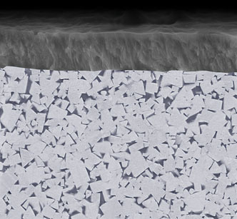

CemeCon offers PVD tool coatings deposited with a HiPIMS system and patented diamond coatings that combine the advantages of microcrystalline and nanocrystalline layers to slow crack formation. CemeCon

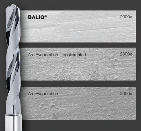

A BALIQ-coated tool enables smooth chip removal
A BALIQ-coated tool enables smooth chip removal and eliminates the need for mechanical post-treatment, according to the company. Oerlikon Balzers
A benefit of the company’s CCDia series diamond coating materials is the coatings combine the advantages of microcrystalline and nanocrystalline layers to slow crack formation by alternating the application of both layer variants and producing a coating with enhanced adhesion and smoothness, Barlow explained. “If it was a single form of diamond, one structure or the other, once a crack is formed it would go down to the substrate quickly. The intent is to slow that crack by changing the structure of the coating every step you go.”

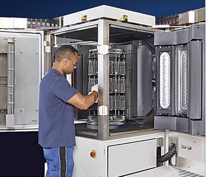

A technician loads tools into a high-power impulse magnetron sputtering (HiPIMS) PVD coating machine from CemeCon. CemeCon

The S3p process prevents droplet formation. Sputtering is a process whereby atoms are ejected from a solid target material due to bombardment of the target by energetic ions, Oerlikon Balzers states. In a thin-film coating, this is achieved by accelerating argon ions towards a solid target where they knock out metal atoms that are collected on the workpiece.
By combining the two technologies, the S3p process reportedly produces a smooth coating surface, enhanced adhesion and a high coating density and hardness. The smooth surface means built-up edge is reduced even when cutting difficult-to-machine materials.
By generating a smooth surface, mechanical post-treatment of coatings is eliminated, Jeong said, saving money and improving throughput. Based on the S3p technology, Oerlikon Balzers introduced the BALIQ family of wear-resistant coatings. The density of the coatings is very close to the highest density theoretically possible to provide a high resistance to crack propagation, according to the company.

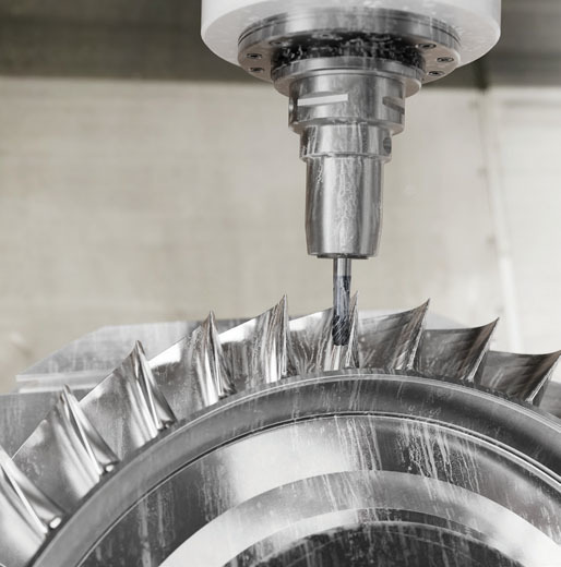

Sandvik Coromant states that its new Zertivo 2.0 multiple-layer PVD coating is a standout feature of the company’s CoroMill Plura barrel cutter for profiling, delivering significantly longer tool life by reducing wear and improving heat resistance. Sandvik Coromant

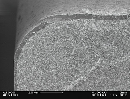

Sandvik Coromant Co. uses commercially available PVD vessels to coat its cutting tools, as well as some that the toolmaker’s PVD coating engineers developed, said Matthew Stewart, product manager for indexable milling and drilling products.
The Mebane, North Carolina-headquartered company’s latest PVD coating is Zertivo 2.0, which was released in March, he noted. The new coating complements the Zertivo 1.0 PVD coating by targeting round tools while the coating introduced in 2016 is more for milling products.

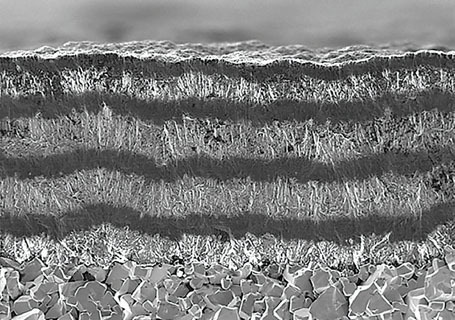

For example, the CoroDrill Dura 462 solid-carbide drill has a multilayer TiAlCrSiN Zertivo 2.0 coating, Steward said. The thickness of a multiple nanolayer coating depends on the application, such as how much heat resistance is needed. “With the nanolayers, they are basically small layers like sheets of paper that are stacked up.”

image of Sandvik Coromant’s Zertivo coating on the substrate of a milling insert
Sandvik Coromant’s Zertivo coating on the substrate of a milling insert. Sandvik Coromant
image og Sandvik Coromant’s Zertivo coating on the substrate of a milling insert
