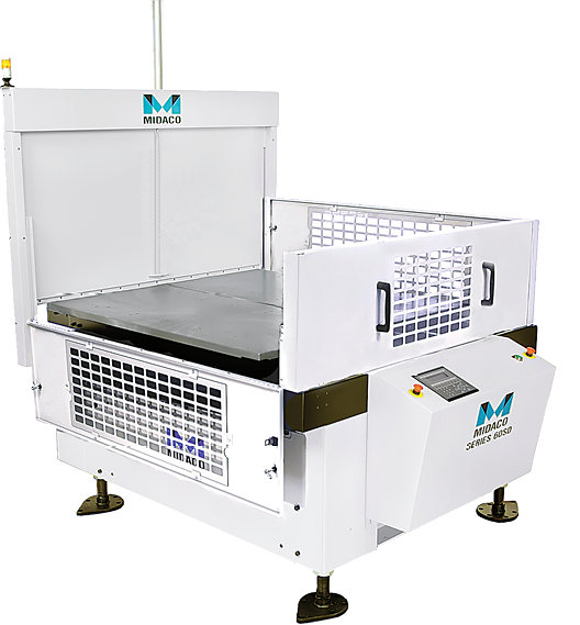

Mike Cayley Jr., vice president of manufacturing for Midaco Corp., Elk Grove Village, Ill., said the number of shops taking this route is on the rise. “We’re selling pallet changers to just about everybody.”
The biggest advantage to pallet changers, Cayley explained, is increased uptime. The machine is not sitting idle while the operator wrangles with a vise handle or blows chips off a fixture prior to loading a workpiece. For $40,000 and a day or so for installation, Midaco will be happy to fly a technician to your site, cut a big hole in the end of a VMC and bolt on a shiny new pallet changer.
The result is a device that can automatically swap an entire machine table’s worth of parts in a few seconds via an M code sent by the control. This frees the operator to tend other equipment, check parts, prepare the next job or load the next pallet. And increasing spindle time by just 1 hour per day at a $75 hourly shop rate means a 2-year return on investment. But, as Cayley pointed out, many shops see ROI much faster than that by eliminating several hours of daily downtime, depending on the application.

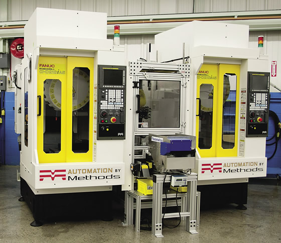

Methods Machine Tools Inc. is another company offering automated machines. John Lucier, automation manager for the Sudbury, Mass.-based machine supplier, explained that a large percentage of its automation projects are on verticals. “For many applications, we see auto-loaded VMCs as a great alternative to horizontals. They’re especially well-suited for smaller shops, where floor space is at a premium.”
Some of this automation comes in the form of gantry loaders. Often used for high-volume production, these stork-like devices straddle the top of a machine tool. The gantry arm, equipped with a gripper, plucks a casting or cut blank off a carousel. The blank is carried to the VMC’s work area and delivered to the workholding device, where it is swapped with the finished workpiece.
Courtesy of Methods Machine Tools
A Methods RoboDrill Twin Cell with two FANUC RoboDrills is serviced by a robot.
Lucier said gantry loaders are an effective solution for many applications, but while articulating robots usually cost more, they do offer enhanced flexibility. “Gantry loaders require more planning up front. The rail length is fixed when you buy one, so you can’t just decide one day to incorporate a wash station into your automated process or add a second machine to the cell. There’s not a lot of extra room with a gantry, so they don’t handle a variety of workpiece sizes very well, and, since most utilize a PLC rather than a CNC, programming for different jobs can be a bit more challenging.”
With an articulating robot, juggling the work typical for most job shops is straightforward, Lucier explained. As long as the workpiece, other mach-ine tools or ancillary equipment is with-in reach of the robot’s arm, modifying the process flow involves reprogram- ming its CNC and possibly changing the grippers.

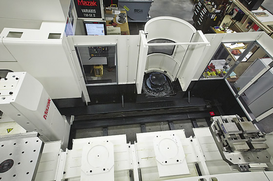

Choice Precision Inc., Whitehall, Pa., uses a double-level, 12-pallet stocker station Palletech manufacturing system paired with a Mazak Variaxis 730-5X II 5-axis VMC.
Adding a robot to a VMC can cost as much as the machine itself—Methods’ JobShop Cell, for example, starts at around $85,000. Designed for use with a FANUC RoboDrill VMC, the JobShop cell comes with a FANUC 200iC 6-axis robot, integrated parts conveyors and double-gripper end-of-arm tooling. Add to that engineering, tooling and integration costs, and the final price tag is in the low six figures.

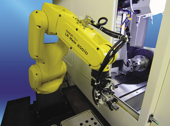

Michael J. Cicco, general manager of distribution sales for FANUC America Corp., Hoffman Estates, Ill., gives a resounding yes. “Robots work through lunch. They never take a break. And the instant a part is finished, the robot is there to unload it. Robots increase spindle utilization and reduce load/unload time, easily justifying the cost and learning curve associated with implementing an automated system.”
Maybe you’re convinced, but are still worried about setting up and programming another machine, one that’s alien to your shop. Don’t fret. Robots are easier to program and operate than R2D2.
“We use the same hardware as on our CNCs, so the architecture is very similar,” Cicco explained. “It uses simple commands: open or close the grippers, wait for the machine, close the door, that sort of thing. You tell it to move to a certain point in space and it goes there. About the only information that’s required are the part dimensions and load/unload positions, and rest is fairly automatic.”
Nor is tooling a robot difficult. Cicco said various grippers are available, many of which are quick-change. Some even come with servomotors, making them infinitely adjustable and capable of a grip firmer than a politician’s handshake. Best of all, robots can be added to just about any VMC, even ones old enough to remember the Reagan administration. “Newer CNCs offer cool features such as automatic offset changes and integrated gaging, but even the most ancient machine can be outfitted with robotics,” Cicco said.

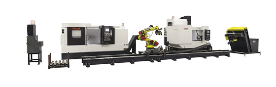

A vertical turning center with a fixed table and removable center partition, such as this one from Mazak, provides an inexpensive two-pallet changer option and can connect to NC rotary tables and continuous-connection hydraulic fixtures.
Mundra said in-process probing can even take the place of a coordinate measuring machine. To those who worry about cutting and measuring parts on the same machine, Mundra pointed out that with the right probe, CAD-based NC measurement software and proper machine calibration, most features can be reliably measured on-machine.
Automated inspection does require additional programming, though, and may mean tossing traditional macro-style probing functions in favor of in-process measurement software. “Macros become very complicated as you move to in-situ inspection,” Mundra said. “Taking a few points to measure a hole, for example, is no problem for a macro. But when you need to measure hole-to-hole relationships to a datum or measure profiles or complex features, that’s when a math engine comes into the picture, eliminating the use of macros.”
Courtesy of Mazak
A track-mounted robot tends a Mazak vertical turning center and VMC.
