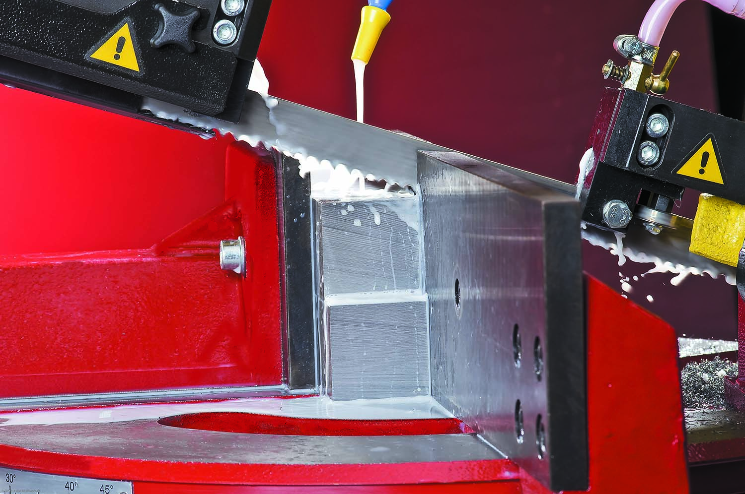

Teeth Stripping
Improper break-in of the blade. An improper break-in leads to chipped teeth, which shorten blade life and possibly lead to tooth strippage. Follow the proper break-in procedure from the blade supplier.
Blade speed too slow. Speed should be established based on the type of material. If the speed is set too low, the teeth can over-penetrate, which puts excessive stress on them and eventually causes them to strip. It is also important to refer to cutting recommendations from the saw machine manufacturer.
Feed pressure too high. Reduce pressure to avoid over-penetration and tooth strippage.
Tooth jammed in the cut. When this occurs, do not enter a new blade in that cut. When teeth strip, there is a good chance that remnants of the teeth are left in the cut. If a new blade is installed and then fed back into the same cut, it is likely that these remnants, which are as hard as the new teeth, will cause the new blade to strip teeth as well. It’s always best to start a new cut. Or, if you must cut at the same position, turn the material over and try coming in from the opposite side.
Poor cutting fluid application or ratio. Adjusting for the proper coolant flow and ratio is key because cutting fluid is necessary on almost all materials. It provides both cooling and lubrication to the cutting surface. Without cutting fluid, excessive heat is generated, leading to poor blade life and possible tooth strippage.
Hard material or heavy scale. Hard, scaly materials present their own problems. With proper feeds and speeds, the challenges can be overcome, but these material types do tend to be more susceptible to strippage than others.
Wrong blade pitch. Using the wrong pitch, especially too coarse a blade, typically applies too much pressure to each tooth and eventually leads to strippage. Proper tooth selection is key.
