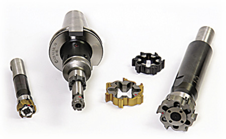

Dihart-ReamaxTS-Reamer.tif
Courtesy of KOMET of America
KOMET’s DIHART-REAMAX TS modular reaming system offers a range of reaming heads to handle common reaming diameters and machining requirements.

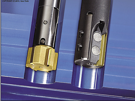

A reamer functions by following an existing hole and removing metal along the way, whereas a boring tool finishes a hole by cutting its own path, but both types of tools can achieve the same specified tolerance and surface finish. For example, Smith explained, a solid- carbide fixed reamer is effective for achieving H7 hole tolerances and an adjustable, or settable, reamer is suitable for H6 or even H5 tolerances, similar to what finish boring can achieve. (The H system is for specifying hole tolerances and uses a tolerance zone, defined as a spherical zone restricted by the upper and lower limit dimensions of the part. The lower the H number, the tighter the tolerance.)
An Adjustable Fit

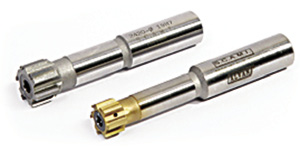

Although some reamers can be adjusted outward to compensate for tool wear, they are suitable for finishing a specific hole diameter and are not expandable to ream a range of diameters. “You’re not getting a lot of adjustment,” said Jacob Miller, product manager for Allied Machine & Engineering Corp., Dover, Ohio, which makes reamers. “You get 1 to 4 percent of the diameter, so if you have a 0.200 " reamer, you get 0.002 " of expansion. The expansion accommodates for wear, but also allows the tools to be reconditioned to the same diameter.”
Of course, that capability isn’t possible with a nonadjustable tool. “With a fixed reamer, if you have to recondition the OD at all for wear, you’ve lost the diameter,” Miller said.

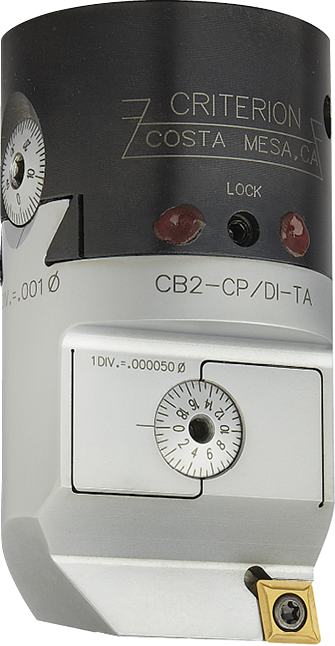

_MG_4007.tif
Courtesy of Criterion Allied
Criterion Allied’s Micro-Adjusting boring head enables 0.00005" (1.27µm) adjustability on diameter.

Wahlstrom noted a boring tool can be adjusted to compensate for insert wear. “We have products that have 0.00005" adjustability on diameter.”

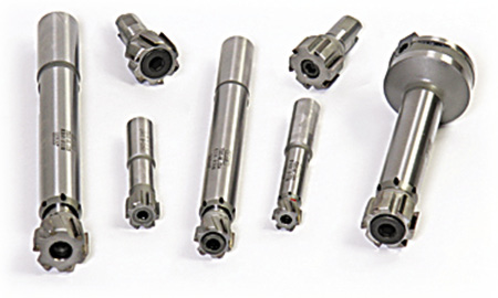

IMG_6534.tif
IMG_6809.tif
IMG_6553.tif
IMG_6810.tif
Courtesy of Allied Machine & Engineering
Allied Machine & Engineering offers an array of fixed and adjustable reamers.
As a result, boring is traditionally a hole-finishing operation for lower volumes with reaming used for higher ones, but volume is in the eye of the beholder. If a job, for example, is for only 250 components but the customer repeats the job six times a year, it can qualify as high-volume production suitable for reaming, according to Smith. He uses the rule of thumb of 1,000 holes or components as the point when a reamer comes into play.
Smith described one high-volume application where a customer was finish boring 256 holes in each of several plates. To achieve the tolerance, the boring head required adjustment after every fourth hole because of insert wear. By switching to reaming, the customer eliminated tool adjustment while feeding five times faster because of the reamer’s multiple flutes.
“We determined that finish boring would have been the better option if they were machining five holes in a 10-piece job,” Smith said. “At that point, you could set the finish boring head, run your holes and put the head away for a different component down the road.”
However, even a run of five parts can justify reaming based on part quality requirements and reduced risk of scrap because no tool adjustments are needed, according to von Rohr. “It’ll be first part, good part,” he said. “The risk of scrap is higher with a boring tool than with a reaming tool.”

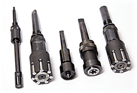

p91a.tif
Courtesy Hassay Savage – Magafor
Magafor reamers are designed for through-holes, with a left-hand spiral and right-hand cut to push chips forward instead of pulling them back through the hole.

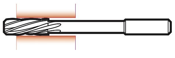

Runout is a major enemy of reaming, so applying the tools on an accurate and rigid machine tool is recommended.

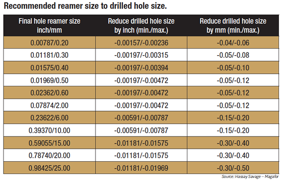

He added that leaving too much stock also creates problems, such as eclipsing and loading the reamer to the point that it breaks. (See chart above.)
One factor that determines how much stock to leave is the hole diameter. Although von Rohr’s rule of thumb is allow 0.008" to 0.012" (0.203mm to 0.305mm) of stock on diameter for reaming, he emphasized a 0.118 "-dia. solid-carbide reamer cannot remove as much material as a 4"-dia. one.
Dalhover concurred, recommending leaving about 0.005" (0.127mm) of stock for an 1⁄8" (3.175mm) reamer compared to 0.010" (0.254mm) to 0.015" (0.381mm) for tools ½" (12.7mm) and larger. He explained that the chamfers are what mainly cuts the material, and a 1⁄8" reamer, for instance, might have a 0.015" (0.152mm to 0.305mm) chamfer length. “If you leave 0.020" of stock, it’s not going to remove that stock because the chamfer length is not going to be touching that area for about 0.005".”
In addition, the workpiece material dictates the stock allowance. While leaving 0.006" to 0.012" (0.152mm to 0.305mm) is suitable when reaming 28- to 32-HRC 4104 steel, Smith indicated 0.004" (0.102mm) of material is more appropriate for metals with a hardness of 50 HRC and harder.
