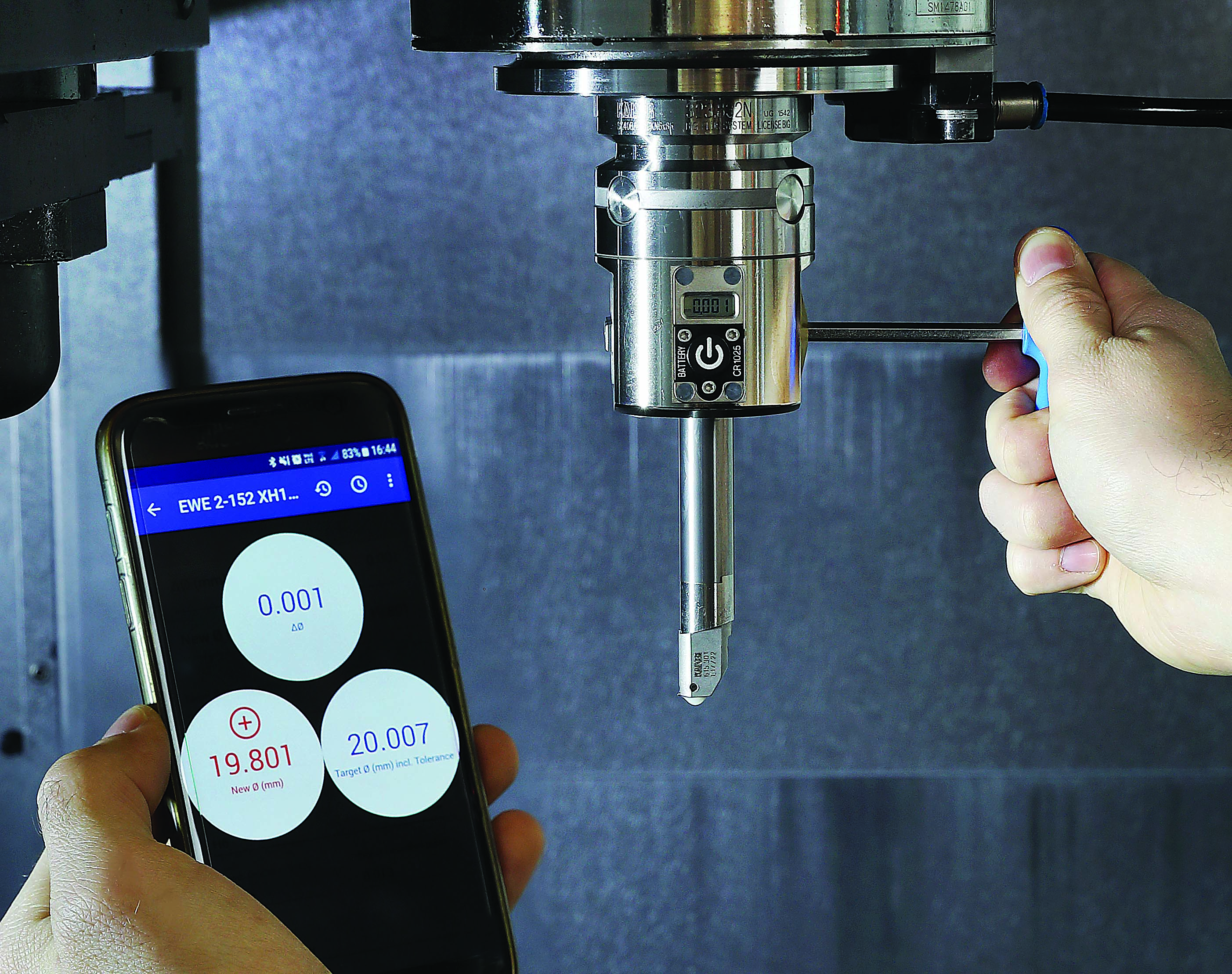

Featuring an embedded digital screen with Bluetooth technology, the EWE fine boring head is designed to make it easy for operators to monitor and configure the head when used with a special mobile app. Image courtesy of BIG KAISER Precision Tooling
He believes that rough boring is the best way to prepare a hole. A twin bore roughing tool with two cutting edges can be used to ensure that a hole is round and properly located for finishing, he said.

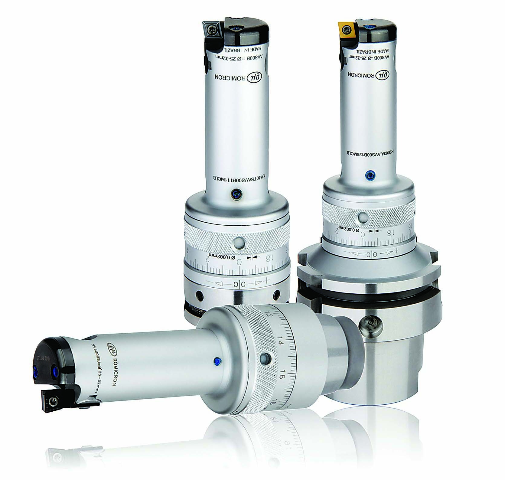

The cutting edge of a finish bar is moved by a micrometric mechanism to adjust the bore diameter. When using boring heads from BIG KAISER Precision Tooling, this usually is done with a micrometer screw, but other boring heads employ different mechanisms. Whatever the mechanism, he said the goal is the same: to adjust the cutting diameter in the finest possible increments to accurately control bore size.
Although it may sound challenging, making very slight adjustments to fine boring tools can be easy. Using the Romicron fine boring system from Latrobe, Pennsylvania-based Kennametal Inc., for example, each 1 µm (0.00004") radial adjustment can be made simply by turning the adjusting ring until a click is heard, said Michael Hacker, senior global product manager for hole finishing at Kennametal Shared Services GmbH in Fürth, Germany.

The Romicron fine boring system is designed to allow easy, precise manual adjustments. Image courtesy of Kennametal

Tegelman believes that in recent years, fine boring has gotten a boost from the appearance of boring heads with a digital display to show adjustment increments. Today, he said, BIG KAISER Precision Tooling’s EWE digital fine boring heads can communicate with software not only to display and record offset adjustment information but to use the last measured bore diameter value to determine the output diameter of the next cut and then show where that diameter lies in the application’s tolerance band.
The company currently is working on closed-loop boring tools that adjust themselves using back-and-forth communication between the tool and online probing equipment in the machine. These tools feature a boring head that replaces the fine adjustment screw mechanism with sensors and a small motor that makes size adjustments based on measurement data from the sensors. BIG KAISER Precision Tooling hopes to release products equipped with this technology later in the year.

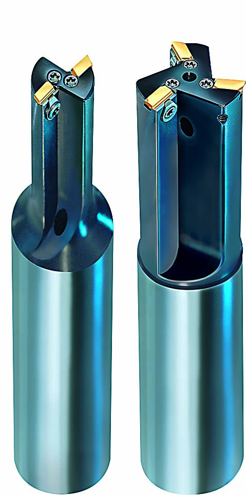

In addition to standard finish boring tools, shops can opt for custom fine boring tools like those available from Hollfelder-Gühring GmbH in Nuremberg, Germany. (Guhring Inc. is in Brookfield, Wisconsin.) One of the main differences between custom tools offered by this company and competitive offerings is that Hollfelder-Gühring does not use typical ISO inserts, said Henry Hack, production and technology manager.
A typical insert is held in place by a screw.
“If the insert moves in the pocket seat, the customer loses part precision,” Hack said. “But if you have a tight fit of your insert in the pocket seat, there is no movement.”
Hollfelder-Gühring’s fine boring tools have prismatically shaped pocket seats. Instead of using screws to hold inserts in place, he said the tools employ a self-clamping system in which cutting forces push the inserts into the prismatic seats and firmly hold the inserts in place.
In addition, Hack said the company’s precision-ground inserts produce tighter diameter tolerances and better surface finishes than their ISO counterparts. He also touted the inserts’ positive cutting geometries and very sharp cutting edges, which reduce cutting forces and therefore make the inserts suitable for fine boring of thin-wall parts and other delicate components.
He said Hollfelder-Gühring’s fine boring tools benefit from systems that allow users to make micron-size adjustments to the inserts in their pocket seats to tightly control bore diameters. Together, he said, the precision-ground inserts and highly precise adjustment systems make it possible for the company to produce fine boring tools with two or three inserts instead of the single cutting edge on conventional finish boring tools.
This is a big advantage for high-volume production applications in the automotive industry and other industries.
Normally, “if your part requires three different diameters and step lengths in one hole, that means you need three tools and three manufacturing steps, which takes a long time,” Hack said. “But we can do it with one customized tool made for all three diameters that machines the complete bore in one pass, which reduces cycle time.”
Although Hollfelder-Gühring’s custom fine boring tools are “a little more expensive” than competitive standard offerings, he said the benefits outweigh the heftier price tag.
