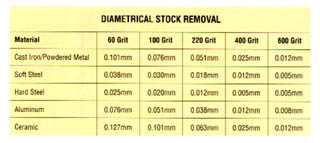

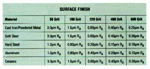

Stock Removal vs. Surface Finish
The amount of stock a single-pass superabrasive tool can remove and the surface finish it can produce are directly related to the size of its superabrasive pArticles. For example, a 100-grit tool can generally remove up to 0.075mm in a gray-cast-iron part and achieve a 1.5µm Ra surface finish. A 400-grit tool in the same material can produce a much finer finish, but it will be able to remove, at most, 0.025mm of stock.
Table 1: the approximate amount of stock removal possible with single-pass tools of various grits. These numbers are for reference only, part shape and length can affect the tool's stock-removal capabilities. Coarser grits are available for maximum removal. (Click for larger images)
Table 2: The approximate surface finish achievable with sngle-pass tools of various grits. These numbers are for reference only, all are dependent on particular material specifications. Finer grits may be available for even lower surface finishes. (Click for larger images)The same principle holds true when finishing other materials (Tables 1 and 2). For example, in hardened steel a 100-grit tool may be able to remove 0.020mm of material and achieve a 0.60µm Ra finish. A 400-grit tool in the same material can produce a surface finish as low as 0.15 Ra, but it will be held to a much lower removal rate. Because many applications require both a high removal rate and a fine surface finish, end users frequently finish bores with a series of preset, single-pass tools. This is called a multitool operation.
To perform a multitool peration, the user sets each tool to remove its hare of the total material. As the part is passed from tool to tool, material is removed from the bore in ever-diminishing amounts to bring it to size. To accomplish this, the part is first machined with coarse-grit tools for maximum material removal and then fine-grit tools to produce the desired surface finish.
