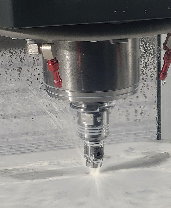

image of spindles for micromachining
CoolSpeed Max enables a rotation speed up to 60,000 rpm with wireless spindle speed monitoring and is Industry 4.0 ready. WTO

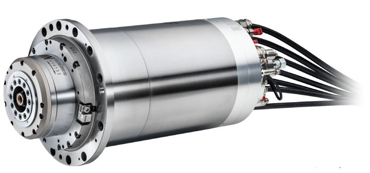

Steve Boucher, engineering manager at GMN USA in Bristol, Connecticut, concurred that achieving a fine surface finish is a major benefit of a high-speed spindle, particularly when grinding. The company offers manual tool change spindles with speeds up to 250,000 rpm, which are primarily for grinding, as well as the UH series manual tool change spindles with a speed up to 120,000 rpm and the HCS series automatic tool change spindles for reaching a speed up to 105,000 rpm when milling. "For grinding, a lot of times the parts are roughed at a slower speed and then users just do the last surface finishing with a very high-speed grinding wheel."
Microscale grinding wheels are needed for high-speed applications, Boucher added, sometimes as small as 0.5 mm (0.02"). "Not many shops need a 250,000-rpm spindle because in that case they need to also come up with those very small grinding wheels. We have no problem coming up with the speeds, but at that point it's limited on their tooling."
He noted that the company's spindles are also suitable for applications that don't qualify as micromachining. "You can have a ½" endmill in there and it's going 40,000 rpm. That's still considered high-speed milling."
A manual tool change spindle is oftentimes used in an R&D environment or as the initial choice to determine what the spindle is capable of before getting into production, Boucher said. Then GMN can modify or redesign the spindle to provide an automatic tool change.

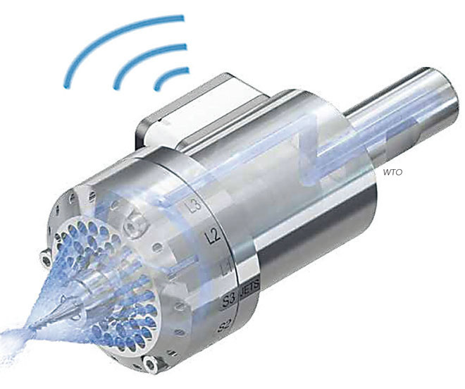

WTO supplies CoolSpeed coolant driven ultrahigh-speed spindles that operate from 20,000 to 80,000 rpm. WTO

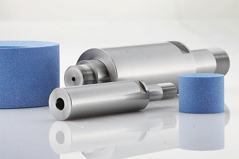

A quill allows a CNC spindle to reach into the deep, hard-to-finish recesses of a workpiece when grinding and abrasive machining, essentially a telescopic extension of a spindle. Boucher added that quills are usually made of carbide and provide minimal runout and a high level of concentricity.

Depending on the coolant pressure, Neale said CoolSpeed mini and Flex spindles operate at 30,000 to 80,000 rpm. A pressure of 10.3 bar (150 psi) enables a speed of 30,000 rpm, and 80,000 rpm is achieved with 68.9 bar (1,000 psi). The company's new model is the CoolSpeed Max, which uses an ER11 collet and goes from 20,000 to 60,000 rpm with about two to four times the torque of the company's smaller spindles.
"A lot of customers have a standard 300-psi pump, and with those kinds of pumps you're going to get about 50,000 rpm as your max spindle speed," Neale said. "The average customer is running them around 50,000 to 60,000 rpm."
The CoolSpeed mini is a high-speed turbine-driven spindle with a dynamic runout of 4μm (0.0002"), the company reports. The cutting tool shank serves as the spindle shaft, and the spindle fits in standard toolholders for automatic tool change.
The CoolSpeed Flex was engineered for Swiss-type machines, Neale said, but WTO found that it's effective in turning centers and milling machines. It has a universal mounting shank and can be plumbed through the back or side port. "If I have external coolant only, I can plug in a coolant line right to that side port. If I have internal, or through-spindle coolant, I can plumb it directly through the back of the shank."
image of Automatic tool change spindles
Automatic tool change spindles from GMN USA can perform any function of a conventional spindle, including high-speed grinding, drilling and milling. GMN USA
He noted that CoolSpeed Flex is WTO's most popular spindle by far because it has adjustable coolant jets. "If I have a lower pressure machine, let's say 300 psi, I'm going to want to run at one to two jets. It's going to create more back pressure, keeping that rpm higher."

image of a
Selecting the proper spindle grinding quill is a critical factor for a successful ID grinding operation. GMN USA
