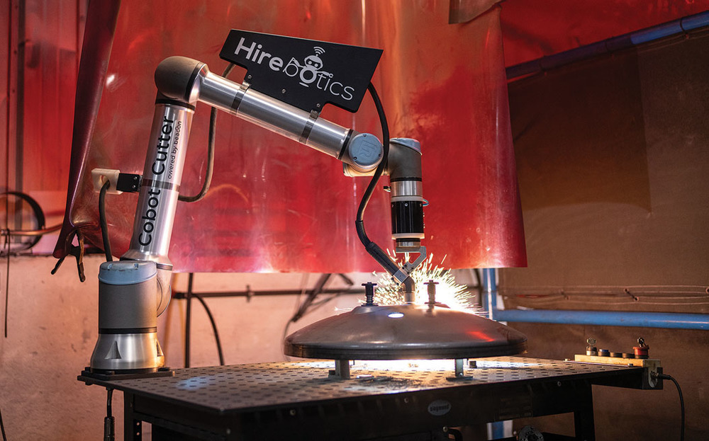

image of PLASMA CUTTING At Tank Technology, the Cobot Cutter from Hirebotics reduced rework due to cutting errors from 25% to nearly zero. Tank Technology

Hirebotics had that idea as well and developed the Cobot Cutter, a cobot-operated plasma cutter, which Tank Technology purchased in December 2023. The lead time was short at two weeks, said Eric Pamenter, first shift ASME production lead for Tank Technology.
“With the Cobot Cutter, we’re seeing perfectly sized holes, perfect location every time, repeatable locations,” Pamenter said. “By hand, you can say a human is traveling at 11 to 13 inches per minute. We are traveling at anywhere from 100 to 130 inches per minute with this cobot.”
The cobot enabled the company to undertake tasks previously thought unfeasible, such as beveling intricate parts with precision, Kufahl noted. Using a beveling tool requires replacing costly bits and is time consuming, requiring up to two hours to do a bevel in 12.7 mm (½;") steel plate. With the cobot, programming and the beveling process consumes about 20 minutes. “Then take a grinder and clean up the edge a little bit to get some of the oxidization off and you’re good to roll.”
The Cobot Cutter reduced rework due to cutting errors from 25% to nearly zero, and cutting cycle times shrank from five minutes to less than a minute on most heads, Tank Technology reports. The company realized a return on investment in about two months, Pamenter said.
