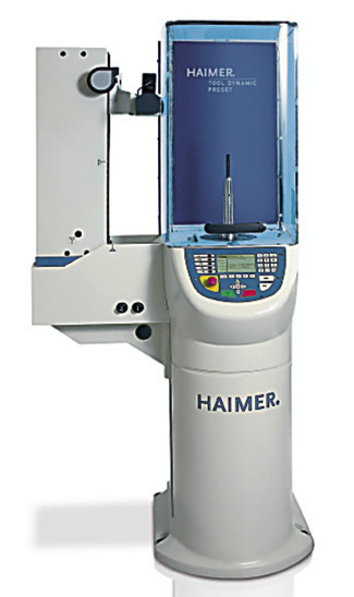

Haimer_TDPreset_2009.tif
Haimer’s TD Preset is equipped with ZOLLER measuring technology and enables balancing and presetting tools in one machine. Image courtesy Haimer USA.

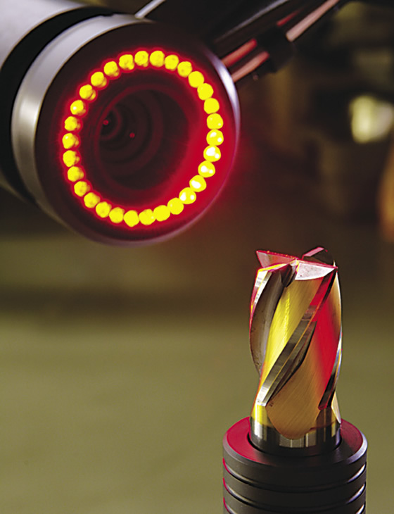

Parlec%20Presetter.tif
The vision system on a Parlec presetter quickly and accurately picks up tool edges and sends dimensional data to an onboard database, according to the company. Image courtesy Parlec.

If you need a presetter with balancing capability, Brendt Holden, president of Haimer USA LLC, Villa Park, Ill., will be happy to set you up with his company’s version of a combo machine: a ZOLLER presetter with Haimer balancing technology. “We’re known for balancing machines, but we also recognize the importance of presetting,” he said. “This is why we partnered with ZOLLER. We buy the software and vision system from them, and integrate it to our balancing machine.”

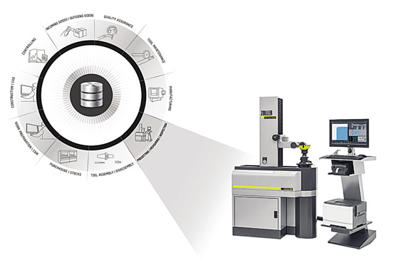

Zoller_TMS_Plus_venturion.tif
The Venturion presetter can be linked directly to a machine or integrated to the ZOLLER TMS. Image courtesy ZOLLER.
Holden said a trend in this arena is the increased use of radio-frequency identification, which allows presetters and CNCs to read and write tool information as easily as scanning bar codes at a supermarket. But because the RFID chip is mounted on one side of a toolholder, they are inherently out of balance. A combo machine that can balance the tool, measure it and then write tool identification and offset information directly to the chip makes sense. “The RFID chip idea is wonderful,” Holden said. “Tools can be moved very quickly in and out of the machine tool, with no risk of operator error. Just make sure you balance the holder as a complete assembly after mounting the chip, as they add enough weight to cause problems at higher rpm.”

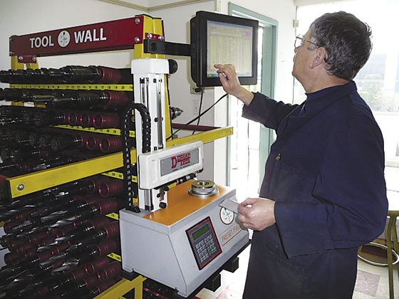

Peter Faust once had a problem. The president of Apollo Machinery Ltd., a manufacturer in Delta, B.C., that specializes in machining hydraulic manifolds, dealt with the same problems many shops struggle with: adequate tool storage and organization, coupled with time lost due to frequent setup of small production runs. Recognizing an opportunity, he designed a space-saving modular storage system similar to commercial tool racks but with a twist—it’s smart.
Apollo’s Tool Wall is a storage cabinet that keeps track of where tools are in the shop. Each pocket has an address, and each toolholder has a bar code with a unique master number. The cabinet’s software uses these values to tell operators which pocket to a store tool in, what job needs it next, what machine is currently using that tool, whether it needs replacing and a host of other information designed to increase efficiency. The traditional paradigm of tool setup sheets and manual offset entry is replaced by a user interface that walks an operator through the setup process, guided by a Big Brother-like database responsible for managing every aspect of tools, toolholders and machinery.
ToolWall_P10110064.tif
An operator presets tools in the Apollo Tool Wall. Each receptacle is retention knob-specific to eliminate accidental mixing of tools. Image courtesy Apollo Machinery.
Faust doesn’t make or market presetters and has been known to call them “beefed up calipers.” It’s not meant to be a disparaging remark, as he readily admits that presetters by themselves will make a considerable improvement to machining operations, but said presetting combined with “real” tool management is a powerful combination. “The two are inseparably intertwined.” Apollo has been using the Tool Wall system for 7 years, during which time the company has made continuous improvements.
Faust admits he has not been aggressively marketing the product as Tool Wall was conceived as a way to help his own shop reduce setup time but that is about to change. Tool Wall works with various presetters, and the FANUC-based shop management software is free with the purchase of a basic Tool Wall, which starts at around $2,200 for a 60-tool benchtop model.
“One of my customers called the other day to order an additional unit, and was bragging that setup times in his shop have gone from an average of 1.5 hours to 10 minutes,” Faust said. “Well, we already knew that, because that’s what Tool Wall does for us every day. Once you have all the tool data, almost anything is possible.”
