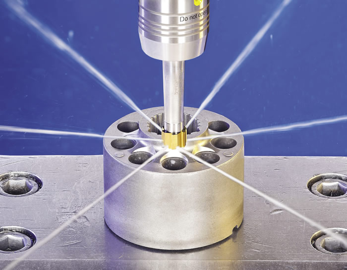

This high-performance reamer from Iscar Metals has replaceable heads, which allow a machinist to quickly renew the tool at the work station. Image courtesy Iscar Metals.

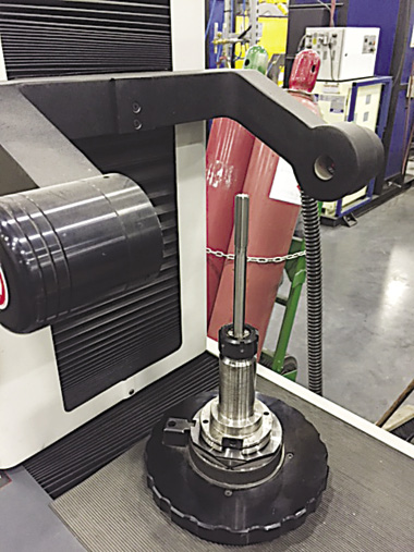

Controlling runout is key to successful reaming. The runout of reamers can be verified with a tool presetter before installing the tool in a machine. Image courtesy C. Tate.

When tolerances are very tight, production quantities large or workpiece materials challenging, a chucking reamer may not provide the necessary performance. These situations call for a more sophisticated reamer. Several manufacturers offer specialized reamers under various names, but all can be considered “high-performance” reamers.
High-performance reamers vary in design but share some common traits. Most are capable of holding extremely tight tolerances due to their being adjustable. Adjustment enables the user to remove radial runout from the cutting edge and, in some cases, alter axial runout. Axial and radial runout are the most common reaming problems.
High-performance reamers often have removable cutting edges, such as blades or inserts. They are easily changed and reset, allowing the cutting edge to be renewed at the point of use. While this type of tool is typically more expensive than the traditional styles with ground flutes, the ability to renew the tool at the machine provides significant cost savings, because they do not need to be shipped to a sharpening service.
Not all high-performance reamers can be adjusted. Some have fixed cutting edges and require special equipment to recondition the cutting edge. These tools and reconditioning them are expensive. However, high-performance, fixed-edge tools can produce a large number of holes before needing to be reconditioned, which makes them economical in high-volume operations as they are typically made of materials like carbide, PCD or PCBN.
High-performance reamers often have some type of guide pad installed. This pad stays in contact with the wall of the hole to support the tool, allowing more aggressive machining parameters by preventing runout and chatter.
