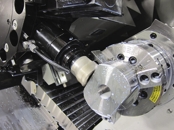

Courtesy of EXSYS Tool
A cutter tooled with general-purpose inserts can be used for a variety of milling operations on a mill/turn center.

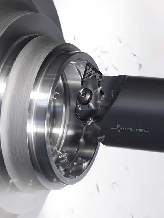

Courtesy of Walter USA
A general-purpose CVD-coated insert used in a boring application offers balance between toughness and wear resistance.
“What’s changed is on the CVD side,” he said. “We’re able to tune the structure of the aluminum-oxide crystals so that we can achieve better heat and wear resistance than in previous generations of CVD. We’ve also developed better post-coating treatments.” One example is a blasting process that creates compressive stresses in the coating surface to improve edge toughness and hold a sharper edge. “This is something we really couldn’t do until the last few years.”
The results aren’t perfect, but they’re pretty darn good. Ludeking said the worst case might be a 20 percent reduction of feeds and speeds compared to a grade that’s tuned for a specific material, but if this saves 10 minutes of setup time on a job that runs 30 minutes, a general-purpose grade is a no-brainer. “With the advancements everyone’s made in coating technology, it makes general-purpose inserts much more feasible.”

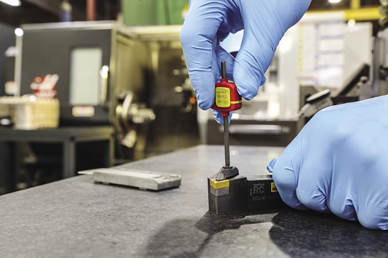

Courtesy of Haas Automation
An operator tightens the clamp on a turning tool prior to loading it in a CNC lathe at Haas Automation.

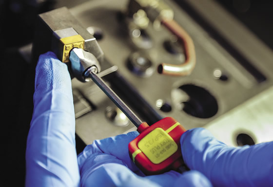

An operator changes a turning insert.
