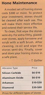

Choosing the appropriate abrasive is the next task. The most common hone materials are Al2O3, silicon carbide, diamond and Arkansas (hard quartzite).
Most cutting tools are manufactured from either HSS or carbide. The old school of thought reserved diamond hones for carbide tools, but the real determining factor in abrasive selection is the required rate of material removal. Expect a rapid rate of material removal when using a diamond hone on HSS cutting tools.
The next step is choosing the grit size. Grits range from coarse to extra fine (Table 1). The determining factor in grit-size selection is the required surface finish. Finish improves as the grit number increases.
Table 1: The determining factor in selecting grit size is the required surface finish, which improves as the grit number increases.
The finer the surface finish required for the cutting edge, the longer it will take to hone the tool. Every tool doesn’t require a superpolished cutting edge, so choose a stone with the appropriate grit.
