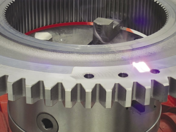

IMG_2733.tif
Courtesy of Coherent
A direct-diode laser from Coherent selectively heat treats the face of a gear.
Coherent’s Parker pointed out that typical heat-treatment parameters include 2kW to 8kW of power, beam size up to 36mm (with work being conducted on a 72mm beam size), process speed of 0.5 to 1.5 m/min., case hardness from 50 to 63 HRC and case depth from 0.5mm to 2mm. “For some unique applications, we have been able to achieve up to 4mm case depth,” he said.
To achieve high hardness, a narrow beam profile is moved rapidly, say, 1 m/min. or faster, over the workpiece, whereas more case depth comes from slowing the traverse speed and heating the part with a wider beam profile, such as a 12mm × 24mm rectangle, to drive the energy deeper into the part, similar to an induction process, Parker said. “You don’t want surface melting to occur.”

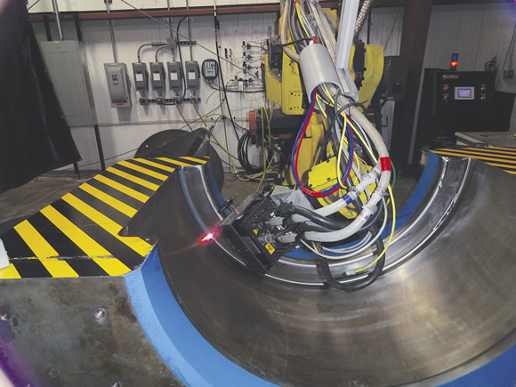

Courtesy of Titanova
Titanova heat treats the inside radius of a large hydroform die to enhance its strength.

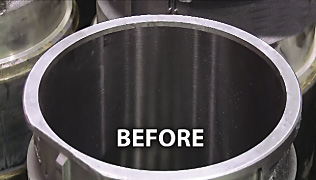

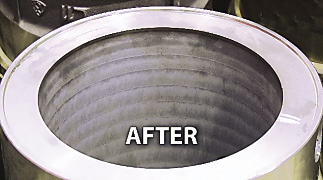

Before%20Laser%20Heat%20Treating.tif
After%20Laser%20Heat%20Treating.tif
Courtesy of Rofin-Sinar Technologies
A large engine cylinder liner before and after being surface hardened with a 6kW fiber-delivered laser. The optical system had a spot size of 10mm × 30mm and used a pyrometer for surface temperature control.

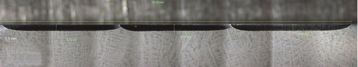

threepasses.tif
Courtesy of Preco Laser Systems
Large-area laser treatment of this steel casting uses three overlapping passes that total 42.70mm wide.

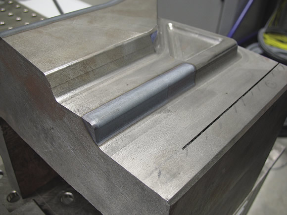

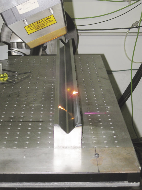

Titanvoa_6.tif
Titanova heat treats the forming radius of a press brake forming die.
Unlike conventional methods, laser heat treating usually doesn’t require an oil or water bath quench to cool a part and bring about the martensite transformation. Instead, the laser process provides self-quenching. Caron-G. explained that after exposure to laser heat, the part’s untreated bulk material acts as a quenching mass, causing a cooling rate as high as 107° C/sec., allowing the hard martensite to form. To ensure self-quenching, he recommends, as a rule of thumb, a 1:10 ratio for the volume of material surrounding the hardened zone. However, a minimum of 1:6 to 1:5 can be appropriate, depending on the thermal conductivity of the material.
After nearly 6 years at Coherent, Parker said he’s only seen one part that could not be successfully heat treated without applying a quenching agent, which was a fine water mist directed on the part behind the laser beam. “The customer basically had two diametrically opposed requirements,” he said. “In that odd case, the customer needed an extremely deep case and it had to have a very high hardness, even at depth.”
He added that laser surface hardening is usually successful unless a heat-treatable part with appropriate carbon content is too thin, so it doesn’t have sufficient mass. “Typically, we don’t pursue heat-treatment applications for parts having an overall or wall thickness of less than an ¼ " or so,” Parker said.
Titanova’s Haake noted external quenchants are only required when through-heat treating thin materials because the material mass would be unable to provide self-quenching. However, such applications are rare, he added.

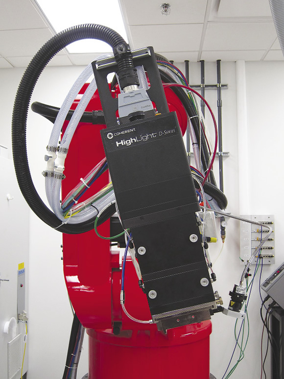

IMG_0625.tif
Coherent’s HighLight D-Series direct-diode laser configured for heat treatment.
With a round spot, beam defocusing is a low-cost approach to static shaping, added Caron-G. By varying the distance between the focusing lens and the workpiece, the beam diameter changes and, thus, the irradiance, he explained. For the heat treating of steel, irradiance from 20MW/m² to 90MW/m² is common.

When one shape isn’t large enough to cover the area that needs to be heat treated, the laser makes multiple tracks along the surface, and, where those tracks overlap, back tempering occurs. This can be a problem because the area where back tempering occurs has a nonuniform microstructure, a lower hardness and less compressive residual stresses, which lead to easier crack initiation at the interface between the overlap and hardened zones, noted Caron-G. He added that back tempering also reduces corrosion resistance, which depends on a high hardness and uniform microstructure. A simple technique called “dot matrix hardening” can harden large surfaces and provide a remedy to most of the technical drawbacks for multiple tracks.

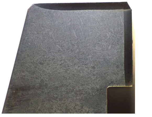

adjacentsurfaces.psd
Two adjacent surfaces on a P-20 tool steel part are transformation hardened to a depth of 0.045" and 0.5" in length.
Although some back temper is inevitable with multiple tracks to ensure the required area is hardened, having a larger beam reduces the overlap percentage. For example, a 6mm circle might overlap from 30 to 50 percent, whereas a 36mm beam might only overlap 10 to 17 percent, said Coherent’s Parker. “Customers who are knowledgeable about heat treating have it in their specification what percentage of the surface, such as 20 percent, is allowed to be overlapped.”
