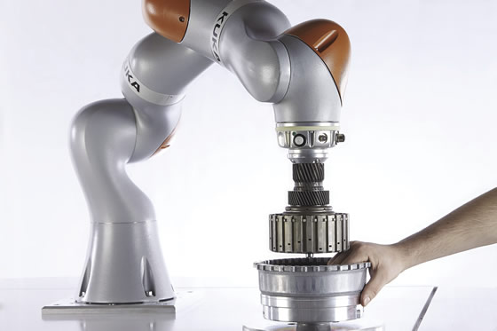

Courtesy of KUKA Robotics
There’s no risk of injury with a collaborative robot. Here a worker safely puts his hand in the path of the robot as it performs gear assembly.

One company with extensive experience in this area is KUKA Robotics Corp., Shelby Township, Mich. Corey Ryan, manager of medical robotics, said collaboration means many things to many people, but its most fundamental definition is about robots helping people.
Nowhere is this clearer than in the medical field. For example, one of KUKA’s partners uses collaborative robot technology to accurately find a predefined point in 3D space, improving control during delivery of radiation to cancer patients. In addition, the Children’s National Medical Center, Washington, D.C., has developed a robotic suturing system to assist physicians during surgical closure, and robots can measure and respond to the force applied by injured patients, making cobots tireless forces for physical rehabilitation.
These same capabilities work equally well in manufacturing. The control and sensitivity of force-sensing robots allows them to perform tasks that standard robots simply can’t do, such as gear meshing. “It’s very difficult,” Ryan said. “Traditional robots do little more than go from point A to point B, and have little regard for what’s in the way. Use one of these for gear meshing and the result is a set of stripped gears.”
By comparison, force-sensing robots, which KUKA calls lightweight, or LBR, robots are able to mimic the human hand. An LBR can feel whether the gears are aligned, give them a little jiggle when they don’t quite fit or adjust the force if there’s any resistance, just like a person would do.
