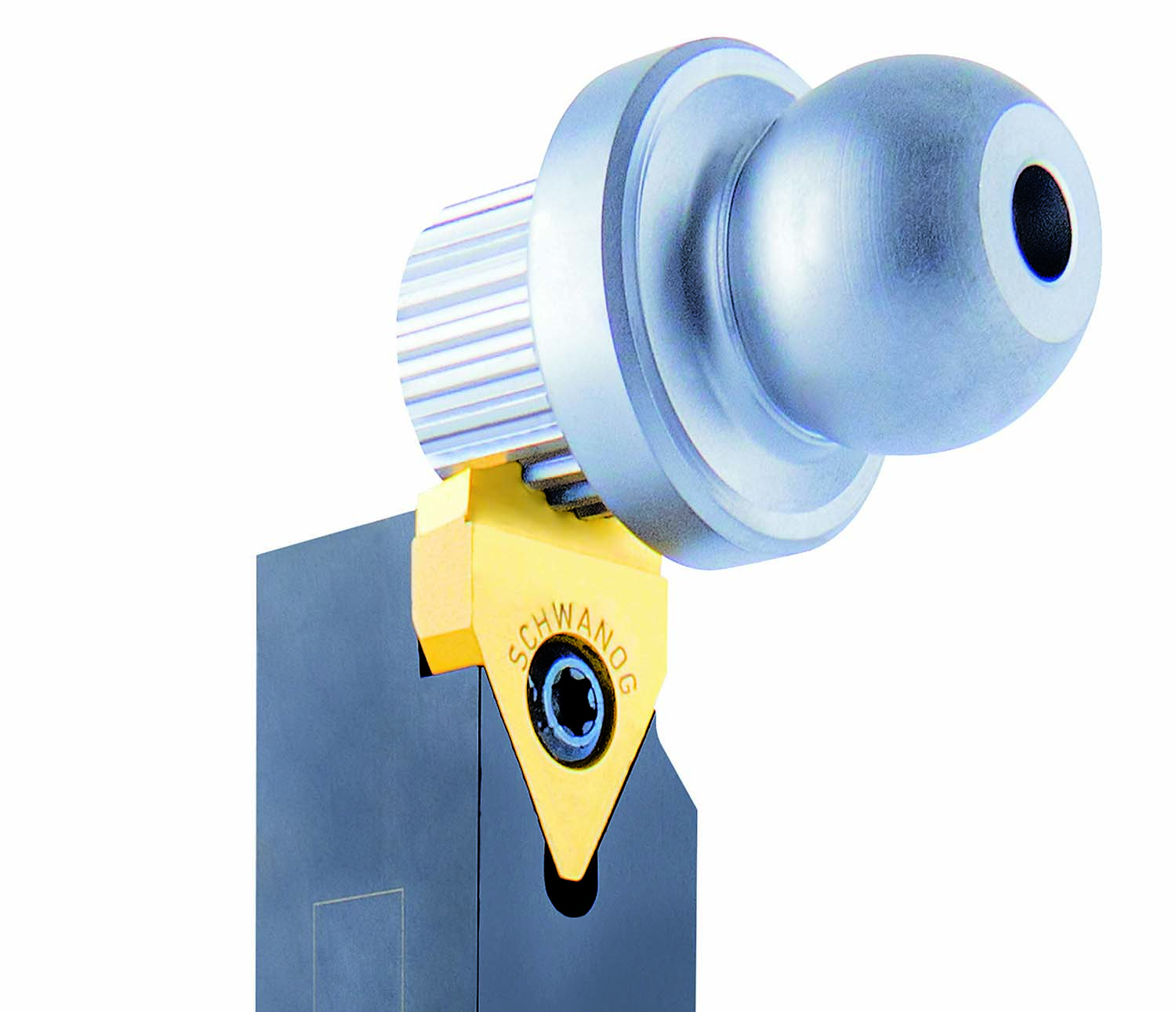

Broaching does not always require a broach machine. The most common broach tools are push broaches used to create square and hexagonal holes and internal keyways. Because the tools are self-supporting, a simple hand-operated arbor press can be used to push the broach through the workpiece. These tools also improve productivity by removing work from a machining center, allowing a machinist to complete the broaching operation while another part is in the machine.
In other cases, special rotary broach tools can be used inside a machining center or lathe. These tools allow the creation of internal polygonal shapes like those on socket head screws or Torx screws while the machine operates. The broach is held in a special holder that enables the broach to rotate at the same speed as the part, and the machine simply pushes the broach forward to create the shape. Many different broach tools are available for modern CNC machines that permit unattended operation of machines and eliminate the need for secondary broaching.
