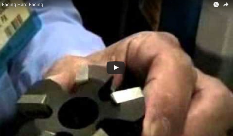

Greenleaf Corp. introduced its WG-300 ceramic composite  tool material about 25 years ago. The ceramic matrix  is reinforced with silicon-carbide "whiskers” that boost  toughness. Initially applied in the relatively constant cutting  conditions of turning operations, the composite tools  provided a significant increase in productivity when roughing  aerospace alloys. Shops are now using WG-300 tools in hard  milling operations.
Tom Mahusky, shop supervisor at Cleveland Hard Facing  Inc., Cleveland, is familiar with machining hard materials."We've dealt with hard materials for the past 20 years, so we've learned a lot of tricks," he said. A recent job put that knowledge to use. It involved hard  facing and machining hammer components used to forge  titanium parts. To enable the four roughly 20" x 16" x 8" L-6  tool steel hammers to survive the high temperatures and  pressures of the forging process, hard facing specifications  called for application of a 1/8"-thick layer of low-carbon steel  followed by a 7/8"-thick layer of nickel-base Hastelloy and  finally a 1/4"-thick layer of Waspaloy, another nickel-base  material. Cleveland Hard Facing applied the layers using the  metal-inert-gas arc welding method. After the welding was completed, Mahusky rough milled  the parts. The hammers had pyramid-shaped tapered faces, so  the cutting tool had to machine through all of the weld layers  as it descended the sloped sides of the hammers. "Hastelloy  and Waspaloy don't like to be cut," Mahusky said. The alloys  are not unreasonably hard; "only going in the low 30s [HRC]  as welded," he said, but added that when machined, the  materials "will workharden just like a 300-series stainless.”  This increases the hardness by 10 HRC. Without a large-capacity  CNC mill in his shop, Mahusky used a 7 1/2-hp manual  vertical mill to rough the welded overlays. Running at 1,400 sfm and a feed rate of 18 to 19 ipm, he took DOCs of up to  0.100" with a 4"-dia. Excelerator milling cutter tooled with  four round, negative-geometry WG300 ceramic inserts. "A  positive insert is not strong enough to withstand roughing  in this case," he said.  Mahusky worked with Denny Carpenter, a Greenleaf sales  and service engineer, to set up the operation. Carpenter made  sure the machining parameters were "within the capabilities of the machine, the part and the rigidity of the setup," Mahusky said. "It depends on the configuration  of the part. If it's big and overhanging, you  need as rigid a setup as possible. You have to take  all that into account when milling with ceramics."  Machine stiffness is crucial. "Even if you are  taking small finishing cuts, you still need a rigid  machine," he said. "If you are going to take bigger cuts, it's not just a high-speed spindle you need—you must have rigidity and torque at the spindle."  Mahusky left 0.020" finishing stock on the hammers  and subcontracted finish machining to job  shop Quality Industries Inc., also in Cleveland.  Quality Industries finished the hammers on an  ACRA FVMC-610 CNC vertical machining center using  a 1.5"-dia. positive-geometry Excelerator endmill  tooled with three RPGN-43 inserts. The tool ran at  3,800 rpm, 80 ipm and a 0.020" DOC. Vice President  Jim Kaplan said the light DOC produced a minimal  flow of chips. Greenleaf's Carpenter added that  "compensating for the chip thinning effect is 100  percent crucial” in maximizing tool life in the operation.  Mahusky said he would not consider hard milling without  ceramics. "Not today, when you know what you know, and  you remember how you did it back when. You'd get carpal  tunnel syndrome just changing inserts when it was carbide.”  He added that according to a sales representative for the  weld materials applied to hammers, some shops don't attempt  to mill the hard welds and grind them instead. "That's  gets pretty expensive because you are getting into wheels,  too," Mahusky said.
