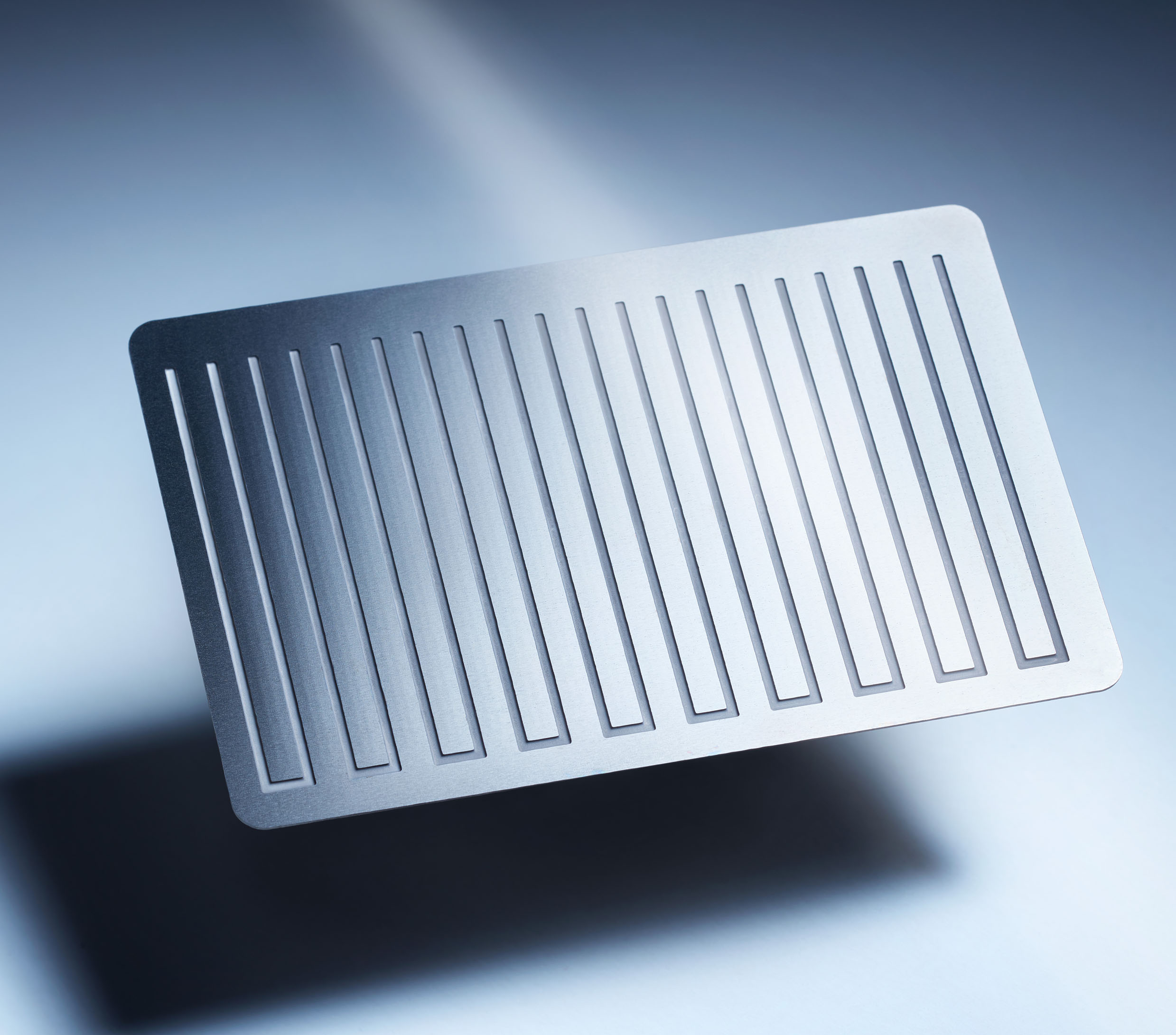

In place of the coiled pipe passing through a chamber, in plate heat exchangers there are instead two alternating chambers, usually thin in depth, separated at their largest surface by a corrugated metal plate. The chambers are thin as this ensures that most of the volume of the liquid contacts the plate aiding heat exchange.
Such heat exchange plates were traditionally made using stamping or conventional machining like deep drawing, but more recently photo-chemical etching (PCE) is proving itself to be the most efficient and cost-effective manufacturing technology available for this exacting application. Electrochemical machining (ECM) is another alternative technology and can make very precise parts at volume, but this process requires very high levels of up-front investment, is restricted to conductive materials, uses a lot of energy, design, and fabrication of tools is difficult, and corrosion of the workpiece machine tool, and fixtures re a constant headache.
Often both sides of plate heat exchangers contain extremely complex features which are sometimes beyond the ability of stamping and machining but are easily achieved using PCE. In addition, PCE can produce features on both sides of the plate simultaneously saving significant amounts of time, and the process can be applied to a range of different metals including stainless steel, Inconel 617, aluminum, and titanium.

One key area in which plates are used is in fuel cell applications made from stainless steel, aluminum, nickel, titanium, copper, and a range of exotic alloys.
It is found that metallic plates in fuel cells offer numerous advantages over other materials. They are at the same time extremely robust, provide excellent conductivity for better cooling, can be made extremely thin using etching producing shorter stacks, and there is no directional surface finish within the channels. The plates can be profiled and channels generated at the same time, and as mentioned, there is no thermal stress induced in the metal ensuring absolute flatness.
The PCE process ensures reproducible tolerances on all critical plate dimensions, including gas track depth and manifold geometry, and can manufacture parts to stringent pressure-drop specifications.
Other sectors that have applications using chemically etched plates include the linear motor, aerospace, petrochemical, and chemical industries. Once manufactured, the plates are stacked and diffusion bonded or brazed together to make the core of the heat exchanger. The finished heat exchangers can be up to six times smaller than traditional “shell and tube” heat exchangers delivering excellent space and weight benefits.
Heat exchangers produced using PCE are also extremely robust and efficient and can have a pressure capability of 600 bar while accommodating temperatures ranging from cryogenic to 900 degrees C. More than two process streams can be incorporated into a single unit and the requirement for piping and valves is greatly reduced. Reaction and mixing can also be incorporated into the plate heat exchanger design, cost-effectively increasing functionality in a single unit.
