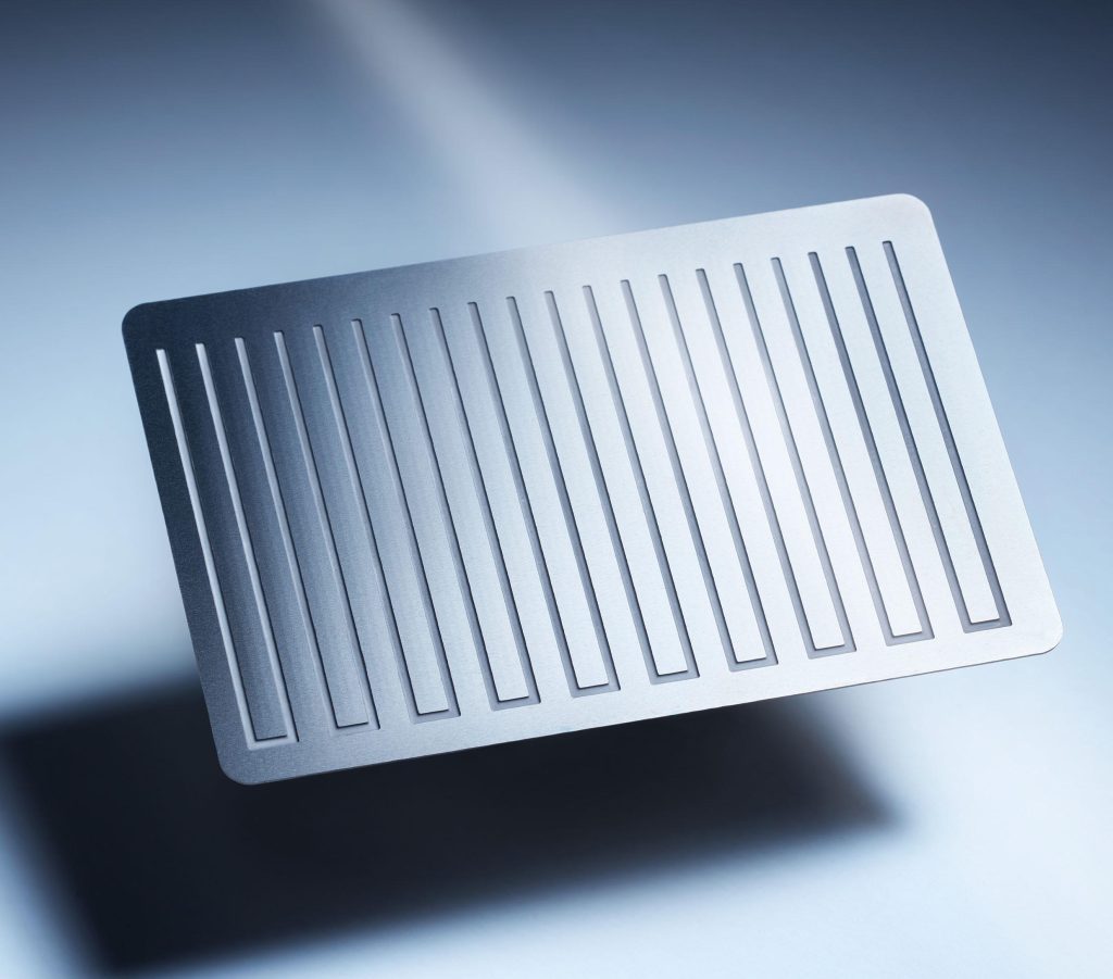

As a precision metal part fabrication process, PCE is well suited to the production of some of the critical EV components such as bipolar plates used in fuel cells, making them in a cost-effective, precise, and speedy fashion, while at the same time stimulating innovation by providing design freedom
PCE is a subtractive metal processing method that involves selectively removing metal from a flat metal surface with the use of a chemical reagent to produce desired shapes or patterns. The process captures CAD drawings in transparent photo tools, then converts them into a negative image which is developed on a photoresist covering the metal surface.
The process has several benefits, as it produces intricate parts, with complex patterns or varied opening profiles in thin metallic sheets ranging from dozens of microns to around 2 millimeters thick. It outperforms other methods, like traditional metal cutting and stamping.
Etching can be employed to work on a wide range of metals, from stainless steels to copper and nickel to aluminum, not forgetting clad materials and shape memory alloys. Every metal has its etching traits, and the expertise of your chosen PCE specialist will tailor etchant chemistries to the precise metal being processed to get optimal performance and excellent results.

PCE provides manufacturers with a viable means of producing complex components, such as bipolar fuel cell plates, with noteworthy benefits.
Utilizing digital tooling instead of hard tooling, PCE offers the significant benefit of being cost-effective and allows designs to be readily customized. This is hugely advantageous in terms of optimizing without incurring excessive expenses.
The process facilitates quick scale-up from a prototype to high-volume production, with almost no limit on the complexity of components - ideal for fuel cell plates that must be free of imperfections to successfully bond the stack. It does not affect the temper or properties of metals, is suitable for all grades of steel, and accuracy is ensured at ±0.025 mm; all done in days instead of months.
PCE is a versatile technology that allows for the simultaneous removal of metal. This enables complex patterns and channels to be etched to an accuracy of 0.025mm on both sides of the plate, with features such as headers, collectors, or ports easily achievable at no extra cost.
At the micrometal Etching Group, we can also produce these components in certain exotic and hard-to-machine metals, such as titanium, for lighter weight and superior protection from corrosion in high-temperature fuel cell applications.
The PCE process is a compelling option for the manufacture of complex sheet metal parts across multiple applications, due to its versatility. This approach can stimulate innovation, removing barriers inherent in traditional manufacturing technologies and hence providing design engineers with more freedom.
PCE offers flexibility and cost-effectiveness for the production of bipolar plates, enabling the speedy manufacture of various designs. Additionally, with the capability to etch stainless steel, nickel-based alloys, copper, aluminum, titanium, and other alloys, its potential is amplified.
