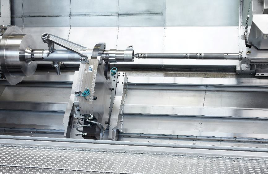

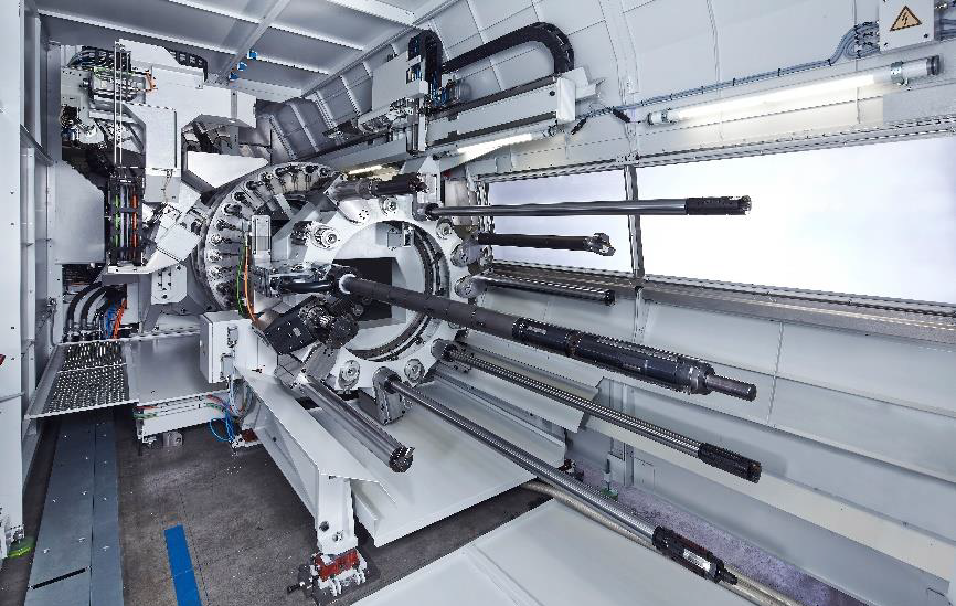

​ An automatic tool change with long tools takes place using a pick-up magazine and prismatic tool changer.
Top: The Millturn machine concept combines all technologies in one complete machining center - including deep hole drilling.  Above: An automatic tool change with long tools takes place using a pick-up magazine and prismatic tool changer.

WFL develops special tool accommodations - partly to ensure stable tool clamping, but above all to deliver the correct coolant pressure and volume directly to the cutting edge of the tool. In a fully automatic sequence, it is also possible to change long deep-hole drilling tools. With WFL, an automatic tool change can be performed using a pick-up magazine and prismatic tool changer.

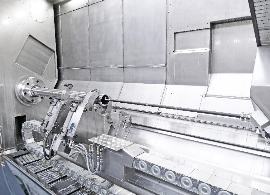

A precise pilot hole forms the basis for good results in deep hole drilling, whereby WFL forms a pilot hole directly in the workpiece to guide the long, unstable drill. These pilot holes are produced with an oversize of < 20μm to a depth of 1.5x the hole diameter. The utmost precision is guaranteed, thanks to workpiece measurement and WFL measuring cycles.
When producing centric holes, the workpiece and tool can be rotated in opposite directions to further improve the quality in terms of hole center deviation.

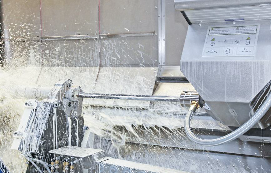

Coolant pressure versus coolant volume
Millturn machines offer different options when it comes to the coolant supply. For small hole diameters, for example, the cooling lubricant is fed directly through the milling spindle at a coolant pressure of up to 200 bar, while the coolant volume is conversely decisive for larger hole diameters. It is fed automatically to the tool accommodation via a bypass line. The enclosed working area of the WFL machines is essential with such high coolant pressures and volumes.
