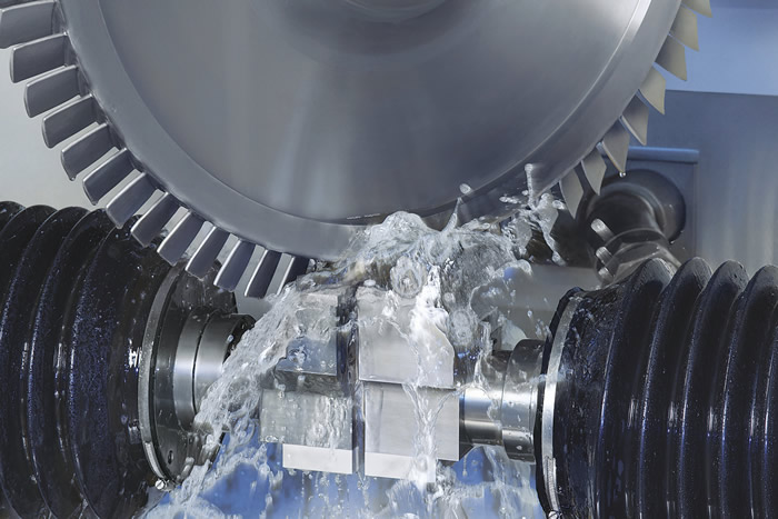

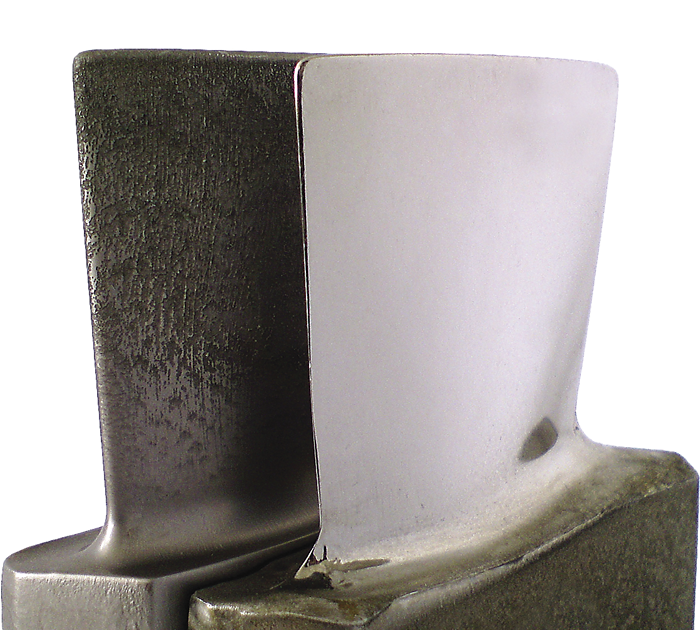

Pulsed electrochemical machining a jet engine blisk imparts a surface finish that requires little or no polishing (below, right blade). Images courtesy EMAG USA.
