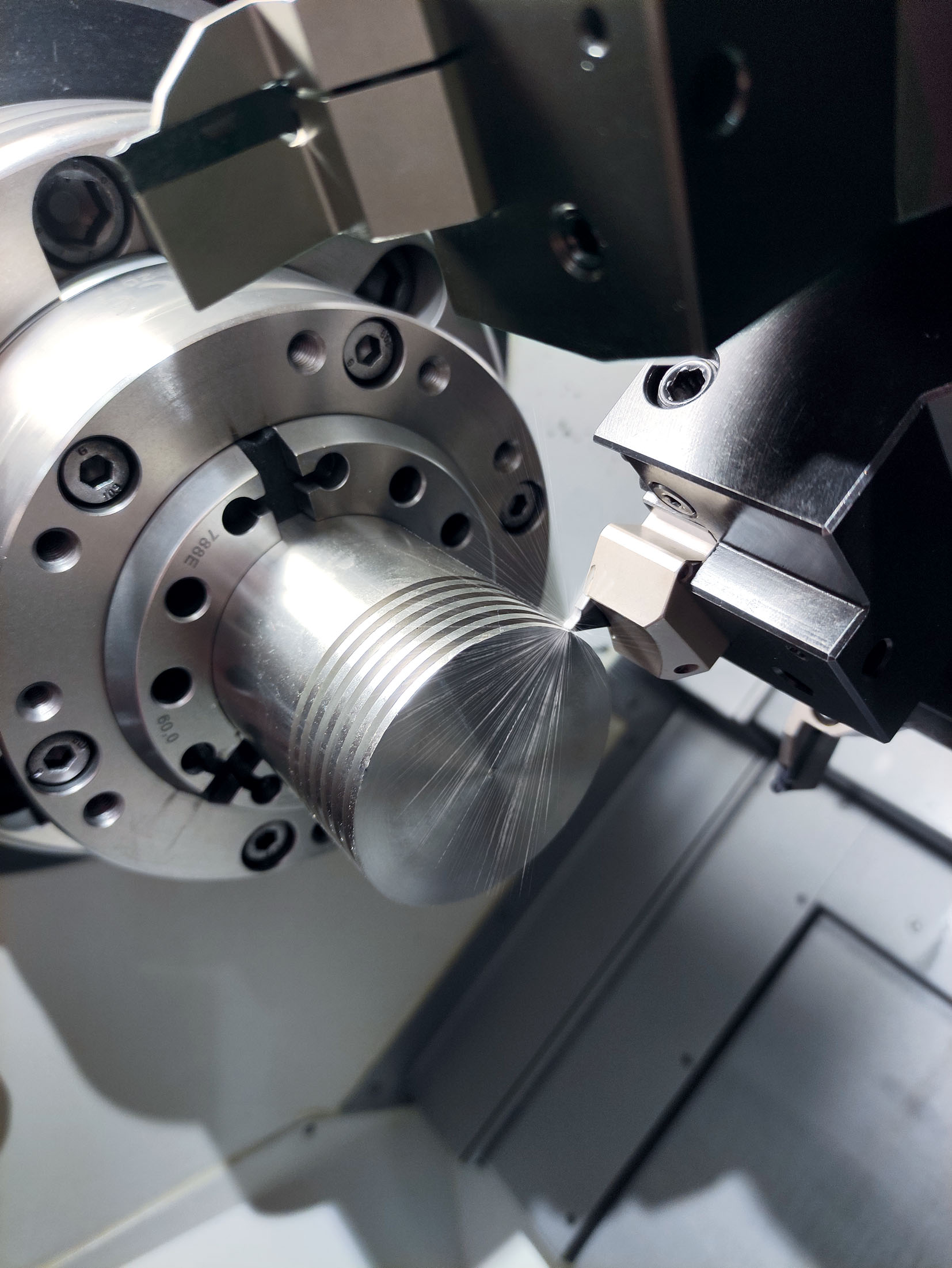

Parting off is like many other important manufacturing processes: the devil is in the detail. There is so much to be considered in this important turning operation. After all, it plays a decisive role at the end of the turning process, such as when a lot of added value has already been invested in the workpiece. In addition, to feed rate and cutting speed, groove width, and cutting depth, chip evacuation is one of the factors that require particular attention. And finally, the right tool and its holder determine the quality of the components and process efficiency.
Diversity of variants reflects application experience
Anyone who underestimates the complexity of grooving and only uses individual parameters for their decisions will quickly pay dearly. This also applies to parting off and profile grooving. Suppliers with application experience, consultancy expertise, and fast-response service can boost processes and productivity. Increases of 400% are achievable.

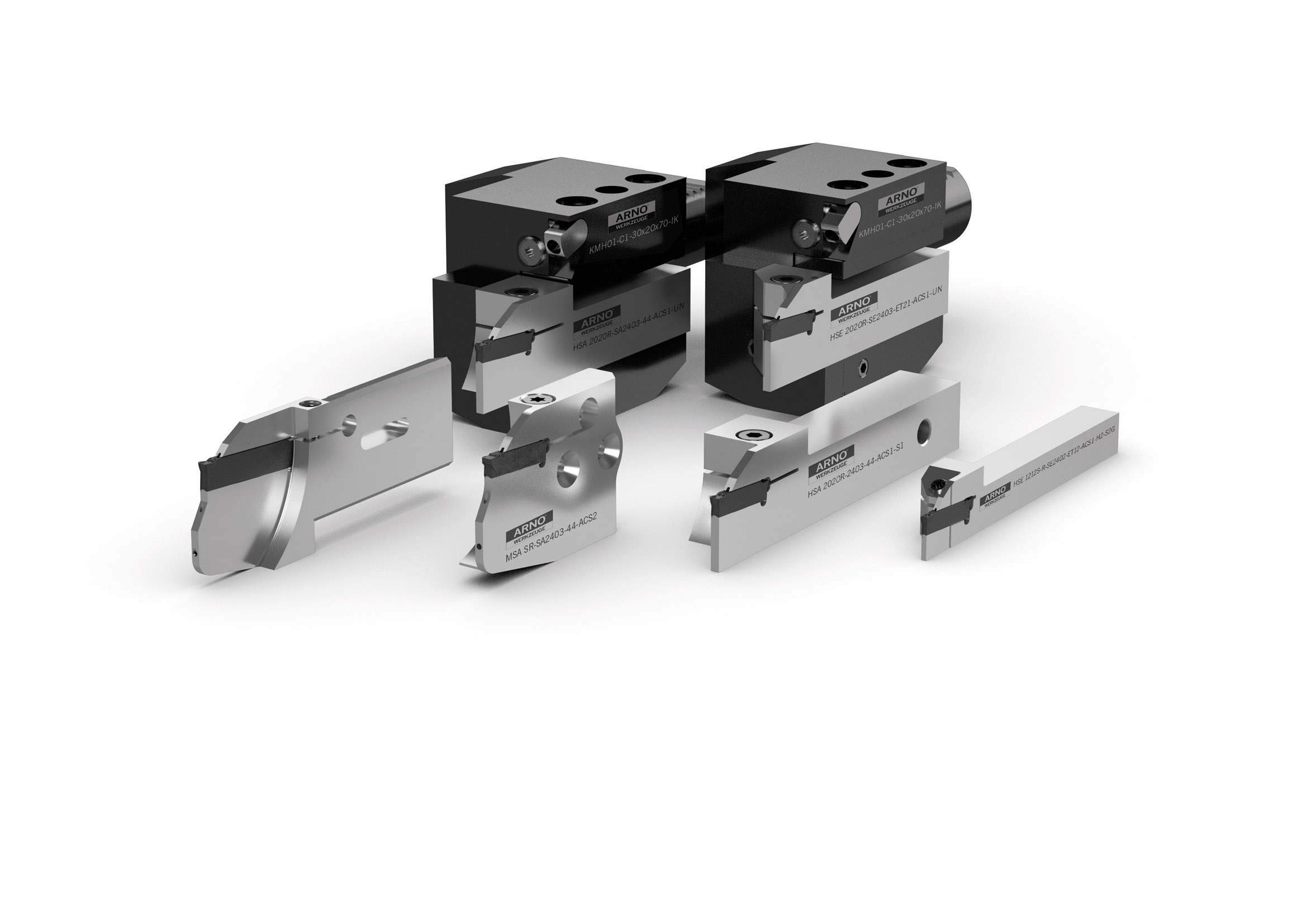

Karl-Heinz Arnold GmbH in Ostfildern near Stuttgart has made a name for itself as a tool manufacturer with considerable application experience and consultancy expertise. The family-owned company known as ARNO Werkzeuge offers innovative parting-off and grooving systems with a diversity that reflects the company's vast experience. The double-edged SA grooving system with groove widths of 1.5-10 mm is suitable for parting off and grooving at cutting depths of up to 140 mm in diameter. Together with many modules, holders and blades, the parting-off tool is always optimally adapted to the situation. In addition, the manufacturer offers a wide range of machine-related flange mounted holders for many machine brands.

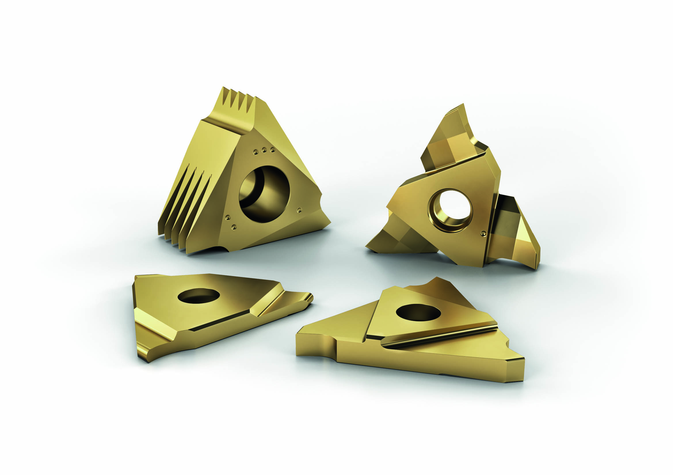

The manufacturer has developed a third tool especially for parting off small components with small diameters. The three-edged ATS system can be used by turning operators for a wide range of short, precise grooves. Here, the manufacturer focuses on proven substrates and coatings. A countersunk clamping screw clamps the tool rigidly and precisely to the ground contact surface. ATS offers a large cutting depth of 6.5 mm compared to its compact dimensions. Groove widths start at a very narrow 0.8 mm and extend to 6 mm. When it comes to profile grooving inserts, contours up to 20 mm long can be mirrored on one insert. Since the system is so compact, users also use the ATS system for applications in shoulder grooving or Swiss-type machining. Variants with the peripheral ground and sharp flutes are ideal for operations with low cutting pressure on thin-walled parts. The ATS system can be used as a standard application for finish grooving O-rings or retaining rings in a single operation.

If a tool manufacturer is a serious supplier and does not merely want to sell products to its customers, he will also find custom and application solutions to improve processes and increase productivity. In our example, the manufacturer ARNO Werkzeuge presents innovative products that demonstrate precisely this philosophy. For example, customers are delighted with the AWL/AFC quick-change tooling system. Two-part carrier tools make for quick tool changes that even unskilled personnel can easily perform safely.
AO SA-SE
With its SA and SE range, ARNO Werkzeuge offers innovative grooving systems whose diversity reflects the company's extensive experience. Source: ARNO
Only the front part of the carrier tool is removed. The rear part remains on the AWL sliding head to act as a stop. This ensures that the zero point is always constant. The two holder parts are joined by a connector system with an O-ring to secure the front holder part and prevent it from accidentally falling into the chip tray. In addition, a floating mount compensates for angular offset to ensure a high level of precision when changing tools.

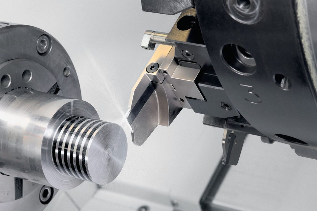

Intelligent cooling saves money when grooving
Another example of the manufacturer's user-oriented mindset is the patented ACS (Arno Cooling System), which was specially developed for parting off. In the ACS 2 variant, the coolant channel at the insert seat is coupled with a second coolant jet from the bottom onto the tool flank. The coolant channel is a 3D printed variant and has an optimized-flow, triangular end that supplies coolant across the full width of the insert right through to the edge. Users report tool life lasting up to three times longer.
The additive process allows the production of channels without right angles. This method also permits the production of a flow-optimized triangular-shaped outlet that shapes the coolant jet to obtain maximum cooling effect with minimum consumption. It also allows additional optimizations: for example, the groove width can be reduced by one millimeter. This one millimeter less in width on the parting-off tool means a reduction in annual costs of more than €400,000 with 20 machines operating on 220 machine days.
