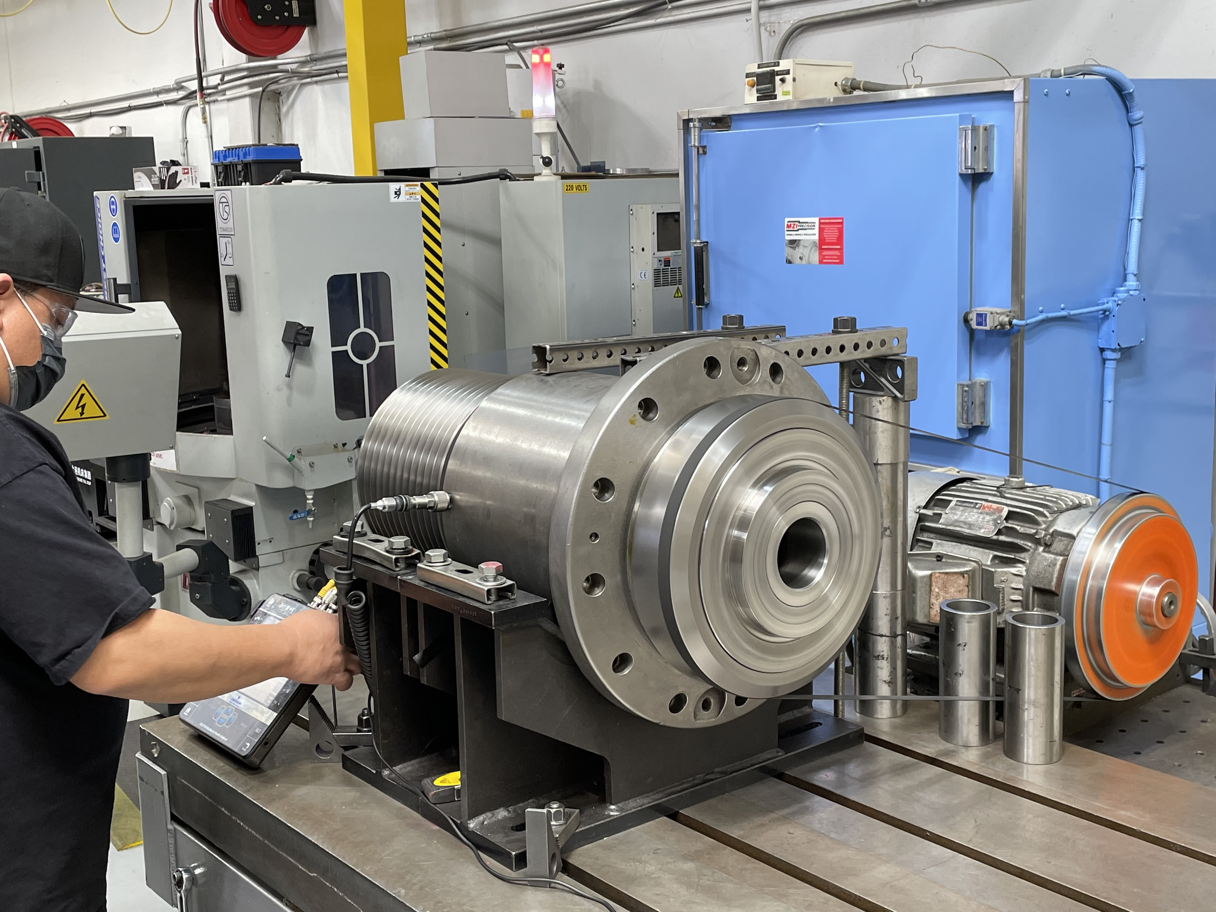

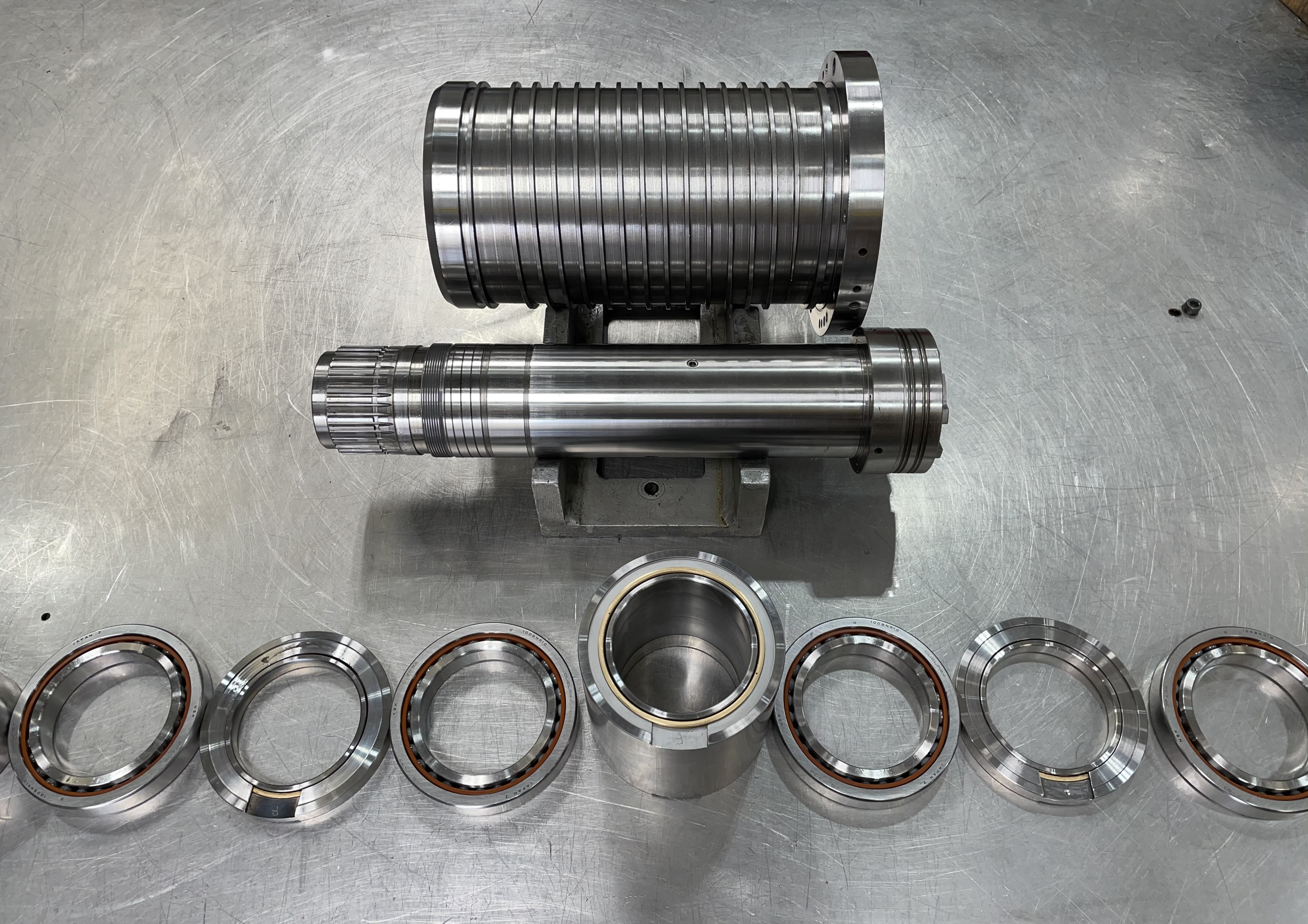

While most spindle rebuilders only take minimal time to wipe parts before inspection, during disassembly the rebuilder cleans and polishes each component with emery cloth to clearly reveal even minute imperfections. Even the nuts are removed, polished, and then tested to ensure proper fit.
The next step is detailed measurement and documentation of every part of the spindle’s shaft and housing geometry. Micrometers are used to take detailed size measurements, runout is checked using 0.00005” dial indicators. The shaft bearing shoulders are then checked to see that they are true and perpendicular. The housing bores are checked for size, alignment and shoulders squareness. MZI Precision also takes video, followed by digital photographs of each part during the disassembly process.

Collins also appreciates the spindle rebuilder’s use of only high-grade replacement components and bearings, which help to increase equipment reliability and lifespan. The rebuilder utilizes aerospace-grade bearings that are ABEC rated 7 or 9, the highest classification. Depending on the requirements, ceramic bearings are often recommended despite the nominal additional cost, due to longevity and higher running speeds.
