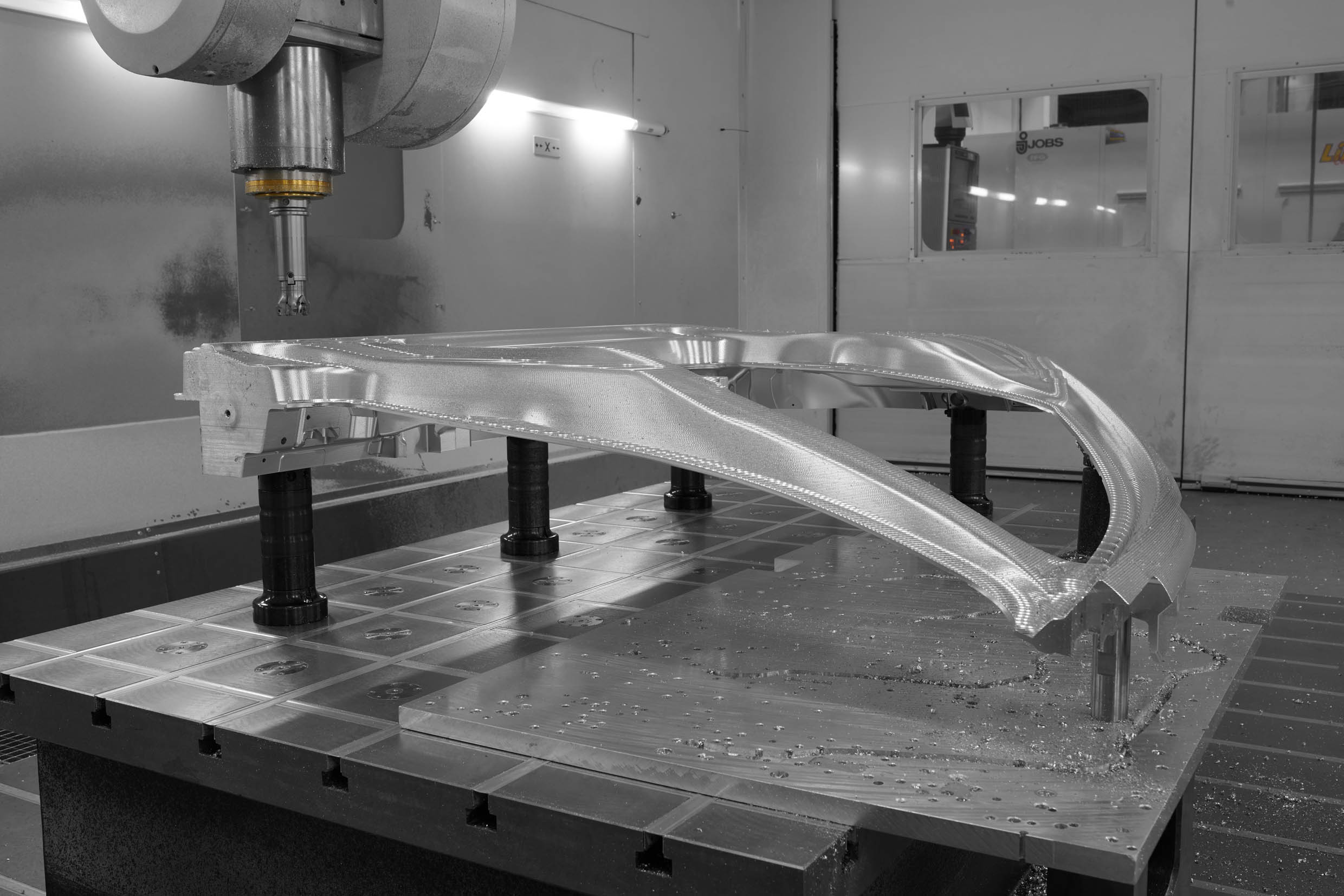

With the intelligent zero-point clamping technology from AMF, further aspects that go beyond the clamping plate can be accomplished, too. This means that the roof element can be securely clamped for five-sided  machining.
With the intelligent zero-point clamping technology, the roof element can be securely clamped for five-sided machining.

The raw aluminum blocks for the individual parts, such as the floor assembly, side parts, roof, boot lid, and wheels must be manufactured with corresponding precision on the giant gantry milling machines and clamped precisely beforehand. Two work tables with dimensions of 1300 x 2000 mm and two with 1300 x 1000 mm as well as another one are used in the Jobs LinX machines. They are equipped with 50 or 20 K10 zero-point installation clamping modules from AMF at intervals of 200 millimeters.
"With the defined grid pitch, each work table offers us the greatest possible flexibility in positioning the elements," said Goth. And if a clamping point should be outside the grid or even outside the plate, that is not a big challenge. "With clamping rails, multiple clamping bars, or other numerous clamping elements from AMF, we can reach every point that we need for safe clamping."

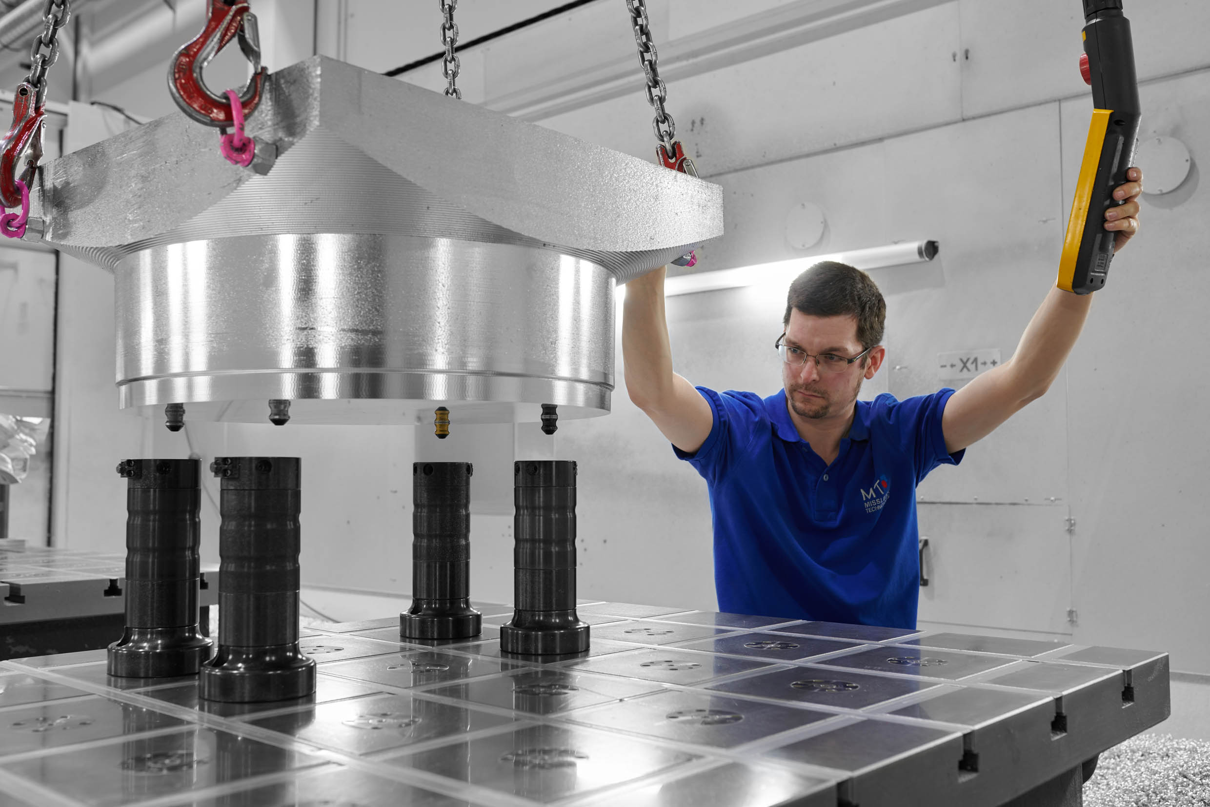

The system is just as easy and logical as Lego
The workers place modular spacer elements on top of each other on the work tables with integrated zero-point clamping modules and cross-T-slots until the block or the blank reaches the appropriate height so that five-sided machining is possible. The clamping can be planned just as easily as with a Lego building kit.
The AMF range of connecting, construction, and counterbalance elements as well as various adapters is almost inexhaustible. The upper interface to the workpiece is again a mechanical zero-point clamping module K10, which positions and clamps the M8 or M10 pull-studs screwed into the workpiece in a process-reliable manner.
"The system is just as easy and logical as Lego. Everything fits together and can be positioned quickly and precisely thanks to the zero-point clamping technology,” said Christian Vogel from AMF, who is currently in charge of the Ingolstadt-based company.
The clamping modules in the work table are opened hydraulically at an operating pressure of 60 bar. Each one pulls in the correct pull-stud with ten kilonewtons and then holds it tightly with 25 kilonewtons. Since the modules are intelligently designed and carefully manufactured, they can do this with a repetition accuracy and precision of less than 0.005 millimeters (<5 µm). And since they are mechanically locked by spring force and tensioned without pressure, the pressure lines are removed after the clamping operation.

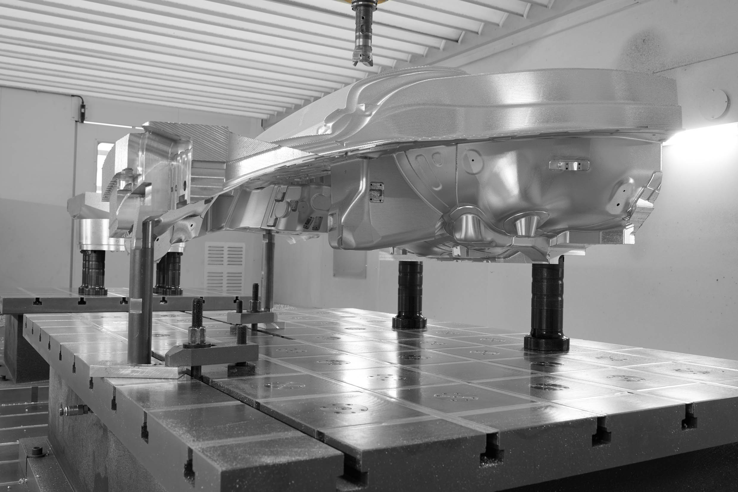

Collision-free 5-side machining thanks to direct clamping
For direct clamping, the holes necessary for the pull studs are made directly in the unmachined part or aluminum block. The engineers already allow for that. To ensure that subsequent processing takes place without any interfering contours and is collision-free, AMF makes CAD data freely available in many common formats for all of its products. "This is an indispensable aid beforehand," said Vogel.
