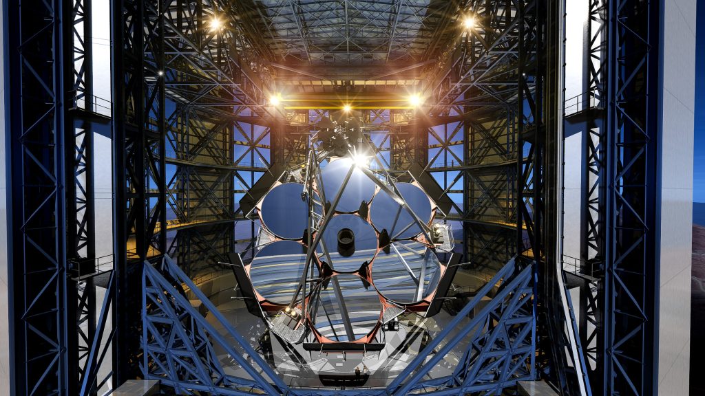

Imagine a beam of light traveling unimpeded for 13.5 billion light years, only to get deflected and distorted just before being captured by a telescope. That is something the builders of the Giant Magellan Telescope are working hard to avoid.
Photos courtesy of Giant Magellan Telescope Organization unless otherwise indicated
The GMT is poised to be the first “extremely large telescope” to begin operations, with a first-light target date of 2023, according to the Giant Magellan Telescope Organization Corp., Pasadena, Calif. The GMT will have an effective diameter for diffraction of 80' (24.5m) and probe the visible universe from an elevation of 8,200' (2,500m) at the Las Campanas Observatory in Chile.
“What we don’t want to happen when that light finally gets in front of the telescope close to its dome is to get vastly distorted by hot air trapped inside the dome,” said Patrick McCarthy, vice president of operations and external relations for GMTO.
He added that the telescope has adaptive optics that can fix some of the image distortion, but a much better approach is to never distort or otherwise damage the image. To help achieve that by ensuring the airflow coming up the mountain and approaching the telescope enclosure doesn’t create any ripples in the atmosphere, GMTO is working with Boeing Research & Technology.
Therefore, the temperature variations of the air along the path of the light through the telescope needs to be maintained to ±0.1° C, McCarthy noted. “It really requires that we flush the air,” he said, “and do so in a way that doesn’t create a lot of turbulence. A great thing about working with the Boeing people is that they understand turbulence to a very deep level. Their job is dealing with turbulence over airfoils.”
