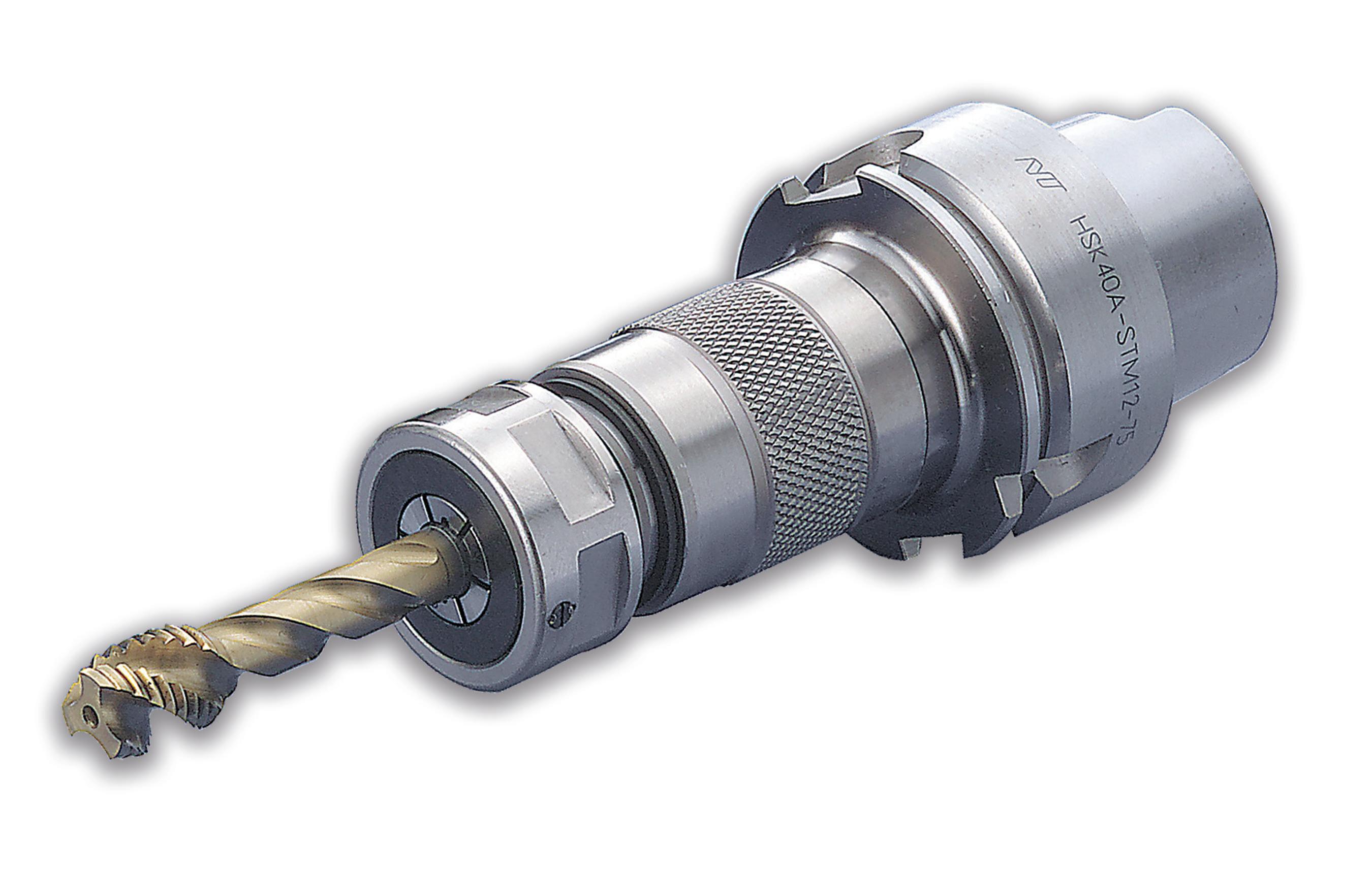

The STM holder allows users to quickly adjust the projection length of the tap by turning the guide ring on the holder. Image courtesy of NT USA

Special Tap Collets
In addition to the tapping tools themselves, people engaged in rigid tapping should consider carefully what they choose to hold the tools. In some cases, regular ER collets are used to hold taps. These collets have a cylindrical hole down the middle, so they don’t provide sufficient gripping force when holding the square-shaped tap end to prevent the tap from slipping as the machine spindle rotates. The result can be tap breakage, chipping and gauging problems, Ford said.
Tiptop tapping
The SynchroFlex tapholder permits a small amount of axial compensation to reduce thrust forces on the tap. Image courtesy of Tapmatic
The correct choice for rigid tapping, he said, is an ER tap collet. Instead of a cylindrical opening, this type of collet has a square opening sized to match the square tap end so it can hold the tap firmly enough to prevent slipping during the tapping process.
“If you are diagnosing a tap problem,” Ford said, “particularly breakage, one of the first things you ask is whether they’re using a tap collet.”
Even if they know about ER tap collets, Stewart said some shops decide not to use them. One reason is that they’re somewhat more expensive than standard ER collets. Additionally, job shops may not have tight tolerance requirements like in the automotive and aerospace industries, so a little slippage could be acceptable. And if a shop isn’t tapping large numbers of holes, it may be able to check every one with a thread gauge.
However, “a company that makes thousands of holes a day cannot check every one,” Stewart said. “So they want the assurance that the tap is not going to slip.”
While a tap can’t slip in an ER tap collet, he said the collet itself can slip during rigid tapping. And if the collet slips, the tap slips despite being held firmly by the collet.
To prevent this, NT USA offers a rigid tapholder called the STM. Instead of being held by the collet, the square tap end is held firmly by a square opening in the STM itself. On the downside, a tap held by the STM probably will break instantly if the threaded end becomes jammed in a workpiece. But as Stewart explains it, the alternative could be undetected slippage of an ER tap collet that results in many bad parts being machined.
“If the tap breaks, the machine would detect that, so there may be one bad part,” he said. “But if the tap keeps slipping, (a shop) may need to scrap hundreds of
workpieces.”
STM holders also allow users to easily adjust the projection length of the tap by turning an outer guide ring. This is helpful in situations where manufacturers regrind taps to save money instead of replacing them after each job. Firms that do this, however, always need to have the same tap projection length from the gauge line of the holder.
“If they grind it down 2 mm (0.08″), they need to make it stick out 2 mm longer to make it the exact same gauge length,” Stewart said. “If you use a collet with the square built in, you drop the tap into it, and you can’t adjust anything. But our square moves up and down inside the holder, so you can adjust the tap projection length to compensate if you’re grinding it down.”
