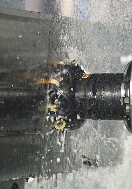

Courtesy of Sandvik Coromant
A Sandvik Coromant CoroMill 300 cutter tooled with round inserts facemills titanium.

Sandvik Coromant Co., Fair Lawn, N.J., offers the CoroMill 300 series of milling cutters with round inserts for roughing and semifinishing titanium alloys. Round inserts are recommended because they provide chip thinning similar to a cutter with a 45° lead angle, which increases the mrr. In addition, as shown in Figure 1, the length of a round insert’s cutting edge (1a) is 75 percent longer than an insert with a 0° lead angle and 24 percent longer than one with a 45° lead angle, so the wear on the round insert spreads out over a longer length. This extends tool life.
Figure 1: The length of a round insert’s cutting edge (bottom) is 75 percent longer than an insert with a 0° lead angle (top) and 24 percent longer than one with a 45° lead angle (middle), so the wear on the round insert spreads out over a longer length. This extends tool life.
The catalog item number of a popular cutter is RA300-102R38-16H:
Cutter diameter, Dc = 3.386 " (D3 = 4.0 ")
Number of inserts, zn = 8
PVD-coated carbide grade is GC1030 (ISO P30, S15)
Effective (true) rake angle, γoe = 20°
The catalog item number of the round insert for the cutter is R300-1648E-PL 1030:
R300 = product family
16 = insert size, IC (diameter of inscribed circle) = 16mm (0.63 ")
48 = insert thickness, 4.8mm (0.189 ")
E = insert tolerance class, ground edge
PL = positive insert geometry
1030 = carbide grade
