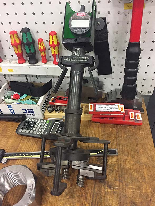

This indicator-type gage is used to measure ID threads, such as those
in large-diameter nuts for large gas turbines. Image courtesy of C. Tate.

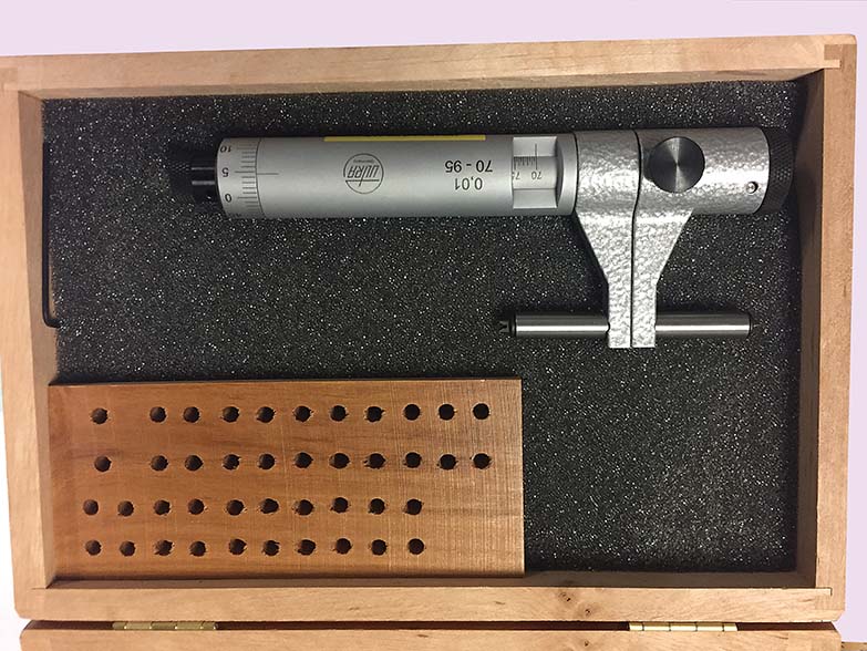

In addition to measuring ID threads, Mitsubishi Hitachi Power Systems Americas will use this set
of thread mics to develop a manufacturing process for some gas turbine hardware. Image courtesy of C. Tate.

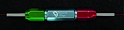

Hard gages, like plug and ring gages, also known as GO/NO-GO gages, are the most common, especially in production environments. These gages let the user determine if the threaded element is good or bad. The two-part gages have one element that is slightly smaller than the minimum thread size and another that is slightly larger than the maximum size. When the thread is sized correctly, the GO gage will fit the threaded part but the NO-GO will not. These gages are fast, accurate and easy to use.
Unfortunately, GO/NO-GO gages do not provide any numeric values, which can make setup and adjustment of a machine tool difficult. In cases where numeric values are needed, another type of thread gage must be used.
In terms of simplicity, GO/NO-GO systems that utilize an indicator are probably the next best thing to plug and ring gages. Like hard gages, indicator-based gages allow a user to quickly determine good from bad. However, they also provide a numerical deviation from the ideal, so the user can make necessary adjustments to the machine tool. Indicator-based gages are set with master gages, which define upper limits, lower limits or nominal thread sizes. Using upper- and lower-limit masters to set the gage is the most desirable method because it eliminates the possibility of errors.
Indicator-style gages and the masters that go with them are expensive compared to other thread gages. Fortunately, they can measure a range of sizes, which makes their cost a little more palatable.
Indicator-style gages, like hard gages, are suitable for production environments. However, they require more training and adherence to proper setting procedures to ensure reliability.

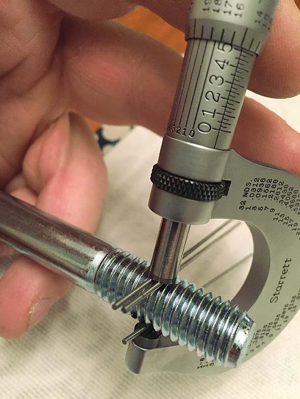

The three-wire method requires the machinist to place three wires into the thread trough
so that a standard OD mic can measure across the wires. Image courtesy of C. Tate.

ID threads with large diameters can also be measured with various micrometers and calipers. The most-common style resembles an inside micrometer used to measure a bored hole, except it has a thread form ground into the ends.
For diameters less than 1″, measuring ID threads with a micrometer or similar tool is all but impossible. You simply can’t place the hardware into the hole. Thread diameters less than 1″ are often tapped, which does not provide any method of adjustment and negates the necessity for a gage that provides a numeric value. When thread milling small diameters, the machinist can adjust the tool data to affect thread size so a numeric value is helpful. Unfortunately, careful set up of the process and GO/NO-GO gages must suffice.
The two-part GO/NO-GO gage has one element that is slightly smaller than the minimum thread size
the GO gage will fit the threaded part but the NO-GO will not. Image courtesy of Vermont Gage.
The most basic, but arguably the most-complex, thread-measurement technique is the three-wire method. It requires the machinist to place three wires into the thread trough so that a standard OD mic can measure across the wires. A diameter is measured over the wires and a calculation determines the thread-pitch diameter. Three-wire thread measuring is the most universal method because it does not require any special tools—other than the wires—and can be used on very small and very large threads. Wires are also economical; a decent set is about $25.
While wires don’t work on ID threads, they can be used to create a set of GO/NO-GO gages in situations where there is no time or desire to purchase hard gages. Every machinist and toolmaker should own and know how to use the wires, because when all else fails, the wires will provide reliable measurements.
