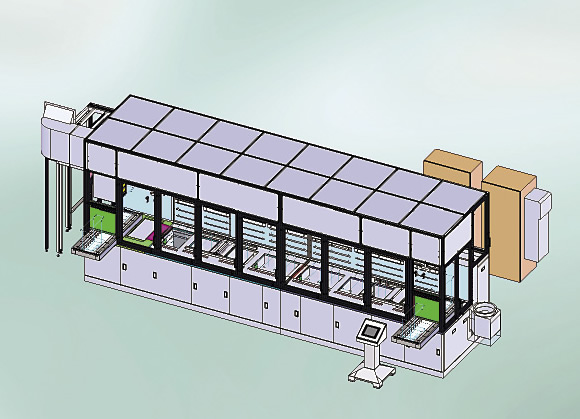

An automated precision cleaning and passivating line with system enclosure.
In an automated precision cleaning line, all of these features are controlled by programmable automation. The automation also advances each process load through each step in the program selected for that load. Most systems come with multiple automated programs. It is possible to vary the stations that a particular program includes, as well as station dwell times. Programs may be modified on the shop floor using password-protected screens. There may also be a telephone dial-in feature to make modifications or troubleshoot problems as needed.

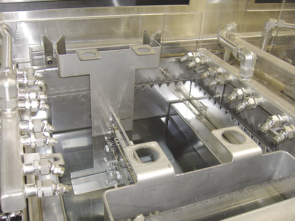

An ultrasonic cleaning tank configuration with spray-off capability and a four-sided weir is common when cleaning medical parts.
Precision rinse tanks are typically heated and may be filtered to a process-appropriate micron level, particularly in later-stage manufacturing operations, clean room applications or whenever part geometries or cleanliness standards warrant. Some precision rinse tanks may be equipped with ultrasonics, agitation or other mechanical actions, depending on part complexity.

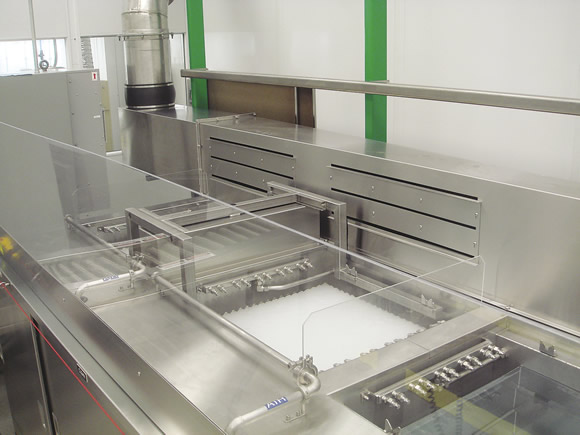

The cleaning end of a precision cleaning and passivating line for medical devices.

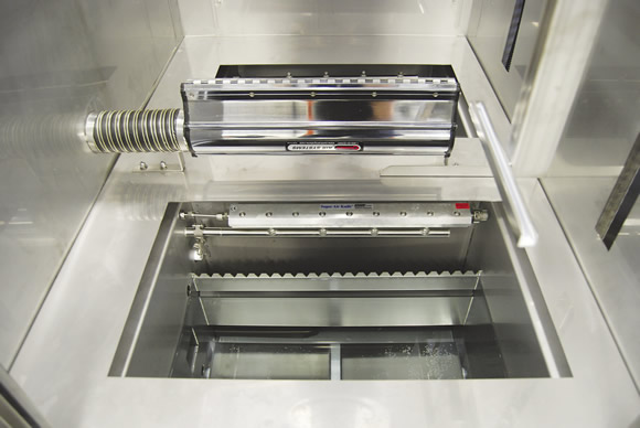

Interior work zone of a small-footprint, precision cleaning system featuring ultrasonic cleaning, ultrasonic rinsing and air blow-off.
Ultrasonic parts cleaning systems can be quite large, but they don’t have to be. A new breed of ultrasonic machine delivers a more cellular approach in a smaller footprint. This type of system features precision ultrasonic cleaning and rinsing and high-powered air blow-off in a fully enclosed unit, such as Miraclean’s SonicCell Cube, which measures 72 “×60 “. The operation is controlled by a programmable logic control and critical process data can be captured and electronically stored or printed, as with larger systems. This type of system may be a good starting point for many manufacturers implementing precision cleaning because of its small size and lower cost.
