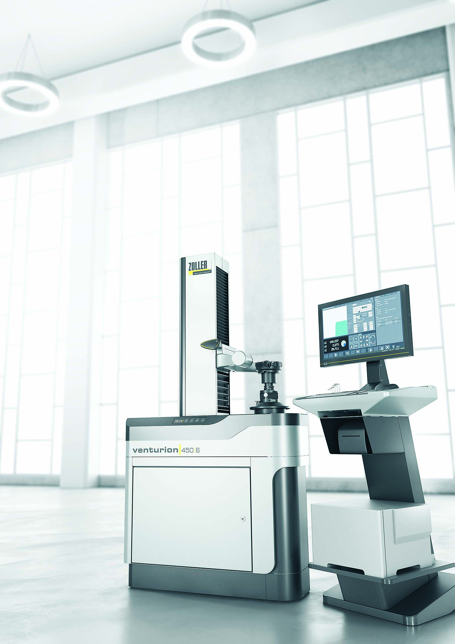

The venturion 450 presetting and measuring machine is billed as a good choice for Industry 4.0 manufacturing systems.
The venturion 450 presetting and measuring machine is billed as a good choice for Industry 4.0 manufacturing systems. Image courtesy of Zoller
The impact of this reduction on machine downtime can be huge. If a tool presetter can increase a shop’s spindle utilization by 40%, for example, the result could be a doubling of the shop’s production capability without a major capital investment, said Michael Colyer, key accounts manager at Zoller Inc. in Ann Arbor, Michigan.
He pointed out that cost analyses done by Zoller for most of its presetters at shops that have five or more machine tools usually show a return on investment in less than half a year.
“With an ROI of less than six months and the ability to significantly increase your business and the amount of throughput, in my mind (using a presetter) is a no-brainer,” Colyer said.
