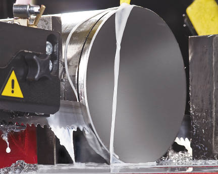

Courtesy of L.S. Starrett
Proper coolant mixture and flow maximizes bandsaw blade life.
Preventive maintenance is paramount for a bandsaw
Similar to other sawing methods, when preventive maintenance for a bandsaw is at an optimal level, sawing and blade performance tend to consistently mirror a similar high level. Presented here is a 15-point checklist that covers the gamut of practical machine care. • Condition and adjustment of band guides. If the guides are worn or loose, the result will be misaligned cuts and blade failure. Properly adjust the guides to the machine manufacturer’s recommendations and repair or replace them if needed.
• Band wheel and bearing conditions. Worn flanges and out-of-round wheels can cause blade stress, which in turn creates blade failure and poor cuts. Contact the machine manufacturer for service and replacement guidelines.
• Blade tension. Low tension speeds blade wear, while excessive tension not only can cause blade failure but can also damage the machine. Always tension the blade according to the manufacturer’s specifications.
• Blade alignment. Improper blade alignment to the vise or bed leads to blade fatigue and out-of-spec, crooked cuts. Square and adjust the blade to align it with the machine.
• Feed and speed calibration. Once the blade is properly guided, it is imperative that the feed and speed of the blade and saw are calculated to the manufacturer’s recommendations. This optimizes blade and—ultimately—machine performance.
• Hydraulic and transmission oil level. Proper levels ensure consistent feed rates and longer machine life. Fill to the proper level with the manufacturer’s recommended oils.
• Coolant quality, condition and flow. Proper coolant mixture and flow extend blade life and improves productivity.
• Belts and drives. Loose or worn drive belts can slip or break, resulting in reduced blade performance and loss of production. Be sure to tighten drive belts properly and check for wear.
• Guide arms in proper position and secured. Loose or improper guide arm position can result in misaligned cuts, increased guide wear and reduced blade life. Adjust the guide arms as close as possible to the material being cut.
• Calibrate work height and slow approach controls. Proper operation increases production and blade life. Inaccurate calibration can lead to blade damage and possibly injure the operator. Consult the machine recommendations or obtain the proper settings from the manufacturer.
• Lubrication. Use lubrication to ensure longer machine life and reduce downtime for repairs.
• Safety switches. They must be working properly to ensure operator safety and prevent possible damage to the machine.
• Sufficient vise holding. Parts must be held securely to prevent vibration and movement.
• Blade tracking and proper rotation. Improper blade tracking can shorten blade life. Rotation should be checked to make sure the blade is running in the proper direction, and adjust band wheels for proper blade tracking.
• Blade and wheel brushes. Brushes help remove chips from the blade to prevent them from re-entering the cut. Missing, worn or improperly adjusted brushes reduce blade performance and should be replaced or repaired as needed. —The L.S. Starrett Co.
