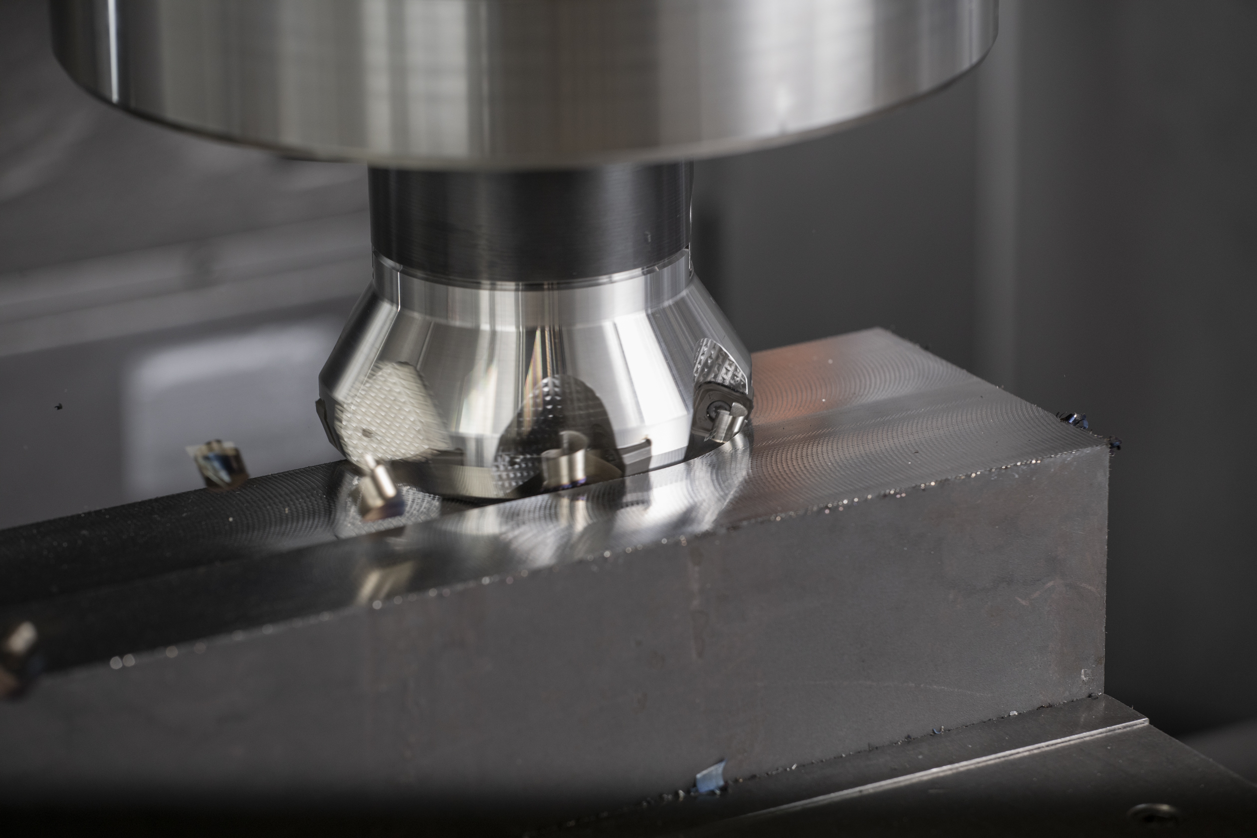

Shops with low-horsepower machines can enhance their facemilling operations with the Double Quattromill 14 facemilling cutter from Seco Tools LLC. Image courtesy of Seco Tools
