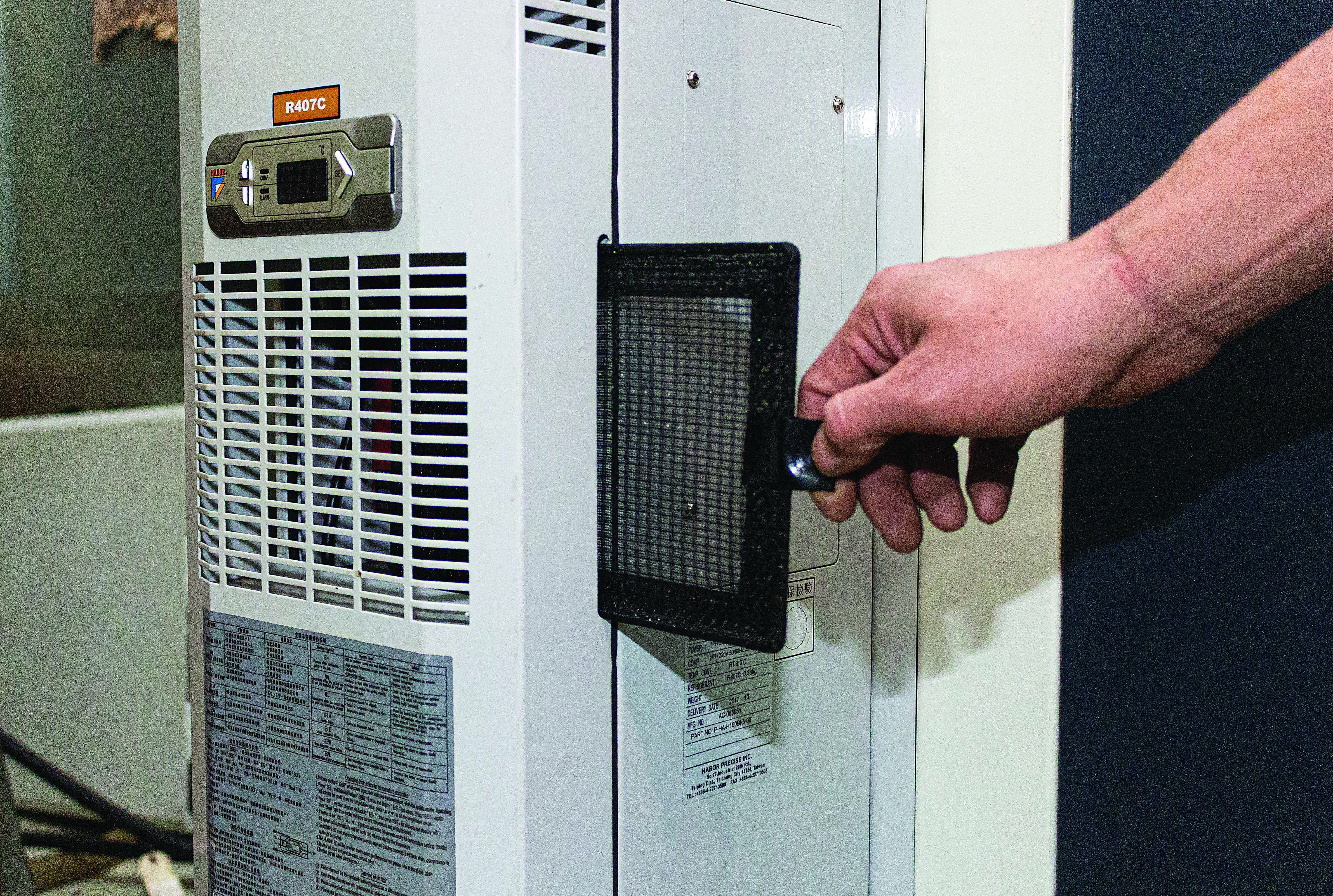

Changing filters is a minor task that can be critical to optimal machine operation. Image courtesy of Absolute Machine Tools

“Electrical components in cabinets should remain under 55° C (131° F),” he said. “If a $10 fan isn’t working, a capacitor can overheat, and the controller can burn out. And the CNC costs $15,000 to replace.”

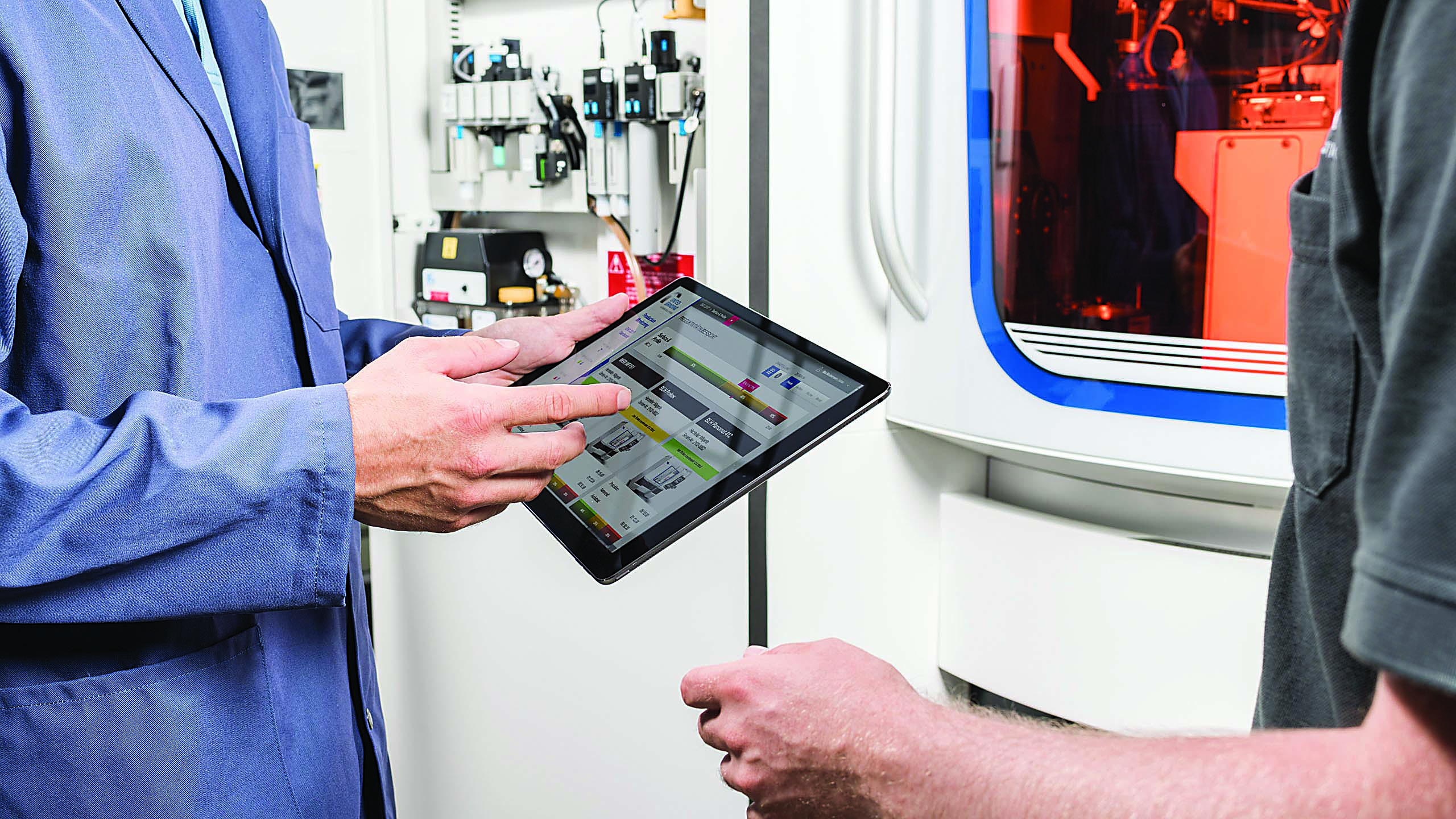

When a maintenance team always can view the latest conditions of machines, unplanned downtime is reduced. Image courtesy of United Grinding North America
