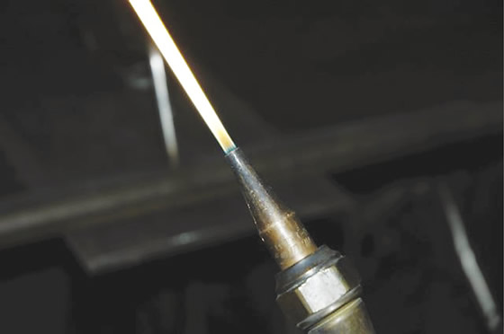

Open the fuel valve until there is a separation between the base of the pure fuel flame and the tip (left), then slowly close the fuel valve until the base of the flame reconnects with the torch tip (right). All images courtesy T. Lipton.

When flame straightening, always use the correct flow and fuel-and-oxygen pressure for the tip size. There is some confusion as to how far to open the fuel valve when setting a flame for a particular size. The best approach is to open the fuel valve and light the torch in the normal manner with the correct regulator pressure settings for the tip size you are using. After you have it lit, open the fuel valve until there is a separation between the base of the pure fuel flame and the tip. Slowly close the fuel valve until the base of the flame just reconnects with the torch tip. This is the correct amount of fuel for the tip. More than this and the flame will be hard and forceful; less and you are not heating efficiently.

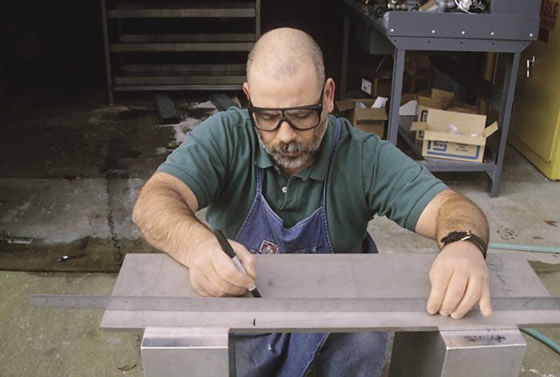

The first step is to do a quick check with the straightedge along both axes of the plate to find the worst side—the one with the most severe and largest number of high spots.
For correcting plates, I like to set the plate on horses or blocks on the table. Support the plate on three points so it doesn’t rock. The best place to do this is outside the shop on the forks of a forklift with a water hose nearby. The older I get, the less I like to bend down; there is a sweet spot where you don’t have to bend too far to sight the gap between the straightedge and the plate is not too high to reach across.
To locate the high spots, use your longest straightedge first. Hopefully, it spans the entire plate width. If the straightedge is not long enough, a piece of flat bar will work. Before you begin, decide how flat you are going to make the plate. It’s pretty easy to change your standards as you work and end up doing more work than necessary.

Start plotting in the direction of the worst distortion. Move the straightedge perpendicular to the edge of the plate. If the plate is round or oddly shaped, pick a direction and stick with it for the entire straightening job. As you compare the straightedge to the plate, place your eye at the same level as the gap between the plate and straightedge. This makes it easier to see the gap.

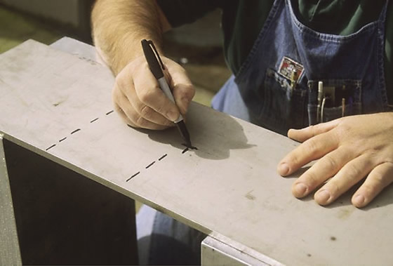

Move the straightedge along the plate. As you find the high spots, use a Sharpie to mark them in approximately 2 ” increments as you move along the plate. When you find a high spot, rock the straightedge back and forth to locate the apex. The rocking see-saw motion will show exactly where the apex is. Mark these apexes as you move along the plate. If there are two high spots, or the high spot is broad, mark the points where change is greatest.

As you make your marks along the plate, use light or heavy dashes to remind you of the approximate amount of distortion. A light dash indicates a minor variation, while a heavy dash indicates a large distortion that requires a full correction. When mapping the distortion, you’ll find it often fades and ends abruptly. Mark the end point to remind yourself to stop straightening at that point. Typically, there will be several wandering dashed lines, some ending and some running the full length or width of the plate.
