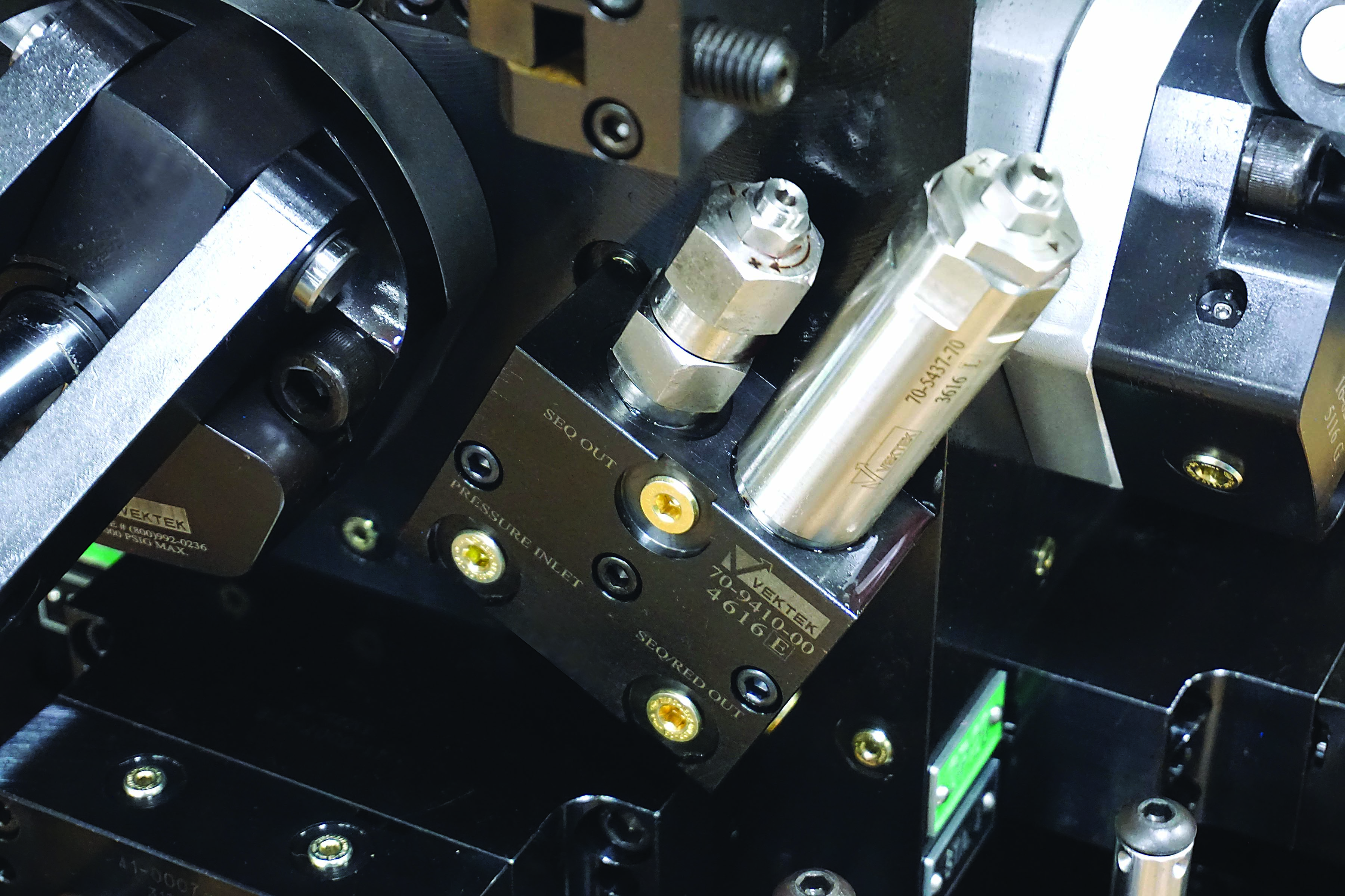

The Combination Sequence/PRV Block lets users control both timing and pressure on fixtures.
The Combination Sequence/PRV Block lets users control both timing and pressure on fixtures. Image courtesy of Vektek

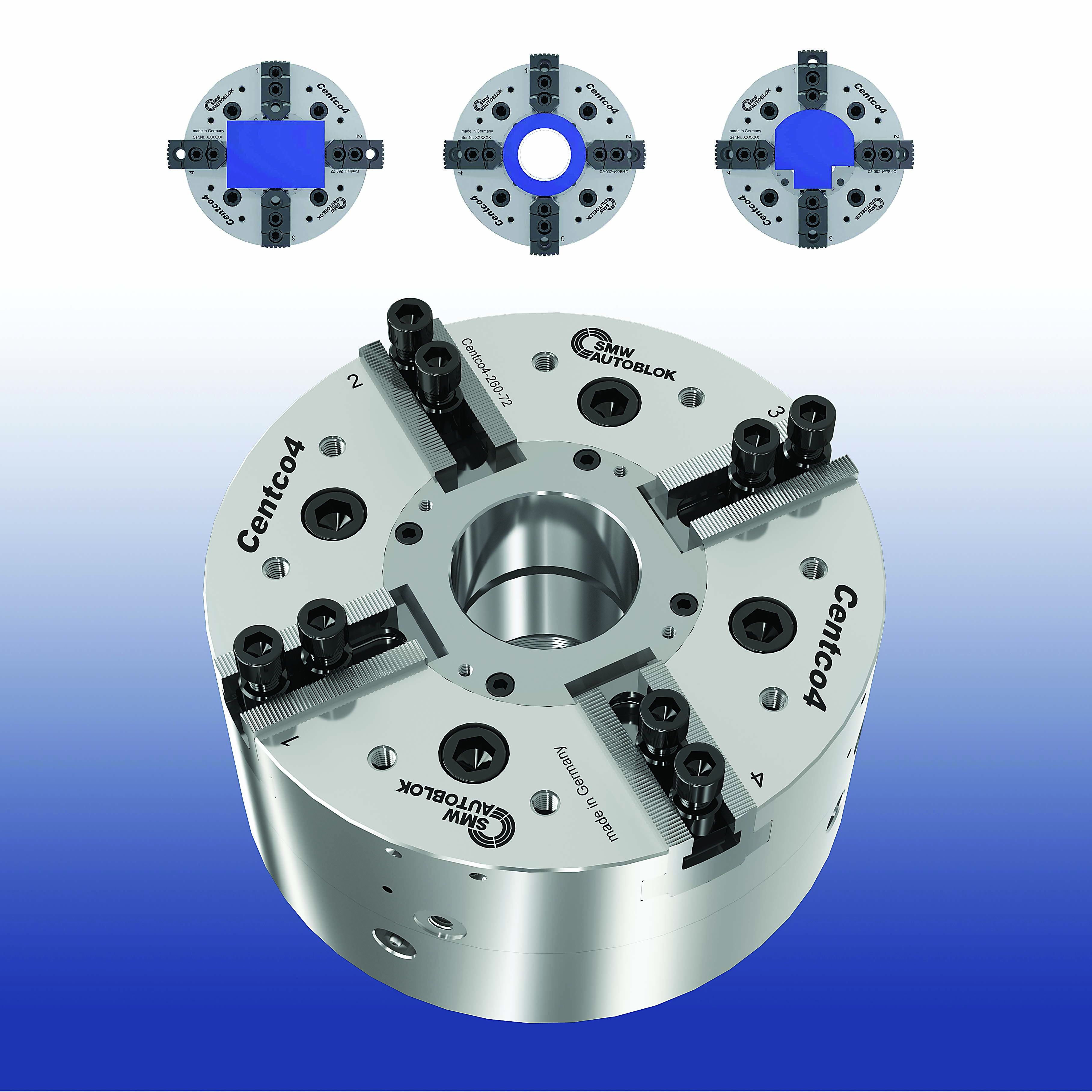

The Centco4 (2+2) self-centering and compensating chuck is designed to clamp any workpiece geometry.
The Centco4 (2+2) self-centering and compensating chuck is designed to clamp any workpiece geometry. Image courtesy of Vektek

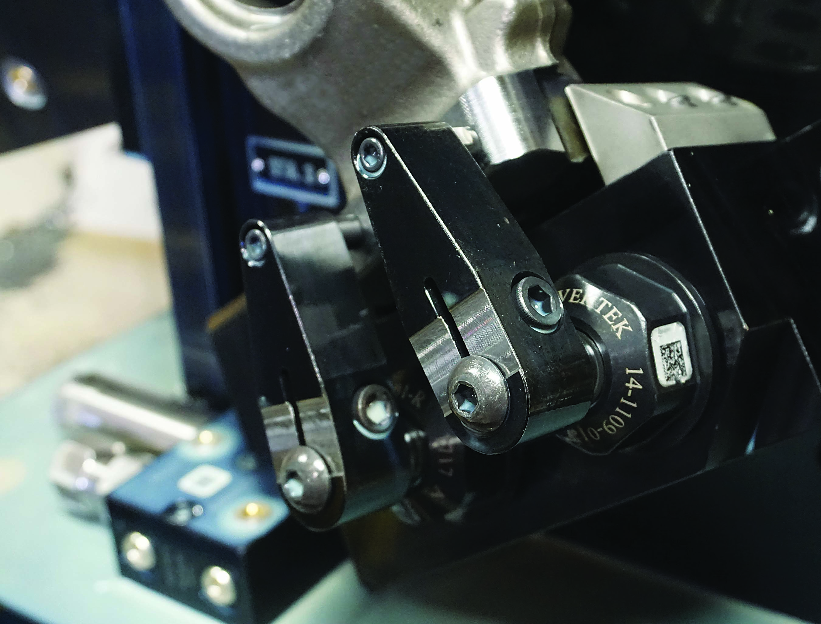

VersaCam swing clamps offer hardened V-cam tracks that resist damage and provide a built-in extra cam.
VersaCam swing clamps offer hardened V-cam tracks that resist damage and provide a built-in extra cam. Image courtesy of Vektek
