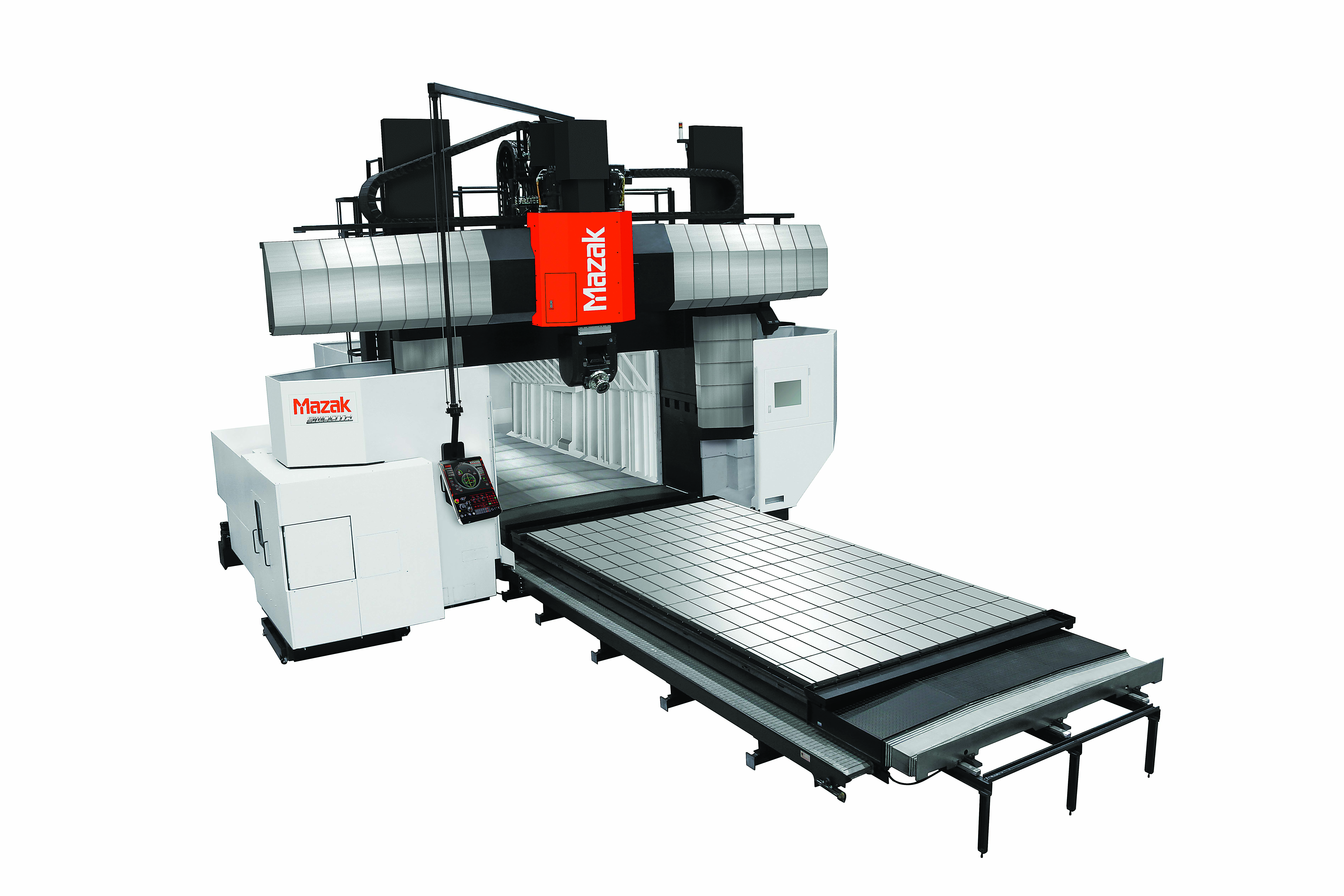

The Mazak Versatech V-140N 5-axis double-column machining center is for machining large workpieces thanks to its spindle head that can position to the vertical and horizontal positions and any angle in between. Image courtesy of Mazak

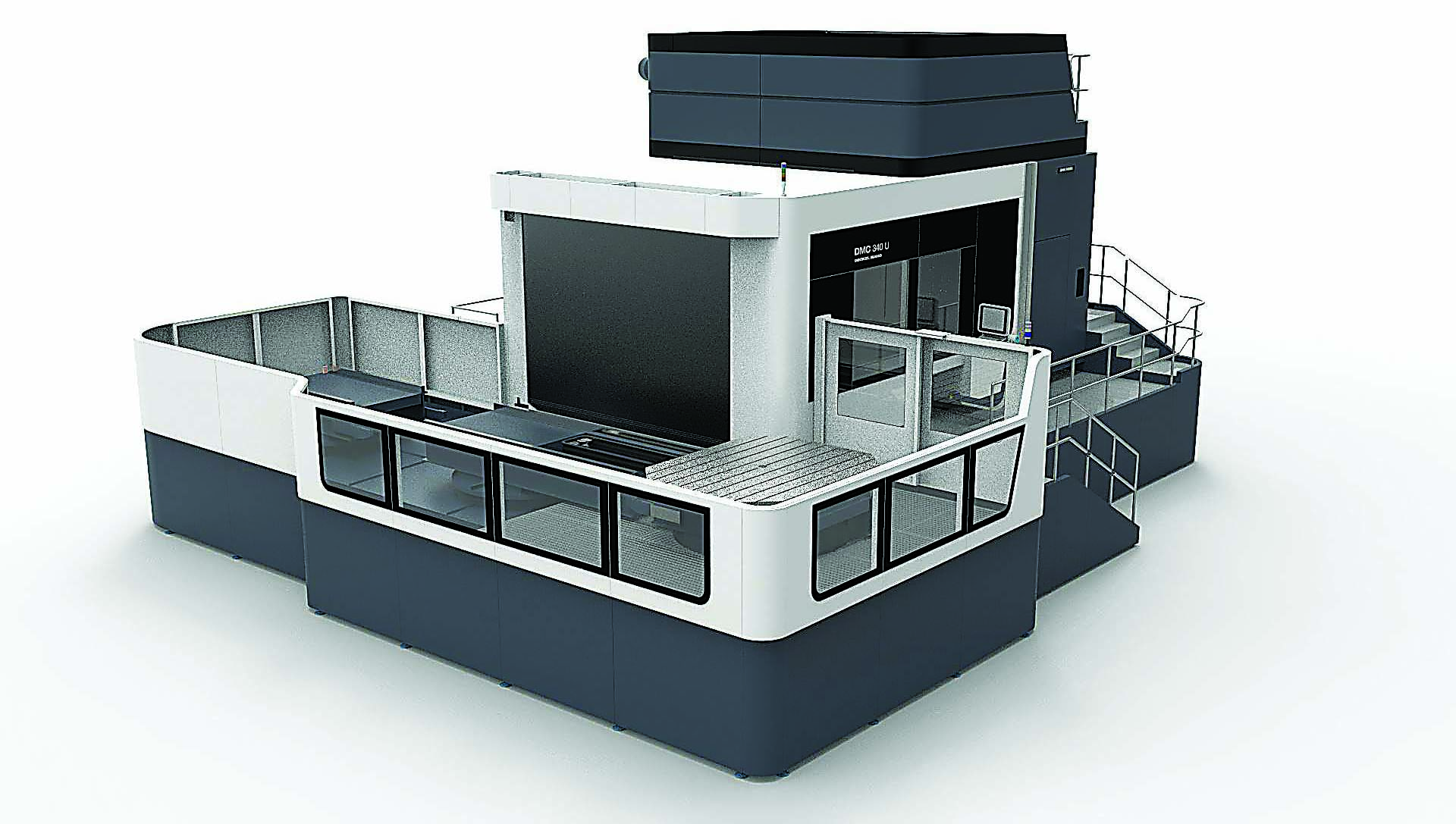

DMG Mori’s 340 U 5-axis portal-style machining center boasts a table capacity of 22,000 lbs., sufficient for many machine tool components. Image courtesy of DMG Mori USA
“We use all our own machine tools to produce our machine tools,” said Ben Schawe, vice president of manufacturing. “There’s really nothing special about these machines, meaning that they are all standard products for us. For example, we machine the base of our machines on a Mazak V140 bridge mill equipped with a 5-axis head. This allows us to machine every contour on that part in one setup, which greatly reduces the accuracy loss associated with multiple setups.” That said, this is the same machine tool technology the company sells to all its vendors, distributors and customers, Schawe noted.
