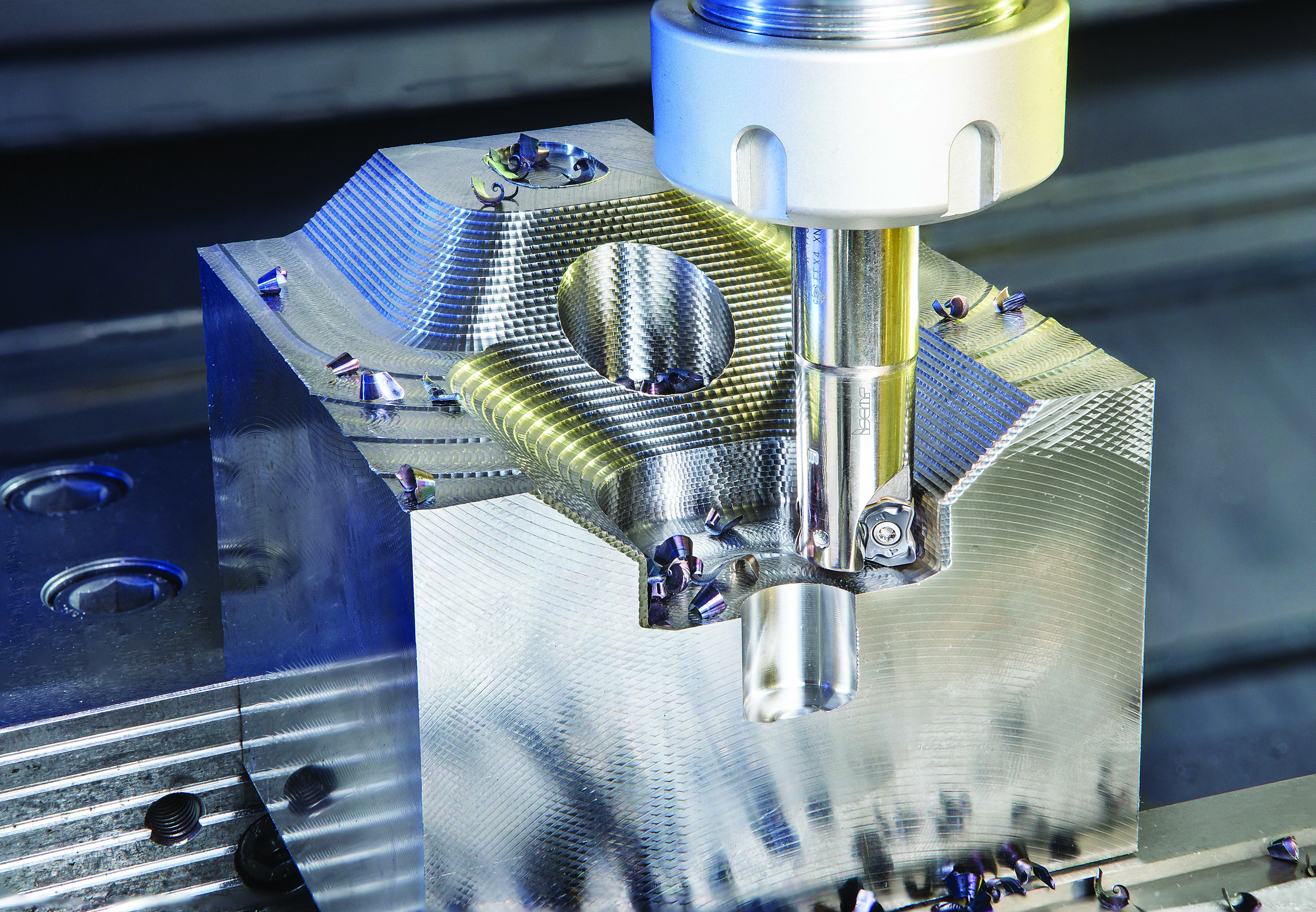

FFX4 ED endmills carry small, double-sided, “bone-shaped” inserts with four cutting edges for fast feed milling.
FFX4 ED endmills carry small, double-sided, “bone-shaped” inserts with four cutting edges for fast feed milling. Image courtesy of Iscar USA
Studies by YG-1 Tool (USA) showed that end users either used only one side of a double-sided, high-feed insert or accepted that they would obtain only 60% to 80% of the tool life for the second side compared with the first side when they used both sides, Andersson said.
“Making a thicker insert allowed us to accept that flank wear but without having the encroachment issue,” he said. “This means four true cutting edges.”

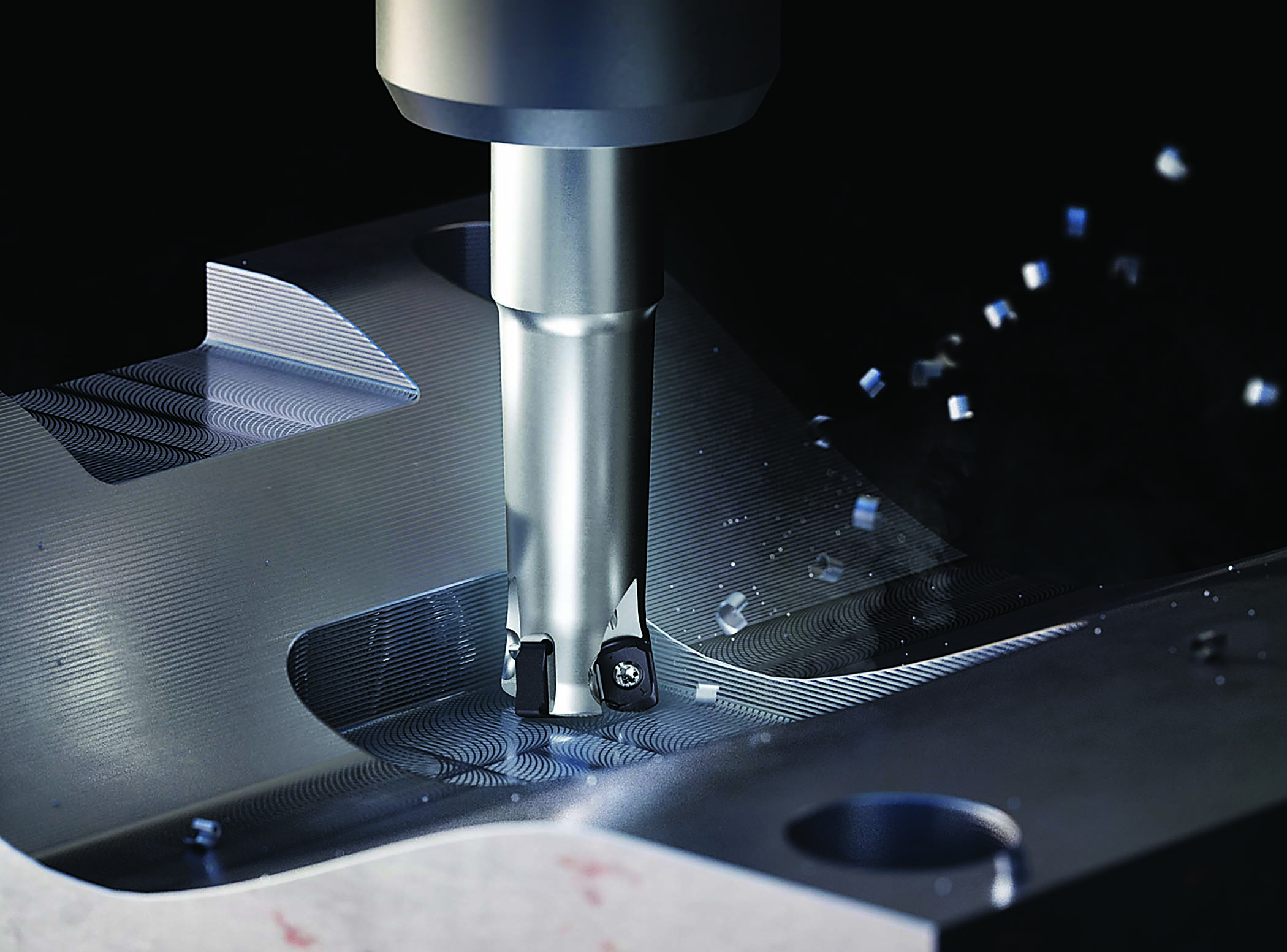

High-feed indexable insert milling tools are also widely available to up throughput. Andersson said this started several decades ago with round inserts, which have a continuously variable lead angle, depending on the DOC in relation to the radius.
High Feed Square Cut milling cutters pair a shallow DOC with a high feed per tooth to achieve high metal removal rates.
High Feed Square Cut milling cutters pair a shallow DOC with a high feed per tooth to achieve high metal removal rates. Image courtesy of Seco Tools
