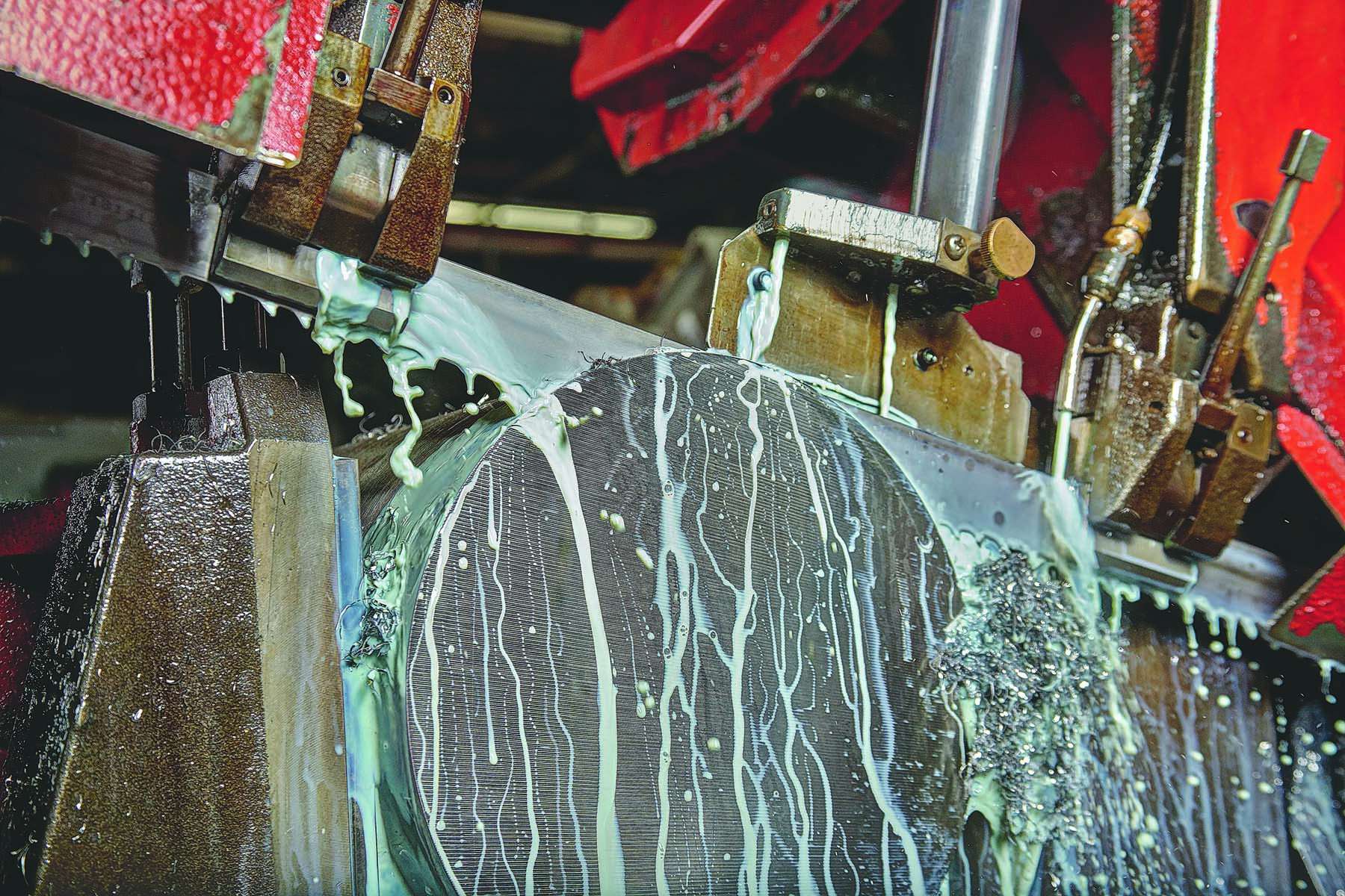

Because an extensive amount of heat is generally generated when sawing difficult-to-machine metals, it’s important to apply an ample amount of coolant, according to Fernandes. He recommends a water-soluble oil because having an oil in the mix limits the heat.
Besides being able to cool the saw/workpiece interface, the metalworking fluid must provide lubricity for effective chip evacuation, Gordon said. “While an argument can be made for using straight cutting oil, with the advent of soluble oils, semisynthetic and full synthetic cutting fluids, this is typically the least attractive option. The key is a high-quality cutting fluid mixed appropriately for the application that both lubricates and cools.”
The challenges of sawing new alloys

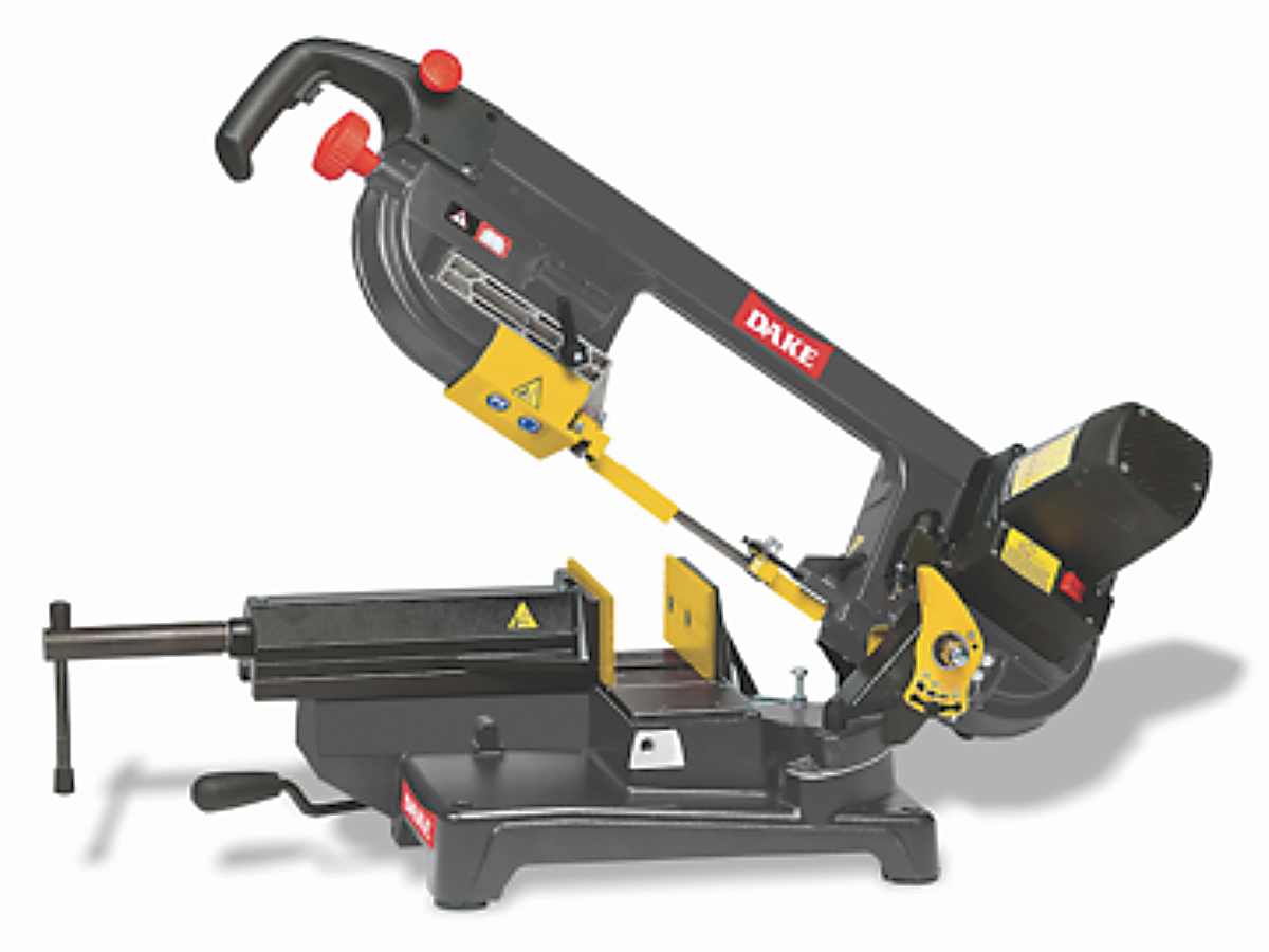

The SE 5X6 RCT benchtop horizontal bandsaw from Dake features a semiautomatic 2.5-hp motor, gravity down feed and reverse cutting technology. Image courtesy of Dake
Rice emphasized steering clear of oil and selecting a water-soluble coolant instead because it’s significantly cleaner and users should “flood it as much as you can.”
It’s essential not only to apply the right coolant but to do so at the proper concentration as well, as long as the concentration is within a suitable range. “You could always make the concentration a little heavier,” Rice said, “and instead of having to mix in more coolant when it evaporates, you just add a little water, and you still have the lubricity you need.”
However, if flood coolant isn’t an option, spraying a fine mist of vegetable oil on the blade gets the job done when the application is appropriate, he said.

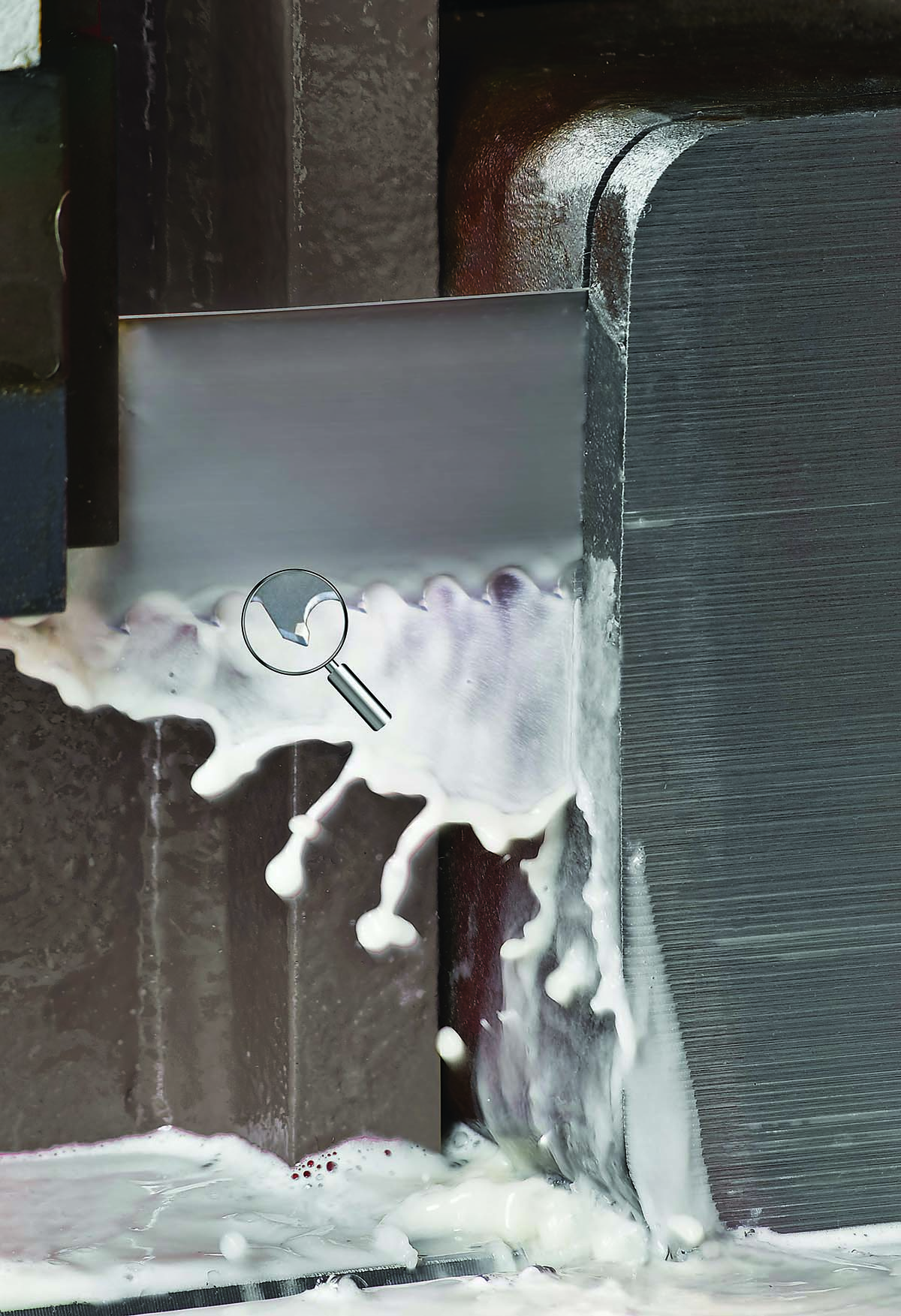

However, a chip brush plays a critical role, according to Rice. If a chip is packed into a gullet, it can become welded to the blade. “Then you have a mess trying to clean it out.”

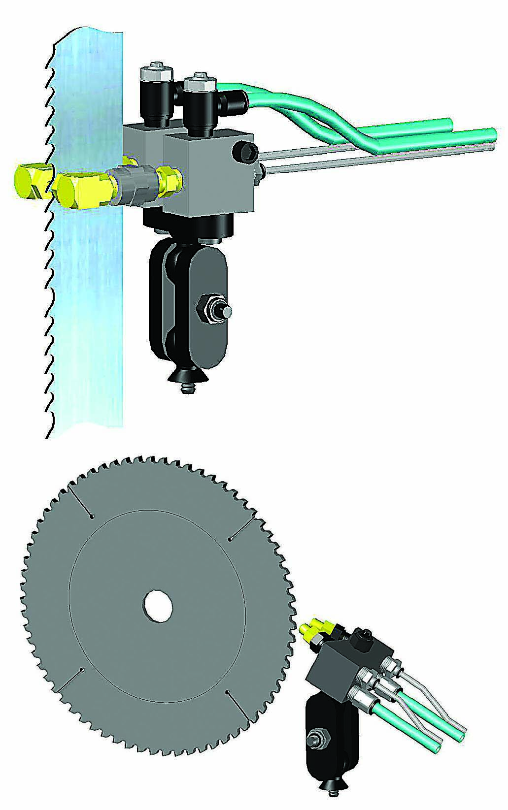

With the Wet Tip, AMCOL’s MQL spray systems mix the liquid and air at the end of the tip, Dyla said. As a result, a high-velocity round spray propels the liquid onto the saw blade rather than creating a less-effective mist or fog. “A mist, as you can picture, doesn’t have velocity.”
When applying MQL, spray manifolds ensure the appropriate spray angles relative to the cutting edge, Dyla noted. Specialized mounting brackets are available to aid in blade changing and spray manifold maintenance and repair.
According to Dyla, the company’s MQL systems are unique because they use an air pressure regulator rather than a needle valve to regulate spray pressure at the tip. “You are able to gage, theoretically, what the flow is at the tip,” he said about the design. “This gives you the ability to make an adjustment utilizing a gage rather than a guess.”
Because users of MQL systems sometimes tend to feel that more coolant is somehow better, AMCOL offers Smart Metering.
“The Smart Metering concept takes away the ability of the operator to adjust this equipment,” Dyla said. “Instead, it goes with settings that are known and accepted to work in these applications. If you overuse the fluids, you can have smoking, oily parts and problems with washability. It’s just costing more for fluids.”
