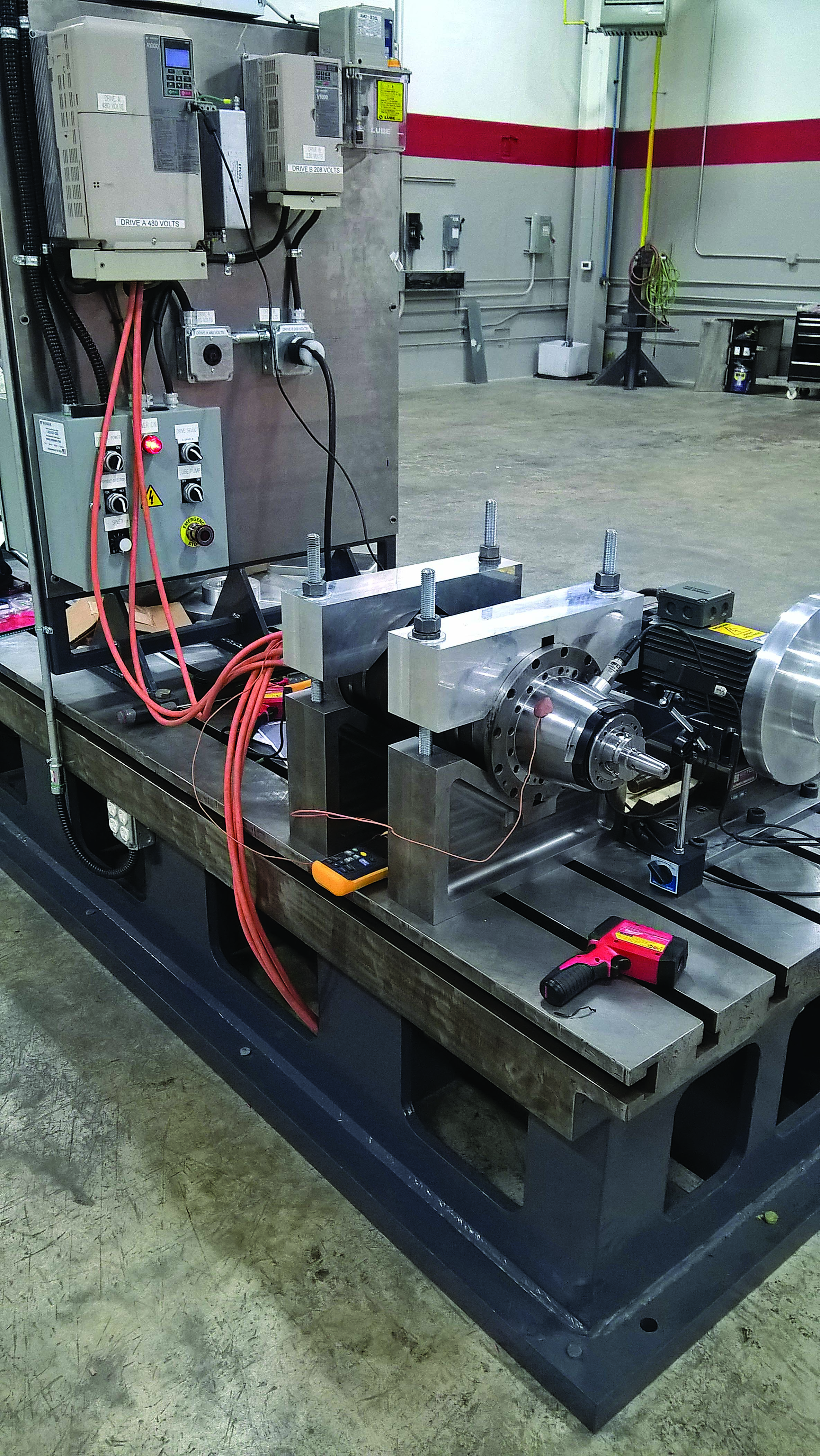

Final runoff is performed on a test stand for a high-speed Kessler spindle. Image courtesy of Advanced Spindle Technology

After a spindle is reassembled, test bar runouts should be measured and documented. Drawbar pull forces should be set and documented, and any sensors or encoders used should be tested.
The final assembly performance characteristics should be documented during a complete runoff. Documentation should include the spindle’s steady-state operating temperatures, details of the bearings used in the repair and running vibration and balance characteristics. The vibration spectra at each end of the spindle also provide valuable information, which can be used as the baseline for a predictive maintenance program.
