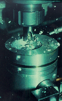

Machining Recommendations
In general, when machining aluminum that has a silicon content that exceeds 16 percent, use a PCD tool made from a coarse-size grain. Run the tool at a high feed rate and a lower spindle speed, especially when milling or performing other operations that involve interrupted cuts. For general-purpose applications, where the percentage of silicon content in the material is less than 16 percent, utilize a medium-size grain. And when a good surface finish is required, a fine-grain structure is desirable.
Flood coolant will aid in clearing chips and remove heat from the cutting edge and workpiece. But the use of a high-pressure coolant-delivery system offers considerable advantages, particularly when drilling.
The buildup of material on the tool’s cutting edge is a constant problem. This is due, in part, to the microscopic erosion that takes place during the cutting cycle. While this cannot be eliminated, it can be significantly reduced.
Following are some tips for specific operations.

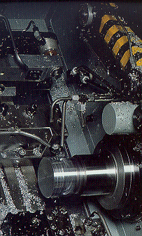

Turning, Milling. Roughing cuts made in high-silicon aluminum with PCD tools should be done at the maximum practical feed rate and DOC.
When machining high-silicon aluminum, it’s important that the machine tool used be equipped with high-quality spindles and axes drives, and that the tools are mounted in rigid toolholders.
If surface finish is not a consideration, good starting points for turning are a 1,700-sfm cutting speed and a 0.015-ipr feed at a 0.060" DOC. For milling with a 4"-dia., 5-tooth, 45° lead-angle facemill, for example, start at 1,700 sfm (1,600 rpm), a 0.075-ipr feed, which calculates out as a 0.015-ipt chip load, and a 0.060" DOC.
The total DOC should not exceed 60 percent of the tool tip’s length, as measured from the nose back. Exceeding 60 percent of the length can cause catastrophic failure of the brazing that secures the tip to the carbide insert.
As the DOC is increased, the cutting speed should decrease. For example, the draft angles of a casting increase during the cut, so periodic speed adjustments need to be made. An alternative is to simply preset the surface-speed adjustment to the largest DOC. Be careful, though, if you try to use a constant surface footage to make a facing cut. Material that is removed along the draft angle of the casting will often build up as you approach the workpiece’s centerline.
Interrupted cuts, when either milling or turning, usually require a decrease in feed.
Finish settings depend upon the required radii and the specified microfinish. A good starting point for a 1/32-radius tool is 2,000 to 2,500 sfm, with a feed rate of 0.005 ipr. Personal experience has shown that the feed rate should not exceed one half the tool’s nose radius. For this reason, when determining your process requirements, use the largest radius possible that will not cause vibration. Rake and clearance angles on tools designed for high-silicon aluminum will normally be the same as for other forms of aluminum.
