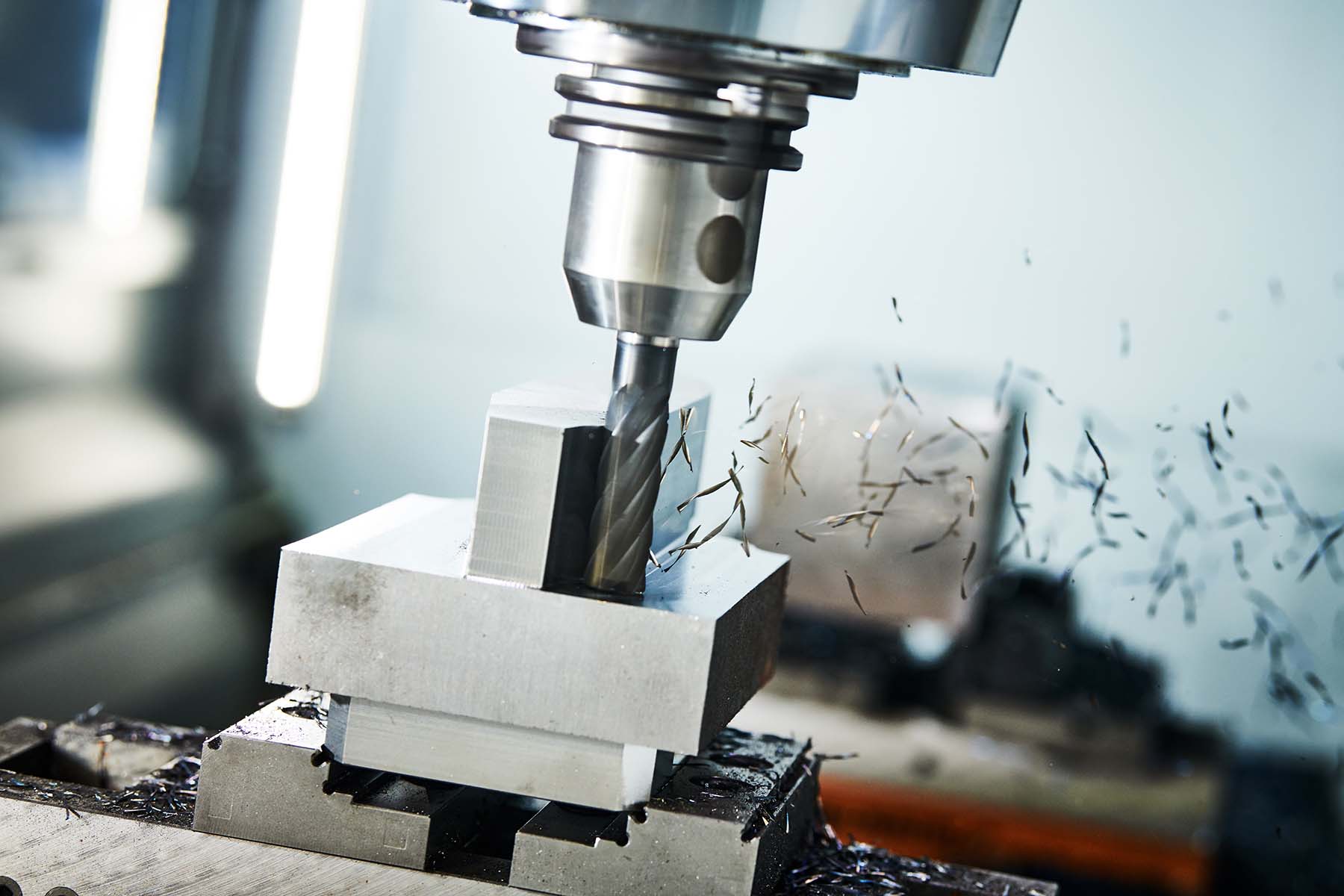

VMCs, as the name implies, have the spindle in a vertical orientation with a table for the workpiece that is parallel to the floor. HMCs have spindles oriented parallel to the floor with the table also parallel to the floor, which orients the parts perpendicular to the floor. Choosing the better orientation for machining depends on several factors.

Making a lot of parts also means making a lot of chips. Because parts are held perpendicular to the floor, the chips made on an HMC naturally fall away from the work due to gravity. Chips on a VMC have no place to go, so they must be removed with air, coolant or other methods. If you are going to drill deep holes or mill pockets in parts, an HMC reduces the headaches associated with chip interference.
